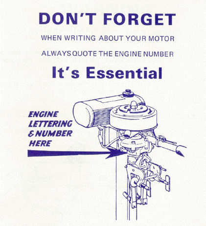

It is very important to quote the engine number when ordering spares or making enquires about your engine. To identify your motor, Click here to go to the Seagull Engine Numbers page and search the lists for your I.D. letters, these are the first set of letters in the sequence. i.e. 'AD' That will give you the type of British Seagull, (102 direct drive), the number in some early cases will give you a rough guide to the year. Note the numbers ran through several different models that were being built at the same time. After 1963 there was a letter and number at the end of the sequence to denote month and year A = January 3 = 1963. In 1973 the codes continued with double letters, i.e. AA 3= January 1973.

To trace your engine number, click the here or the "Don't Forget" picture at the very bottom of this page for an explanation and a list of engine numbers by model.

Click box below to seethe model identification numbers.
