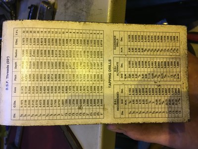

Re: Is the thread pattern on the shaft bolt special?
Captain Dave
- Posts: 11
- Joined: Mon Jun 10, 2013 7:19 pm
- Location: California, USA
OK, that makes my head spin. I found a UK source for hardware, and when I get time, I will search for a U.S. supplier. I have an old time marine supply store in San Diego that just might have what I need.
