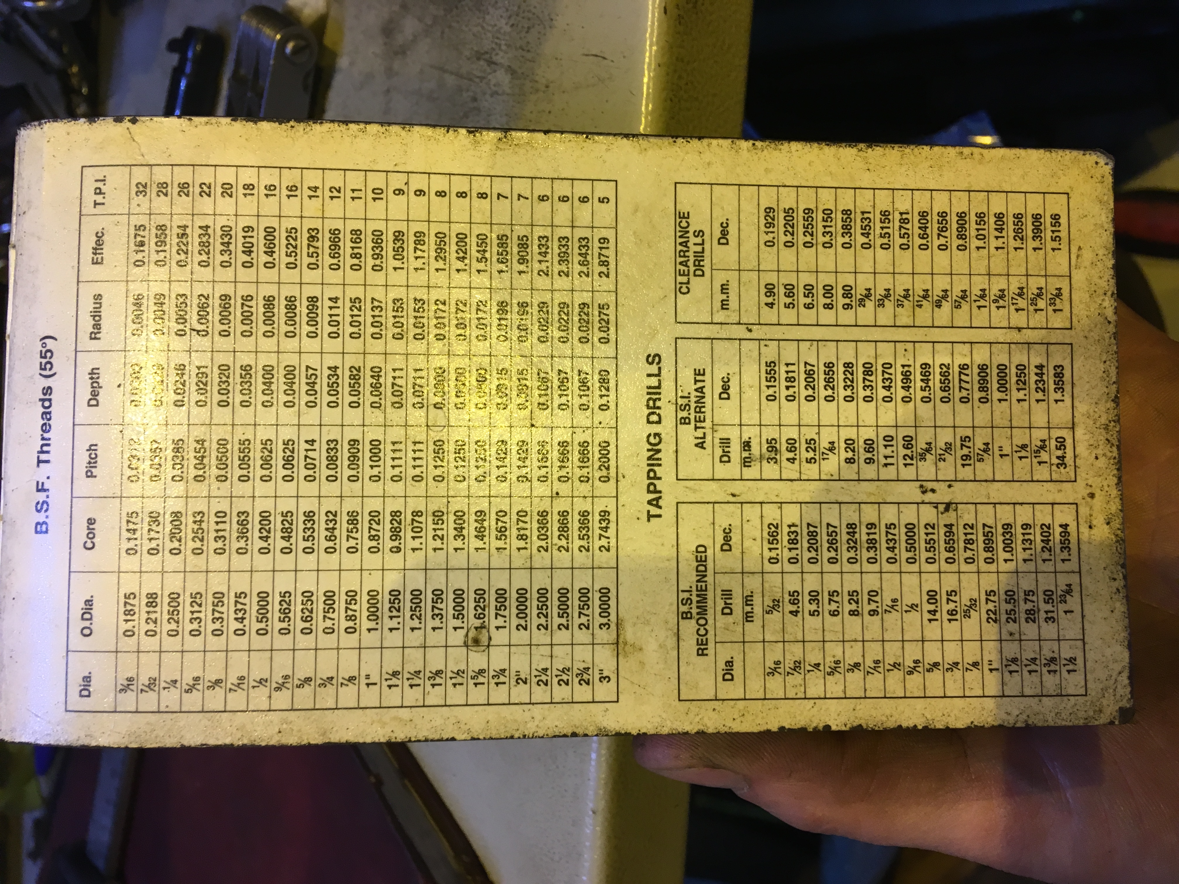

Re: Is the thread pattern on the shaft bolt special?
Post by Liam2k3 »
7/16 -18 bsf ithink
Post by Captain Dave »
OK, that makes my head spin. I found a UK source for hardware, and when I get time, I will search for a U.S. supplier. I have an old time marine supply store in San Diego that just might have what I need.
