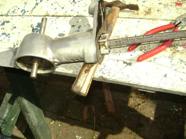

Perhaps a bad decision . Every nut and bolt down below is utterly knackered or has been replaced at some stage by some mechanic from hell.
I tried all ways to open the lower leg , gearbox etc and finally got there but not without doing irreparable damage.
I have some spare forty bottom driveshafts and gearbox bits etc so I wasn't too worried.
Then it got real messy. I am not a mechanic and then my gas torch went kaput.
The impellor fell out in 4 pieces . I had an old ls forty driveshaft and part gearbox etc with the round inlet holes and attached aluminium impellor and some other bits to make up another gearbox with a 35/10 gearing. This old impellor has 4 fins attached and all info says that it should be ok.
Everything I picked up seemed to have a problem which I finally overcame this afternoon and using my homemade gaskets I reassembled the old girl . Not something I would sell but a very unique bottom ended forty which , if I can get going I will definitely use.

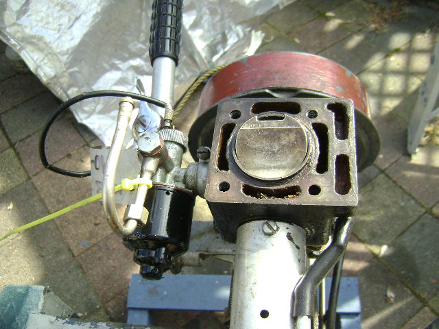

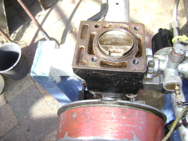

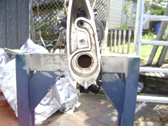

I;ve taken the head off, bottom leg gearbox etc and.,
1 only minor gunk n block , passed water cleaning through open block down brass tube and out in pumphousing . all ok there.
2 aluminium impeller is the correct size is on correct and in what seems to me to be in reasonable condition.
3 fully aware now to keep brass tube in special slot inside exhaust Had run it yesterday with the brass tube in then out of the slot to cover all bases.
4 have to wait for my new gas torch before I can reassemble head, hopefully by weekend. annealing.

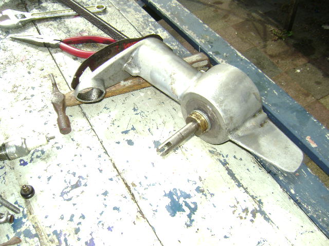

7 the gearbox. Have replaced the original fp box with most parts from a derelict LS incl shaft and gearing and other than some minor variations it seems to work .
Its also 35/10 as is the FP. I thought it would be different.This FP box had been jammed up very tight with foreign bolts and screws and eventually had to be drilled out.Bolt extractors did not work. The LS has a minor fault but I'm sure it will ok.
Perhaps some of you more professional types could have done far better but it was beyond my skill and especially my patience.

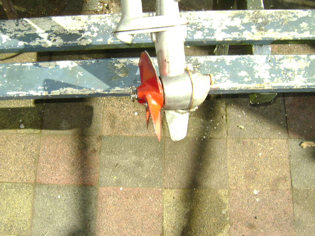

As in the photos this LS gearbox has differences like no cupping on the prop side .
Means of course less protection from weeds or other materials I suppose but I cant see why it cannot do the job.
My only doubt, and it does seem to run well when running is there is a space between the brass pinned washer on the gearbox driveshaft and the outer facing of the gearbox itself. Some variation here from the FP, either shaft length or gear box dimensions.
Either way I have place 2 washers in the space but there is still some movement maybe too much. I don't do micrometers so is there any way I can judge what is a reasonable gap.?

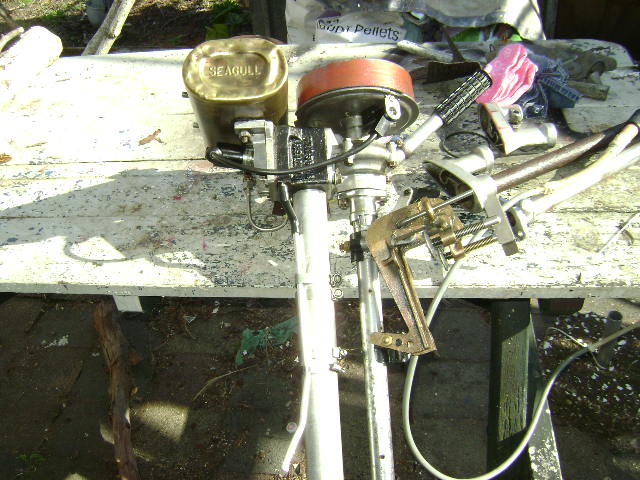

Hope I covered it all , may be not , but thanks and if anything screams out to you in my photos please let me know.

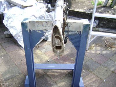

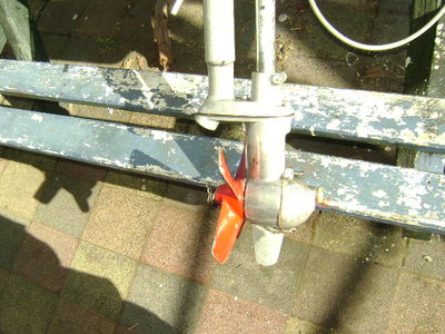

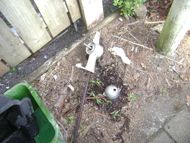

heres my missing photos.
Grumpy
Posts: 227
Location: Auckland
Re: forty water circulation no 2
Post by Grumpy »
I.m starting to get the hang about sending photos .H
eres a few more
