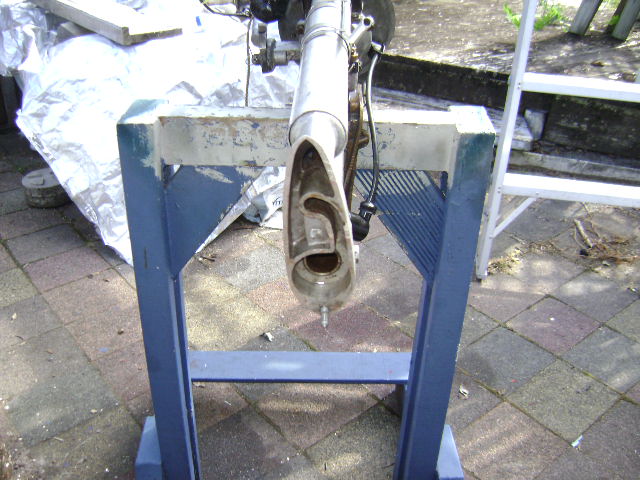

I;ve taken the head off, bottom leg gearbox etc and.,
1 only minor gunk n block , passed water cleaning through open block down brass tube and out in pumphousing . all ok there.
2 aluminium impeller is the correct size is on correct and in what seems to me to be in reasonable condition.
3 fully aware now to keep brass tube in special slot inside exhaust Had run it yesterday with the brass tube in then out of the slot to cover all bases.
4 have to wait for my new gas torch before I can reassemble head, hopefully by weekend. annealing.
5 Will ensure all gasket are correctly installed ensuring good seals.
6 If no luck will be trying that trick of running in tank with exhaust off but what happens to my filthy underwear and who will respond to my repeated appeals for food and drink at strange hours. If it is guaranteed that the missus shoots off I may need to reject that idea.
Nearly 50 of training down the gurgler.
7 the gearbox. Have replaced the original fp box with most parts from a derelict LS incl shaft and gearing and other than some minor variations it seems to work .
Its also 35/10 as is the FP. I thought it would be different.This FP box had been jammed up very tight with foreign bolts and screws and eventually had to be drilled out.Bolt extractors did not work. The LS has a minor fault but I'm sure it will ok.
Perhaps some of you more professional types could have done far better but it was beyond my skill and especially my patience.
As in the photos this LS gearbox has differences like no cupping on the prop side .
Means of course less protection from weeds or other materials I suppose but I cant see why it cannot do the job.
My only doubt, and it does seem to run well when running is there is a space between the brass pinned washer on the gearbox driveshaft and the outer facing of the gearbox itself. Some variation here from the FP, either shaft length or gear box dimensions.
Either way I have place 2 washers in the space but there is still some movement maybe too much. I don't do micrometers so is there any way I can judge what is a reasonable gap.?
Hope I covered it all , may be not , but thanks and if anything screams out to you in my photos please let me know.

heres my missing photos.
Grumpy
Posts: 227
Location: Auckland
Re: forty water circulation no 2
Post by Grumpy »
I.m starting to get the hang about sending photos .H
eres a few more
