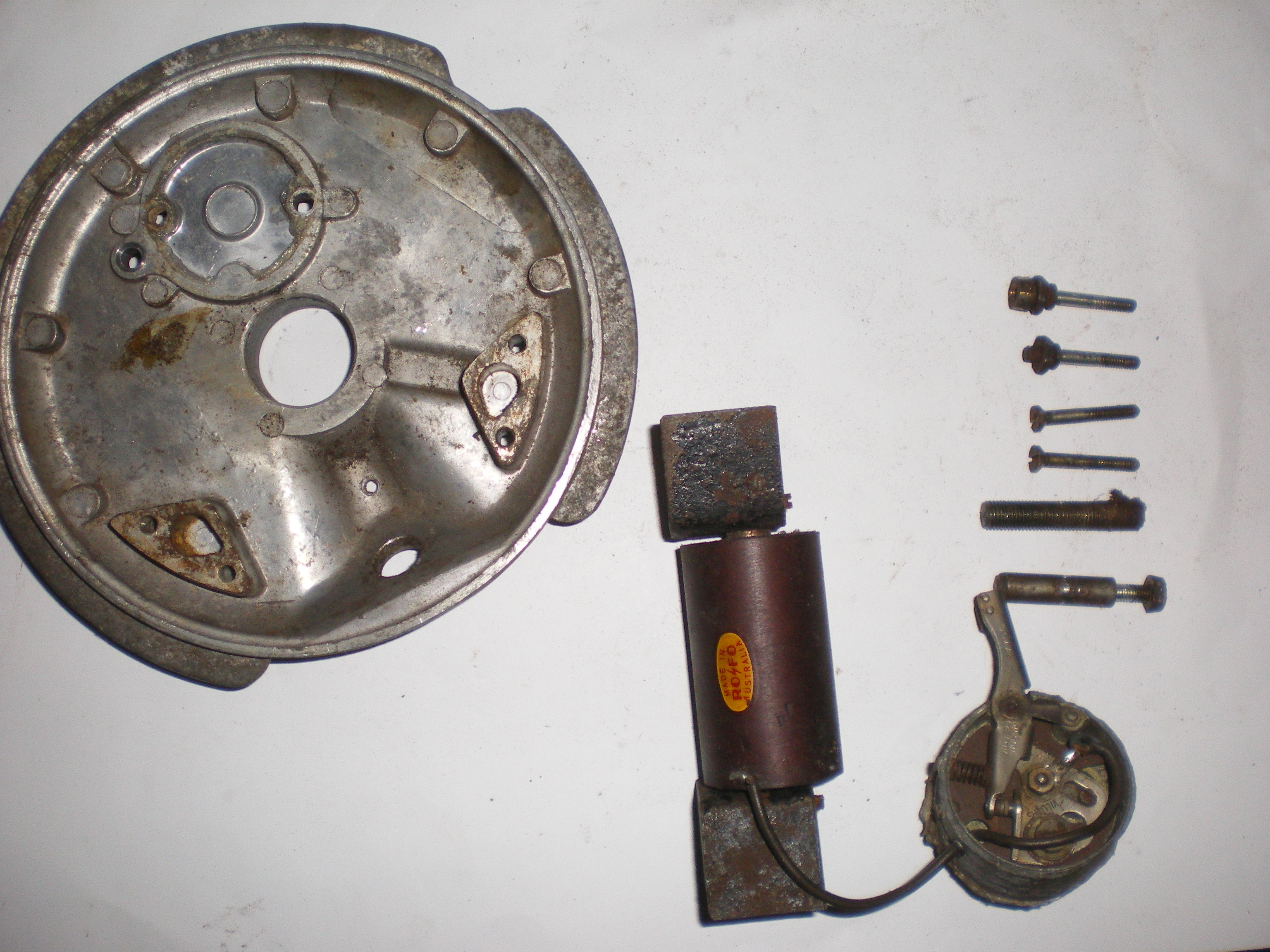

You inspired me to pull a plate apart. A good coil so I can modify it to fit a JM magnet. It is an Australian coil called Rofo.

If you are close to Lane Cove you can have the base plate if you wish to hit yours with an angle grinder. You will still need to find a locating stud though. I'm not into posting unfortunately.

Re: Putting up a real fight!!!
Here is a bolt I took off another motor. You can have that to get you out of trouble. Engineering shop is not acceptable :lol:
