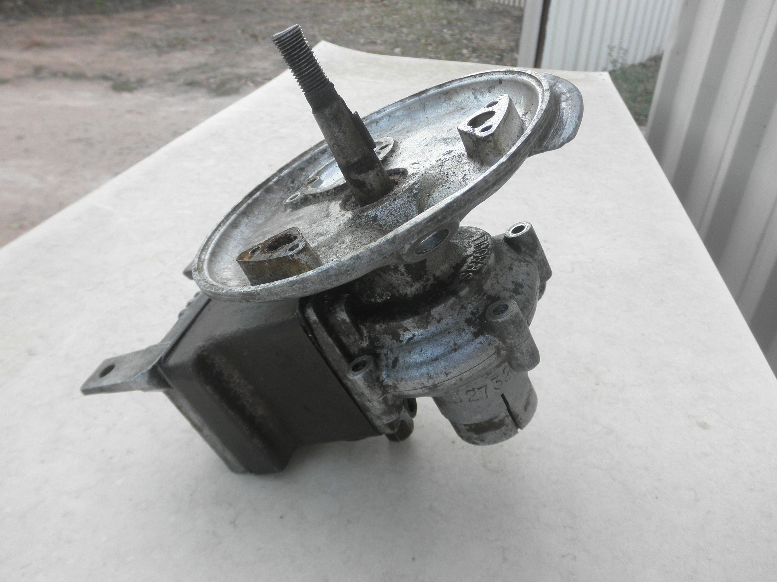

Success!!!!
The Loctite Red worked a real treat!
So I locked the nut onto the stud with Loctite Red and gave it a few days to really harden - went down there this afternoon and tried to back off the nut. Sure enough - the nut was locked to the stud and the stud came out with it.
Worked great!!!
And to my surprise - it was really easy to get the nut off the stud once it had been removed. Just a moderate amount of heat from my MAP Gas torch and it came off really easily - bonus!!
Now I can use some serious heat to try and get the Base plate Securing Screw and the head off.
I wonder if I can use the same method to get the Base Plate Securing Screw out...... hmmmmm.

Well all I have managed to do since my last post was break half the head off the Base Plate Retaining screw.
Now that I have the coil off I gut really stuck in with the heat and then went at it with a hand impact screwdriver - no luck - just distorted the screw head.
Then more head and a good pair of Locking Pliers - snapped off half the head.
I might give that a rest and have a go at getting the head off.
This is proving tough!!

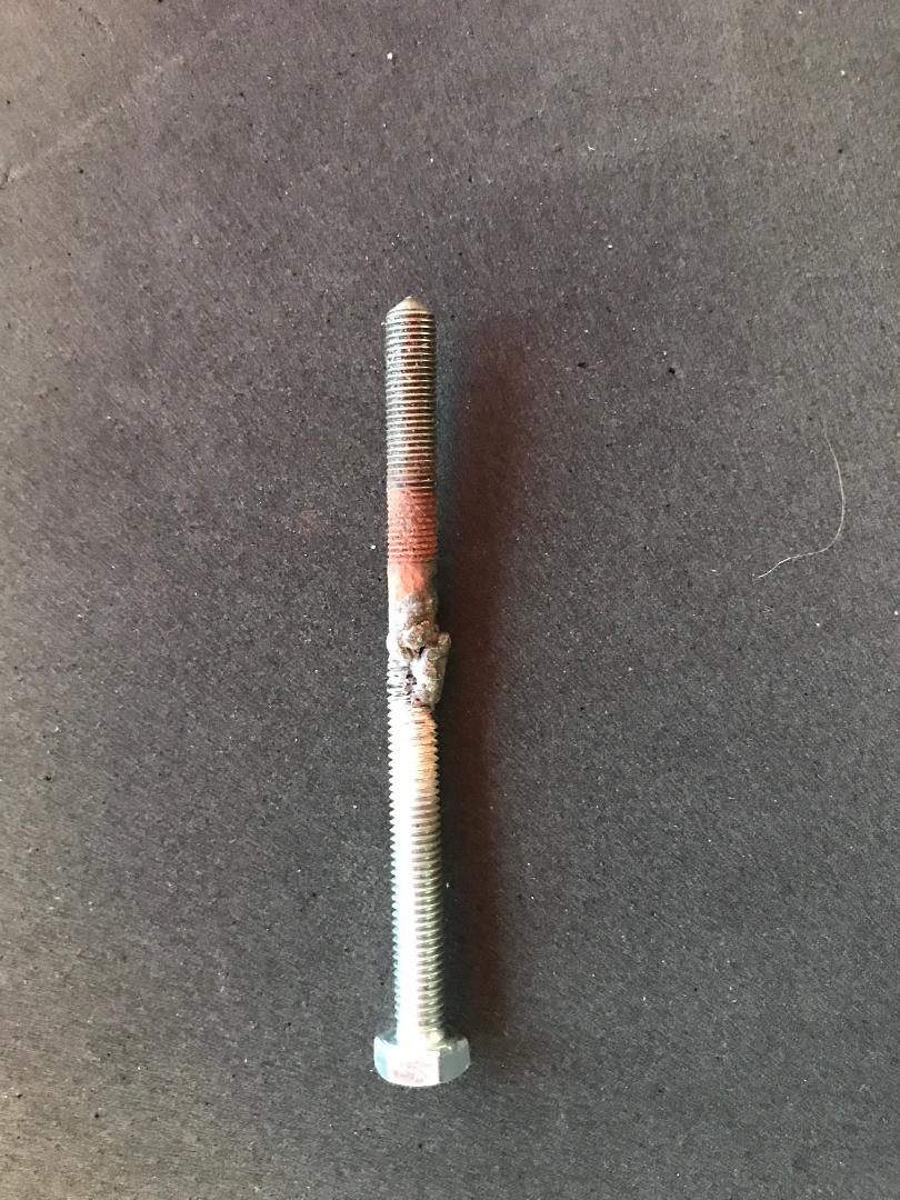

Found this in the back of my car, baseplate locking screw.
With a 8mm bolt welded on the end.Make it idiot proof and someone will make a better idiot.

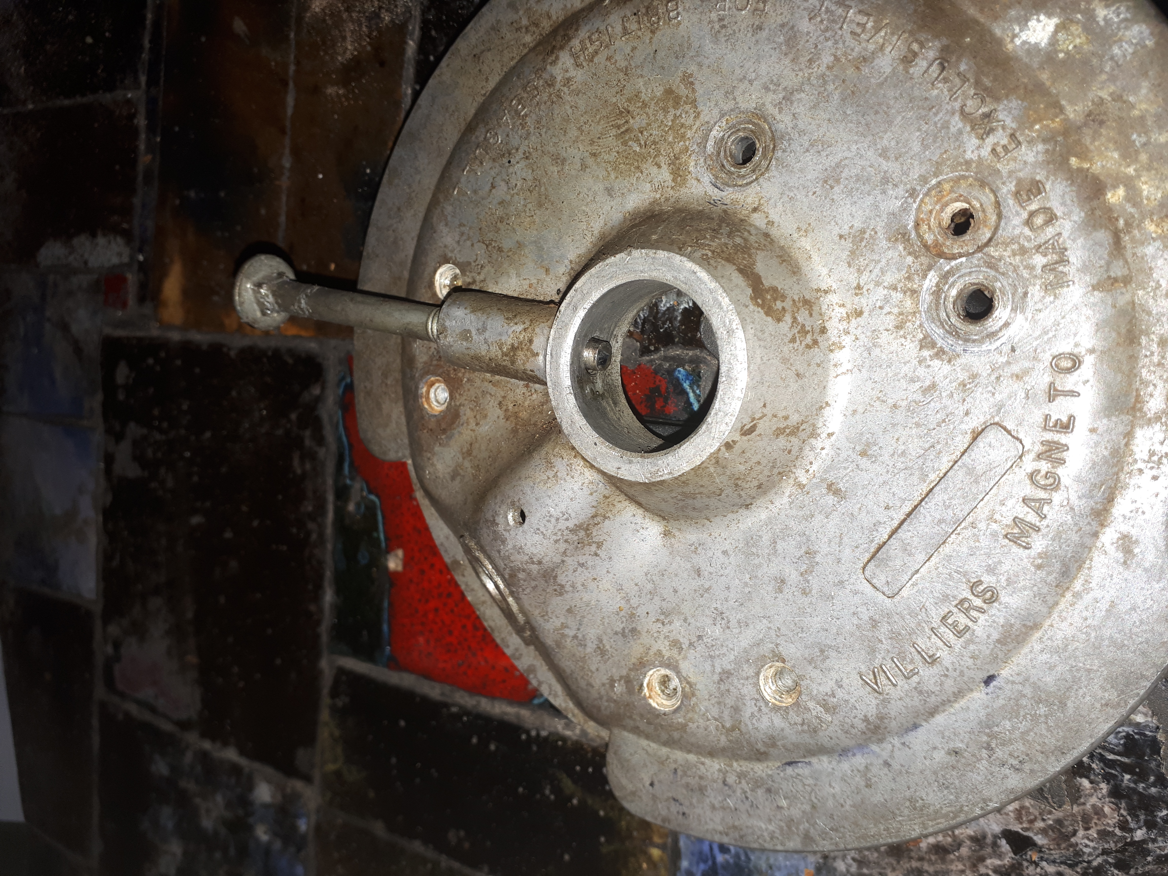

I have just done one of those stud bolts on a villers head. If its stuck you really need heat. Would think you could protect the coil ok - the large lug is a big heat sink - as is the baseplate ?
Without heat - try putting one nut on and tightening it as tight as you can. Then put on the 2nd and do the same. Then get a flat spanner on the lower nut. A good whack on top downwards does not go amiss ( shock tactics )
You can drill them out enough to break the flange as last resort ?
If your coil is good - treat it kindly - a rare beast !

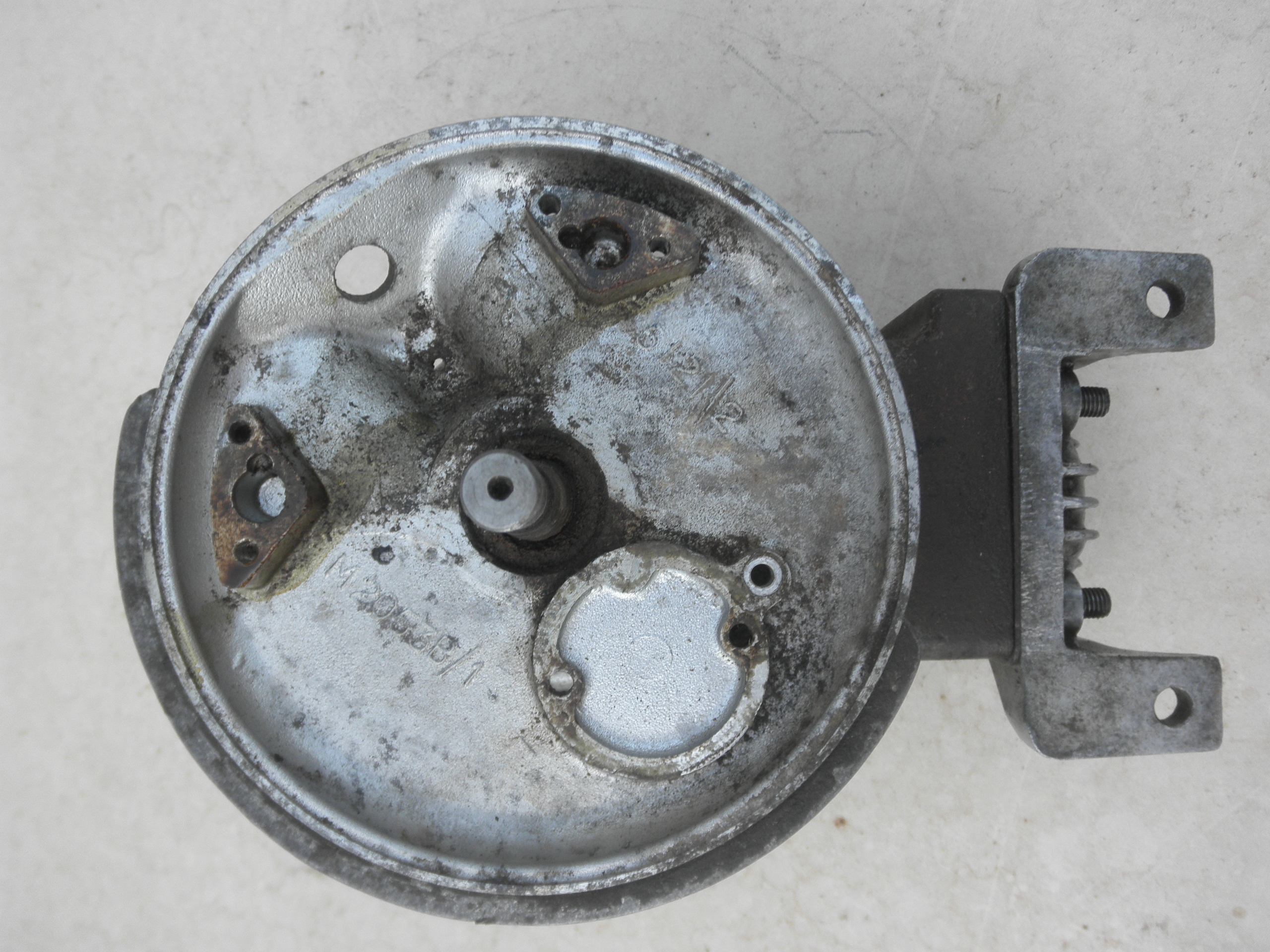

Believe it or not, I am still struggling with this thing - I just can't get the base plate retaining screw out.
I have done all the things listed above.
I have now smuggled the engine back to Sydney on a commercial flight.
i soaked it in diesel for 2 weeks.
I have welded a nut to the end of the screw, a number of times - but when I exert force on it, the nuts just chew off the end of the retaining screw.
There is now not enough left of the retaining screw to have another go at welding it again. I did everything I could - made sure it was scrupulously clean - used a MIG welder - used and arc welder -nothing worked.
Now I am trying to simply drill it out (I am still trying to save the thread) but the top of the retaining screw have broken off at an angle so any drill I use simply slides into the thread on the wall.
I am giving up.
I am going to try and take it to an engineering shop to get it removed - just gotta chalk this one up to experience I guess.
