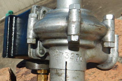

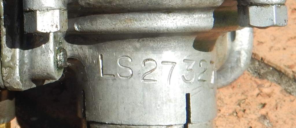

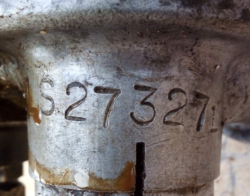

Can you give us the engine number from your 40 so we can let you know if it's a model that requires the steel gaskets.
Re: Steel Head and Base Plates
The steel plates are used between cylinder and crank case, and also as a head gasket. These were fitted to the little 40 engines only, so early F, (Only a few known) FV, FVP and LS engines in particular.
As Charles mentions below, its always best to state your engine serial number, so we know exactly what you have got.

Thanks guys - yeah, sorry, my mistake. Its a bit like blindfolding you then asking you about my engine.
Here are some photos.
Someone has obviously been at it, because I don't think its a Long Shaft any more.

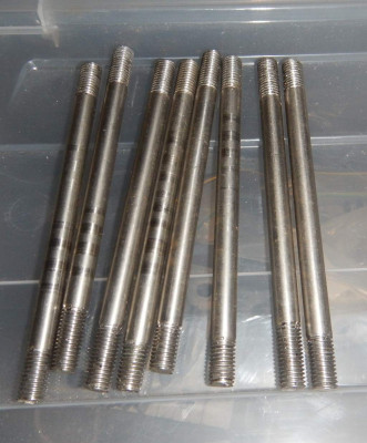

The steel studs were a mess, as you can imagine living in all that crap for decades. I like to reuse whatever I can, I like the thought of keeping things as they were from the factory, but the the steel studs were beyond salvation, they were so deeply corroded, I had no confidence they would hold up under the tension of being torqued down. And even if they did, they would have given out before too long.
So I went crazy on a lathe.....
:mrgreen:
Nice job 8)
