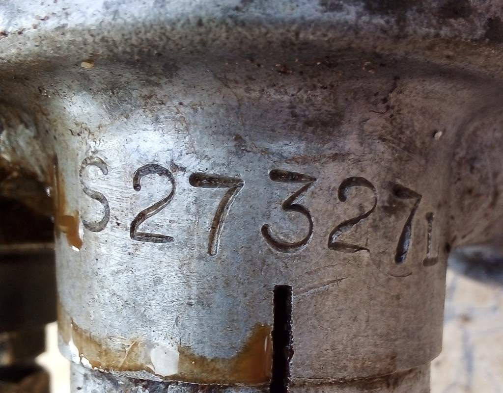

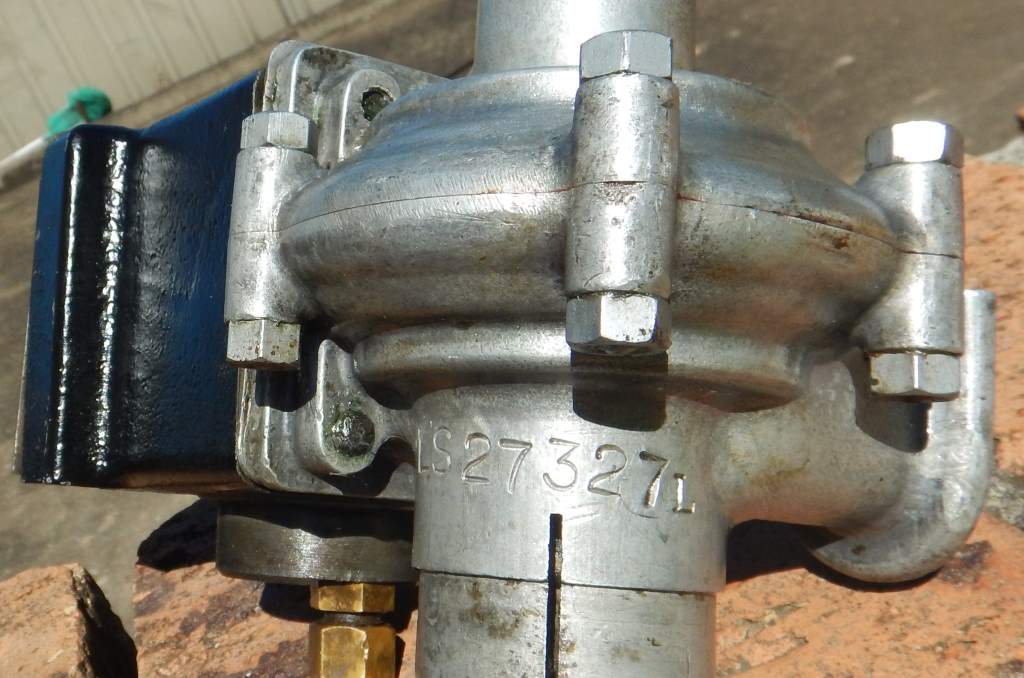

Thanks guys - yeah, sorry, my mistake. Its a bit like blindfolding you then asking you about my engine.
Here are some photos.
Someone has obviously been at it, because I don't think its a Long Shaft any more.

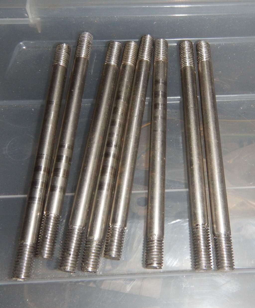

Like your blog of the LS strip. Yes, the water jackets do corrode a lot if used in salt and not washed out after every use. The steel studs react with the heads and cases. Tip welding and machining will bring them back of course.
Re: Steel Head and Base Plates
Yeah Oyster - you're exactly right.
The steel studs were a mess, as you can imagine living in all that crap for decades. I like to reuse whatever I can, I like the thought of keeping things as they were from the factory, but the the steel studs were beyond salvation, they were so deeply corroded, I had no confidence they would hold up under the tension of being torqued down. And even if they did, they would have given out before too long.
So I went crazy on a lathe.....
