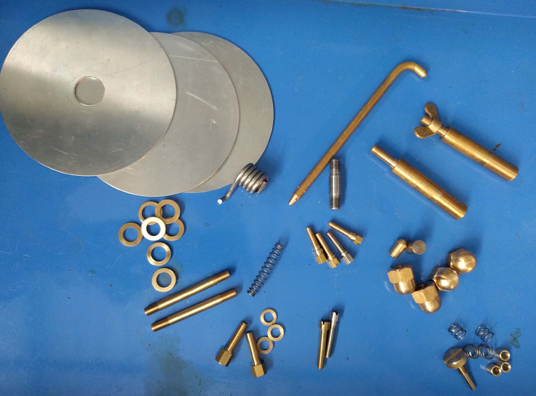

When reassembling a couple of early 102 Seagulls, I found that I was missing one of the 5/16 brass bolts (#1378) that secures the end cap. John didn’t have one and Sheridan only supplies the later cheese head design. It seemed to me that a replica bolt wouldn’t be too hard to fabricate on a lathe from a suitable piece of brass hex bar. I had only two problems with this approach in that firstly, I didn’t have a lathe and secondly, I had never used one before. This was a perfect excuse to procure said item and also venture into the rabbit hole of you tube videos in search of enlightenment and knowledge in the world of metal turning.
While unable to justify the outlay of several thousands of dollars for a piece of machinery to produce just one bolt, I somehow convinced myself (if not my wife) that a one thousand dollars spent on a less expensive mini lathe might somehow prove to be a worthwhile recreational purchase in the time of Coronavirus lockdown. So, it came to be, that a wooden crate containing a bright red Seig C3 mini-lathe was delivered to my house on the day before Good Friday. (While Seig is a German sounding name, the lathe was of Chinese origin.)
The definition of a lathe is said to be a precision machine used for producing scrap metal from perfectly good material. That’s probably a fair description but somehow, I did manage to replicate, to my satisfaction, the missing bolt and associated washer (#1378W) without injury to myself or machinery. Next on my list was slightly trickier starting pulley dome nut (#1268) followed by a couple of bent type bracket thumb screws (#1330).
As I slowly gained confidence, experience, (and a growing pile of scrap metal), I decided to see how many different Seagull parts the mini lathe could duplicate regardless of my immediate needs. Forum members with a Colchester lurking in their basement would probably regard a mini lathe as not much more than a toy, but I was able to manufacture a surprising number of parts. I found that using the lathe was different from most of my other power tools in that that it required little dexterity but rather requires the operator to have a good knowledge of the machine, correct tools, operational speeds and measurement instruments. A dial gauge and calculator are a must. The skill is in setting up the machine for the operation more than operation itself. Here are some of the lathe operations that I managed to achieve.

I found that the mini lathe could easily turn brass, aluminium, mild and stainless steel. The main limitation of a small lathe was the depth of cut, especially for the steels. You need to take numerous small cuts to reduce the diameter. One part that turned out well (pun intended) was #1266, the alloy flywheel cover. Prior to about 1952 there was no script on the cover making plain aluminium suitable for these Seagulls. I first cut out a rough shape with a jigsaw then machined them to size. I had to make up a fixture to hold the plate in the lathe.

I had some success making springs for the throttle and fuel cap vent. The trick was to make a mandrel of a suitable diameter so that after the spring was wound it would spring back to the required finished diameter. I made up a nozzle for the tool holder to feed the wire on to the mandrel while I turned the lathe by hand. I tried both music wire and SS spring wire and both worked well although the music wire looks closer to the original spring. As an experiment, I made up a mandrel to suit the propeller spring and wound on some 304 SS rod (in a vice, not using the lathe). The spring looks identical to a bought one but haven’t tried it out to see how it stands up in real life. I tried to make the small spring in the HT lead without much success.

I certainly wouldn’t recommend purchasing a mini lathe to save the cost of purchasing parts however there is a certain degree of satisfaction when the duplicated part ends up looking pretty much like the original. I have used the lathe for other projects and don’t know how I managed before I had it. Future projects include machining cork fuel washers as well as possibly propeller shafts and bearings. Making your own parts is an enjoyable and satisfying pastime. The photo below shows some of the Seagull parts that my mini lathe has produced.
Seagull Parts and the Mini Lathe
