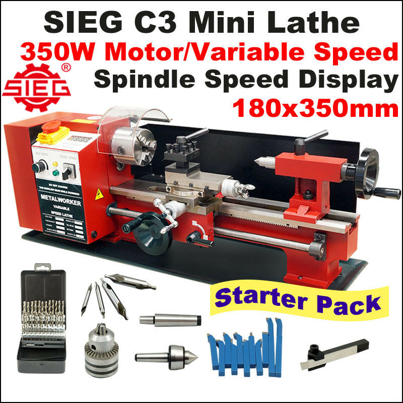

A picture of your machine would be welcome.

Thank you Sandro. Here is a picture of the Sieg lathe and accessories that I purchased. I have since bought some additional carbide tools as well a quick change tool post. I will keep adding to my collection of accessories and tools as time goes by. The ones from China are good value if you aren't in a hurry.
We used to have an old Colchester lathe at work that the workshop forman cherished. I didn't pay much attention to it at the time but realise now how good a machine it was. I bet Seagull had a few of these in their factory.

I have the same lathe, in the UK several sellers market them, mine is a Chinese made Chester lathe. Works well for small items.
