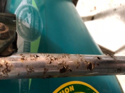

Hey Guys
The drive tube (???) on my 40 Plus Seagull is rusty azz ...
Are these easy to replace ??
Whats the best course of action ? .. remove and replace, remove and re-chrome or maybe mask it off, clean it up and spray it ??
Re: Rusty Chrome Drive Tube
That's not rusty! Ive got one that is ALL rust and it is still ok!
Yes very easy.
Take the gear box off the bottom and take the power head off the top.
I can talk you through it over the phone if needed (it is a lot easier than typing) Have a look at it then come back to us, it is good to keep things out in the open on the forum than doing things by PM but if needed I can help.

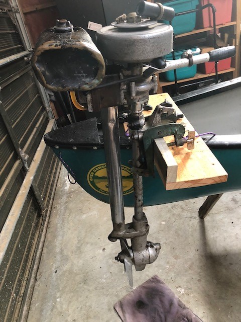

Post a pic, side elevation, of the water pump housing, lower unit & the bottom 50mm of the drive shaft tube.
bobbynz
Posts: 13
Joined: Thu Jan 10, 2019 9:22 pm
Location: New Zealand
Post by bobbynz »
here is the best pic I have here at the moment (ie Im not at home)
Notice no cinch bolt ?

Posts: 3295
Bolt missing! Clearer on my phone than puta!
The engine number will clear up the whole issue.
