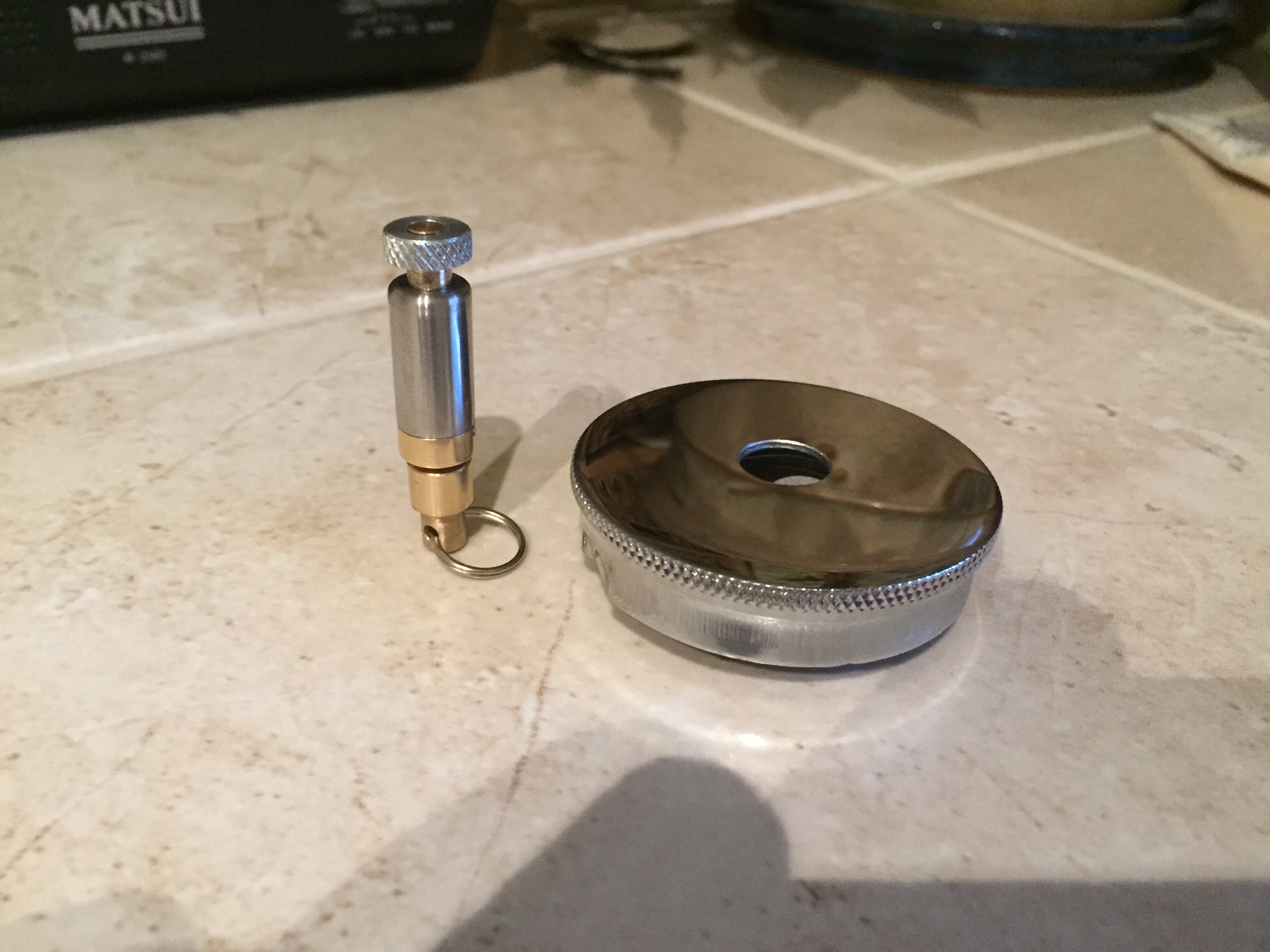

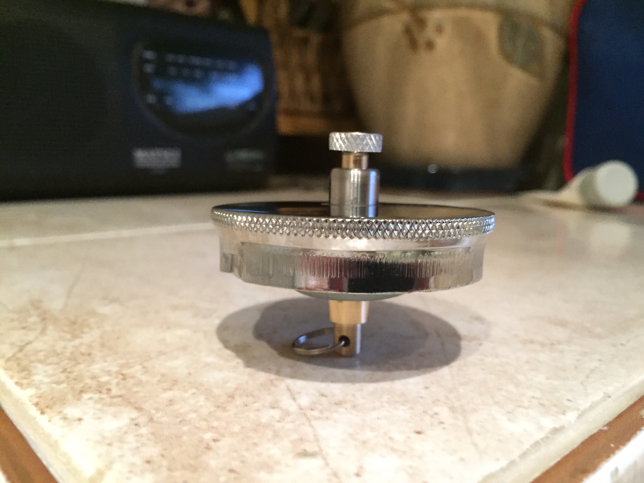

Bayonet fuel caps can be made. New caps from the original supplier are available, and the valve can be made by a competent Turner with a small lathe. I made a small batch a few years ago.
I made several fully working valves, and also dummy valves, where the cap breathed through a small hole in the diaphragm. The dummy is indistinguishable from the working version.
The Ceandess caps can be bought online.

Re: SD Tank
Thanks very much Oyster 49.
The photo's are much appreciated.
1. Do you prehaps have a dimensioned sketch ?
2. I take it that in order to have venting, one would 'loosen' the small knurled nob, does the brass threaded stem have a flat on it ?
3. Do I order from Ceandess - 2" chromed bayonet cap without vent hole ?
Appreciate the assistance
Dickon
Dickon

Yes, they are usually available on eBay from classic motorcycle dealers. My 1966 Triumph has one on the oil tank, the petrol tank is larger. The modern ones are steel, the originals were chromed brass.
I’m working abroad so cannot supply a drawing I’m afraid, unless somebody else can, Charles or H-A perhaps.The dummy vent is quicker and easier to make, just drill the diaphragm with a 0.75mm hole to allow the cap to breathe.
This is the part, prices seem to have go up a couple of pounds since I last bought any.
https://rover.ebay.com/rover/0/0/0?mpre ... 2037605498
