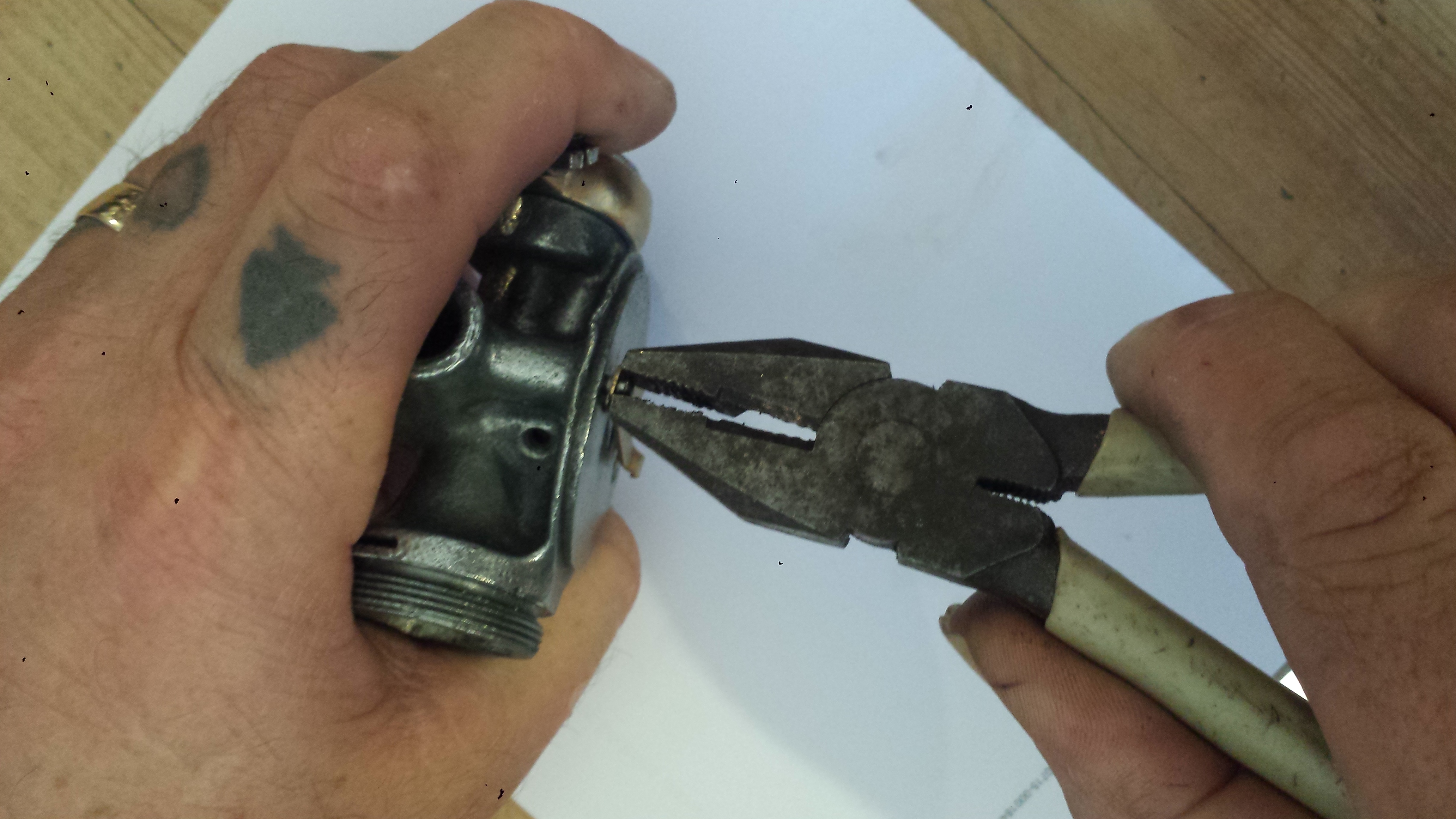

really cant get into the needle without bending the thin brass plate dunno if that's a good idea...I put w d all over the needle but to no avail..does the needle come out.
you live and learn, then you die and forget it all.
Re: carb
If the needle is moving in and out then it should be fine to leave alone but if you want the needle out then you have 2 options either take out centre jet or remove the small screw that holds the the flat brass part your talking about its just like a small self tapper.....I'd use long nosed pliers hope this helps

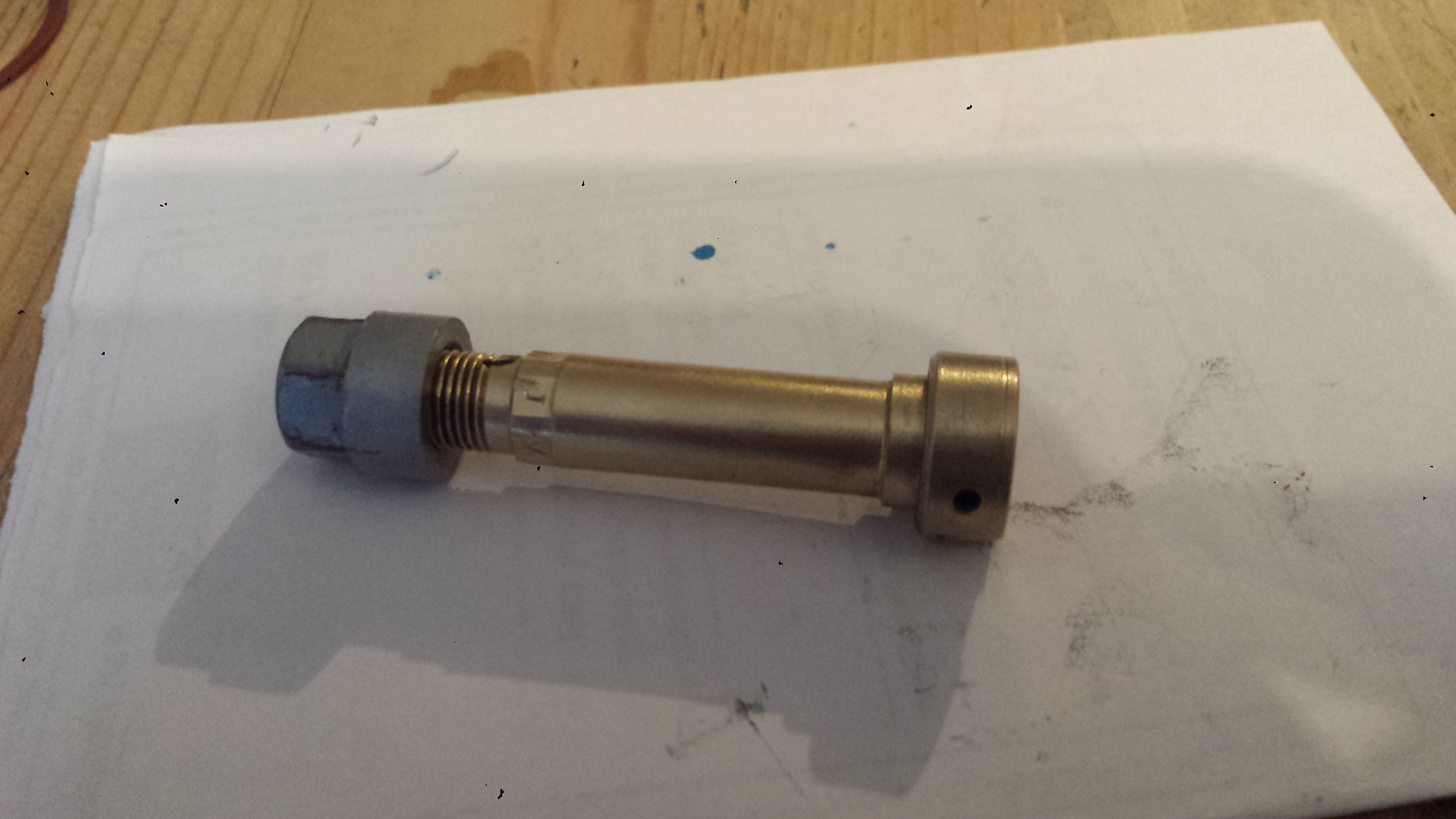

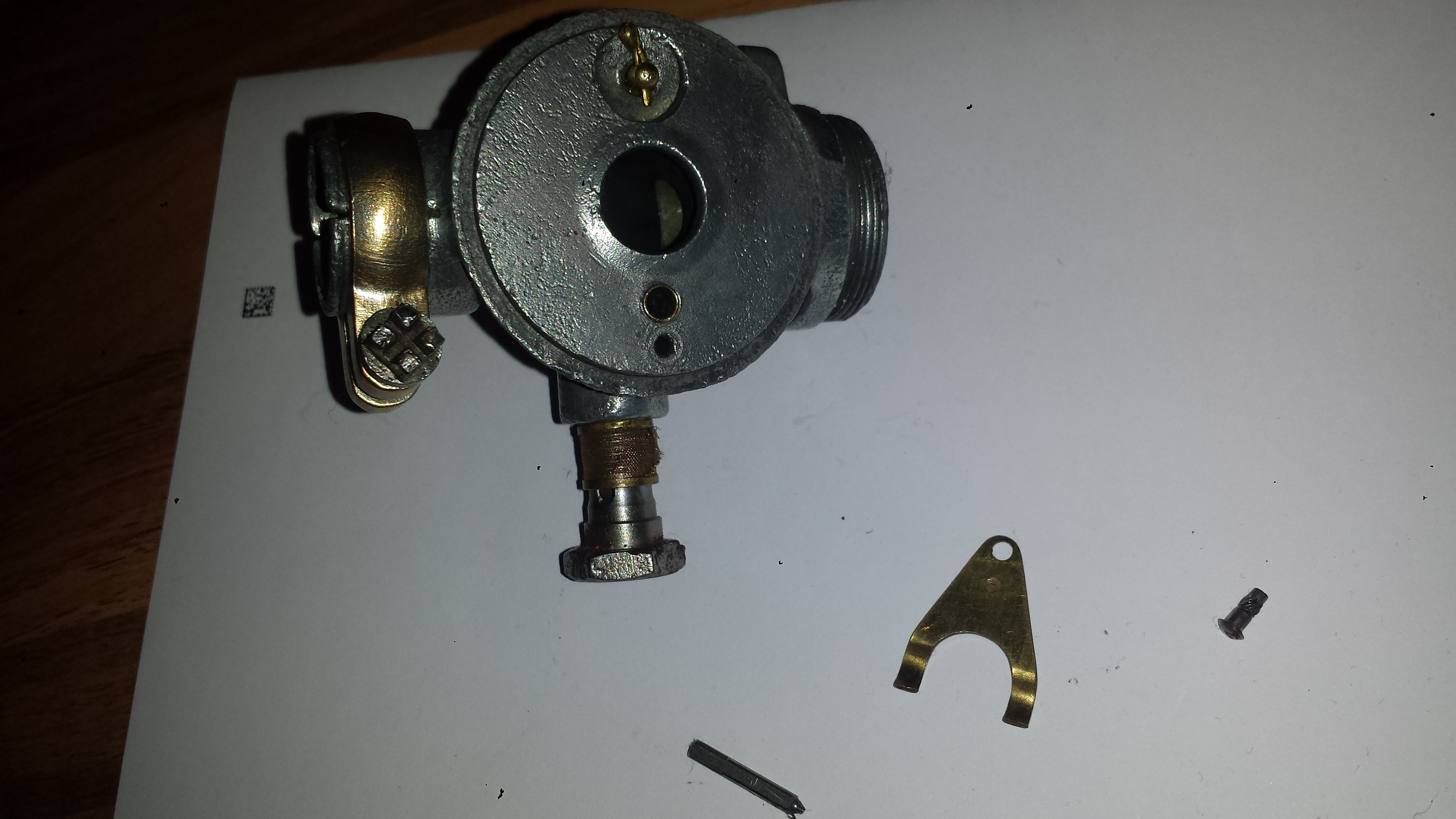

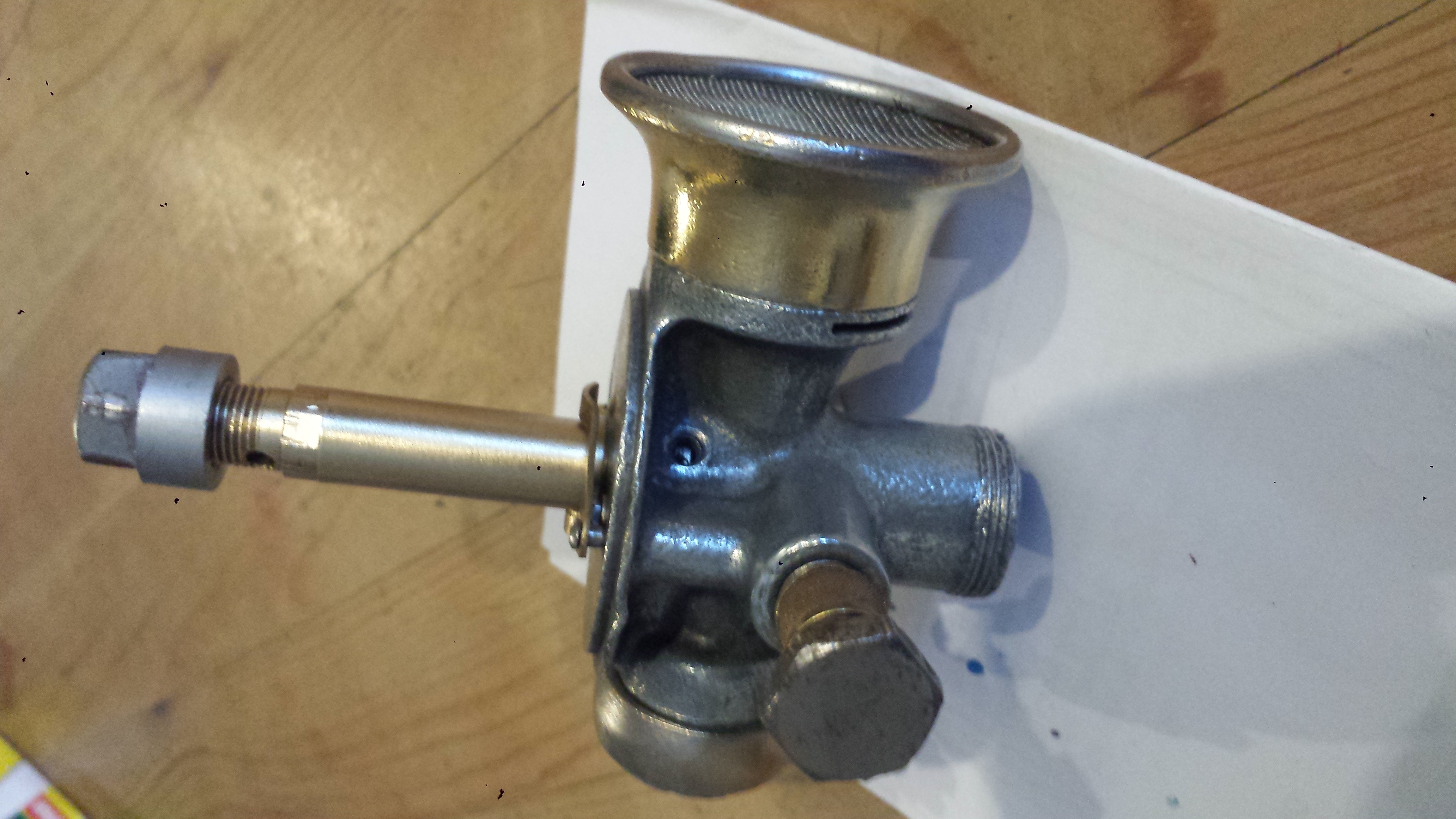

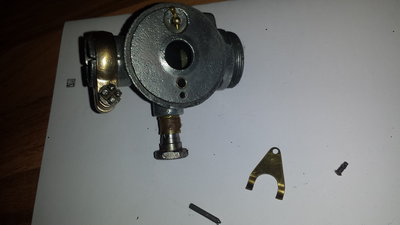

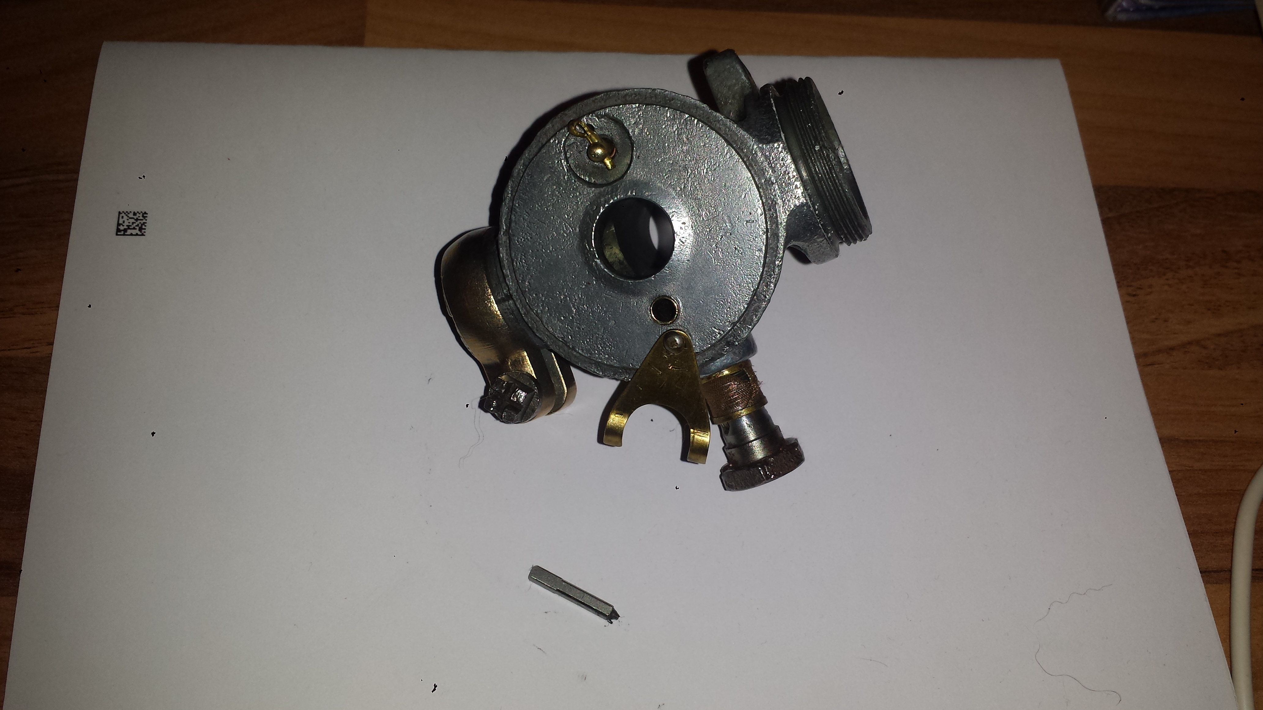

2 more pics 8)
Re: carb
Magic Tam!
If you use the correct sized spanner on the Jet, the chances are you will just remove the jet from the centre piece, if I remember right to remove the centre piece you have to remove the small screw in the throttle slide body then remove the top cap, throttle slide & needle & screw the centre piece further into the carb body & it will unscrew into where the throttle slide resides, the brass plate that hold the needle in place will swing out of the way, releasing the needle. Don't loose the washer!
Correct me if I've missed anything Tam, it's years since I serviced a Villiers carb.
Re: carb
Spot on C i forgot to mention that wee screw at side of carb body thanks :lol:

that brass jet in the centre does that just unscrew
Re: carb
Remember and undo the small screw on the side of carb body the centre jet will most certainly be stiff i tend to put the float bowl nut back on and apply gentle taps and that should free it...hope this helps
DO NOT TRY UNSCREWING IT'S NOT THREADED
Pm sent
Re: carb
Thanks for that Tam I thought it was threaded, it obviously isn't!
Told you I needed correcting!
Re: carb
Me to I'd forgotten about the wee carb body screw i think that's how most of them have the nut at the top chewed up. ...

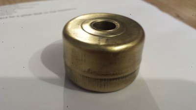

Re: carb

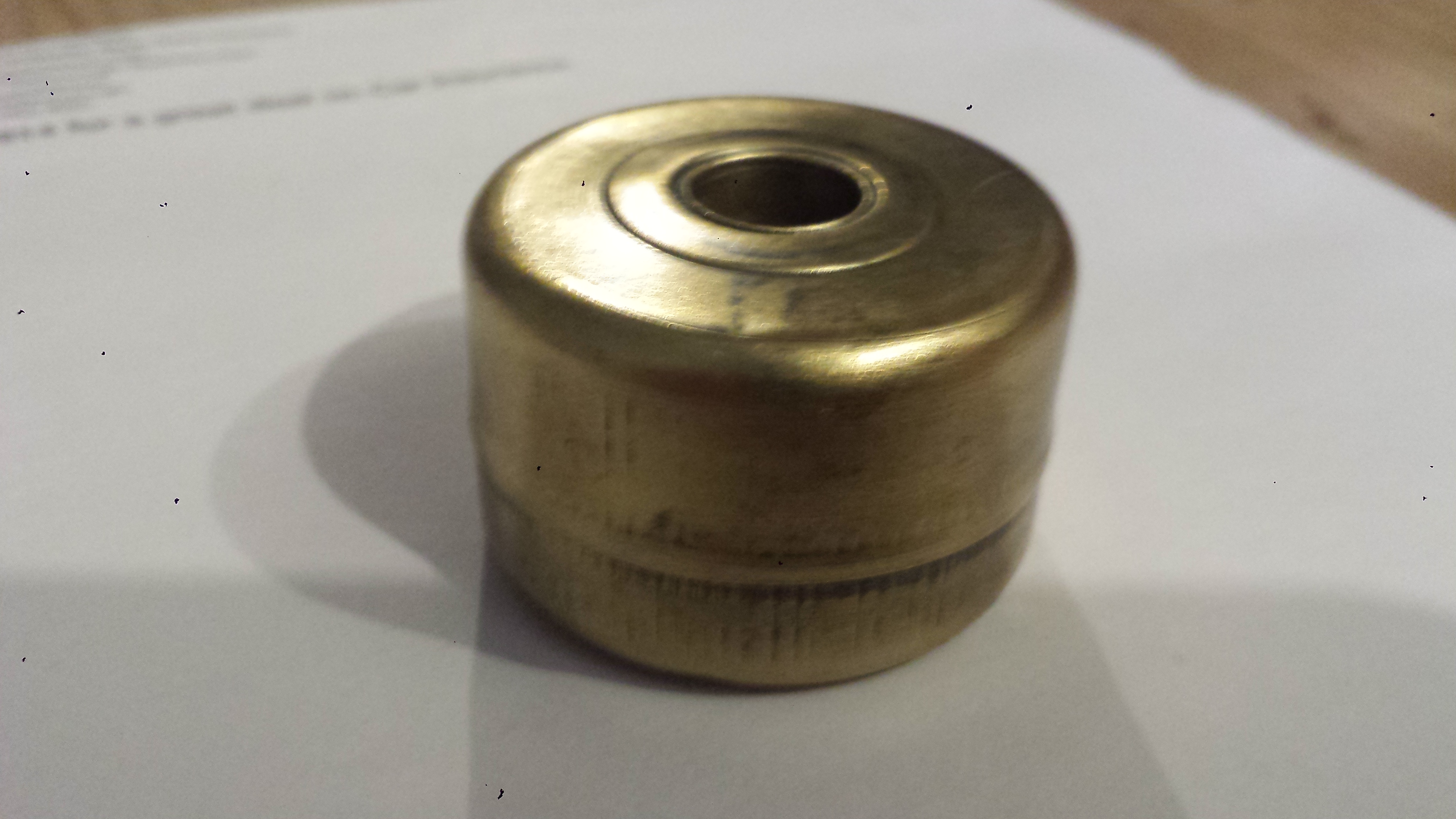

:lol: Just a thought make sure your float is moving freely simple test is to shake carb and you'll hear it moving also make sure float is not punchured and that it floats easy test just hold it under water and let it go (far out but you never know)....
