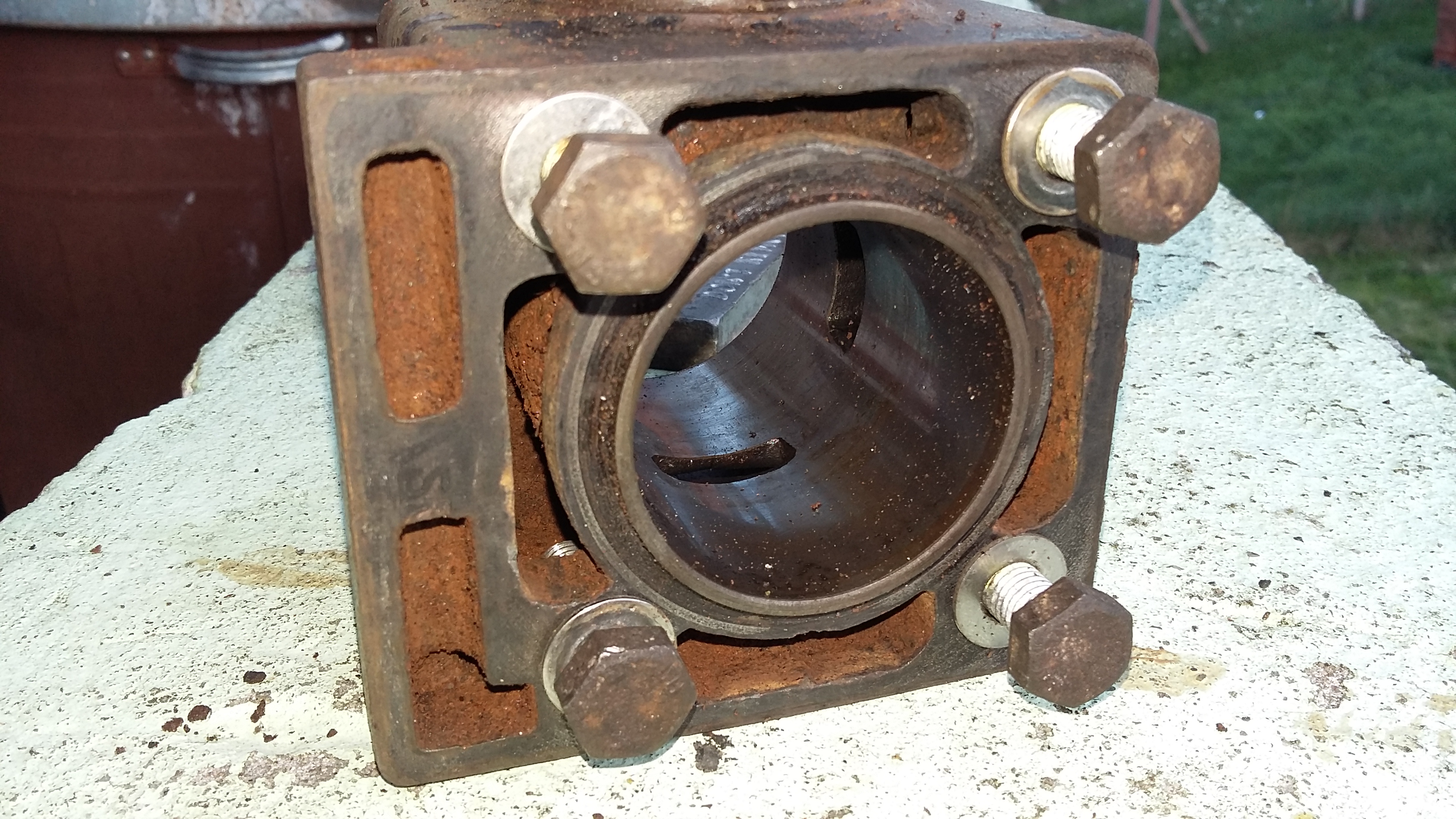

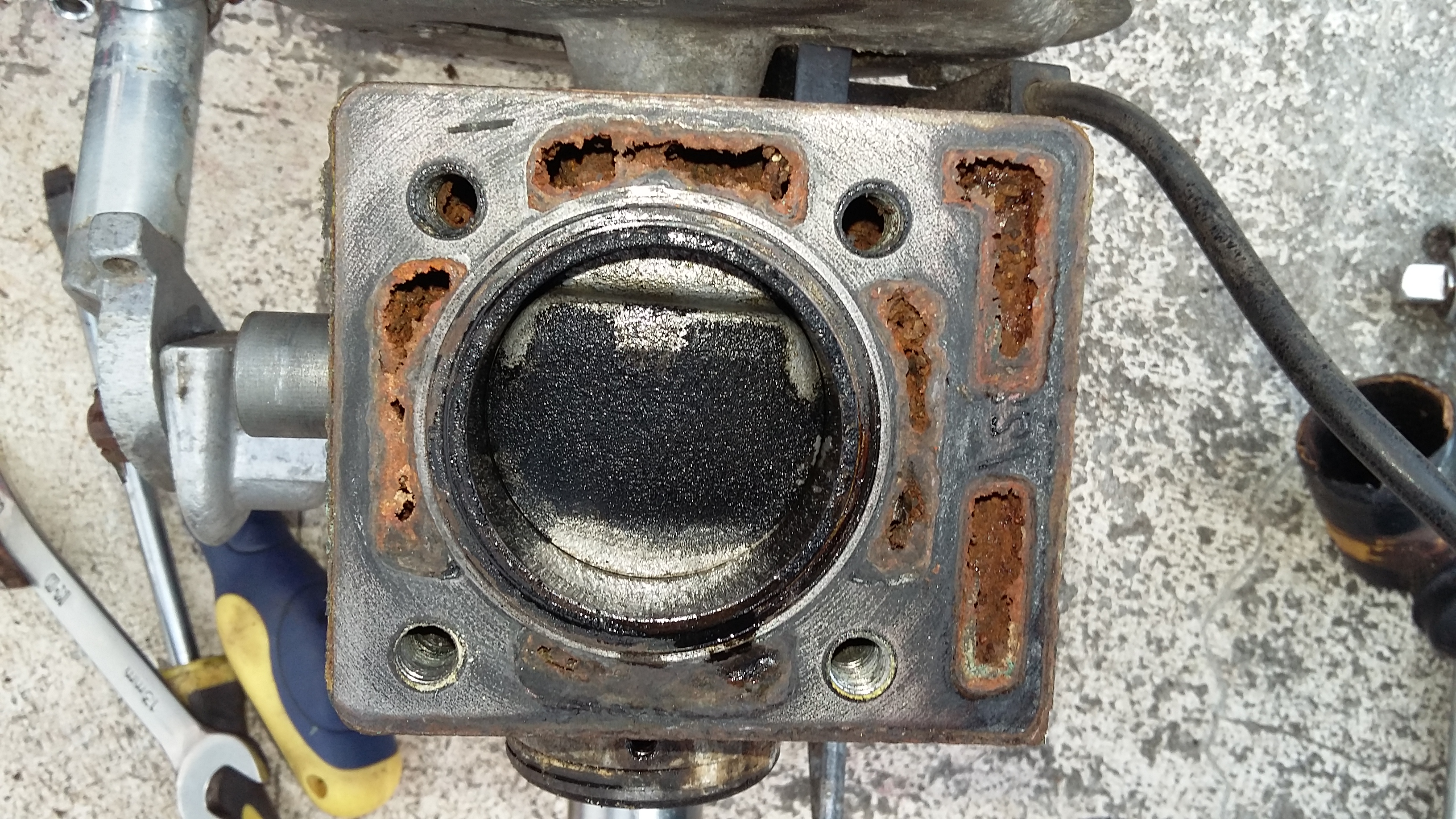

Well, I took the advice, and took the head off. I think it was a good idea.
Re: OMG part II. Off with his head.
Hello again Henk
Yep, that water jacket does look rather packed up with crud..
Here is what I did with my Century block: I used a long thin screwdriver to loosen up all the rusty muck, scraping and poking around inside.. and then some tapping with a rubber mallet to loosen it all some more (may not work so well if it's wet). Tipped that out, did it a few more times. I then blocked the inlet and outlet to the jacket, and filled it up with white vinegar (mild acid, so breaks rust/crud apart), left over night, then repeated previous steps. The block was then pretty well clear
Hope that helps.

Now would be a good time to assess how much further you want to go with this rebuild.
What you've done so far is a good way to go for peace of mind.The engine blocks will get a bit bunged up, this seems quite normal for a lot of seagulls these days. Thumbs up from me for having a go at this job.
Don't panic, we've seen this a hundred times or more.

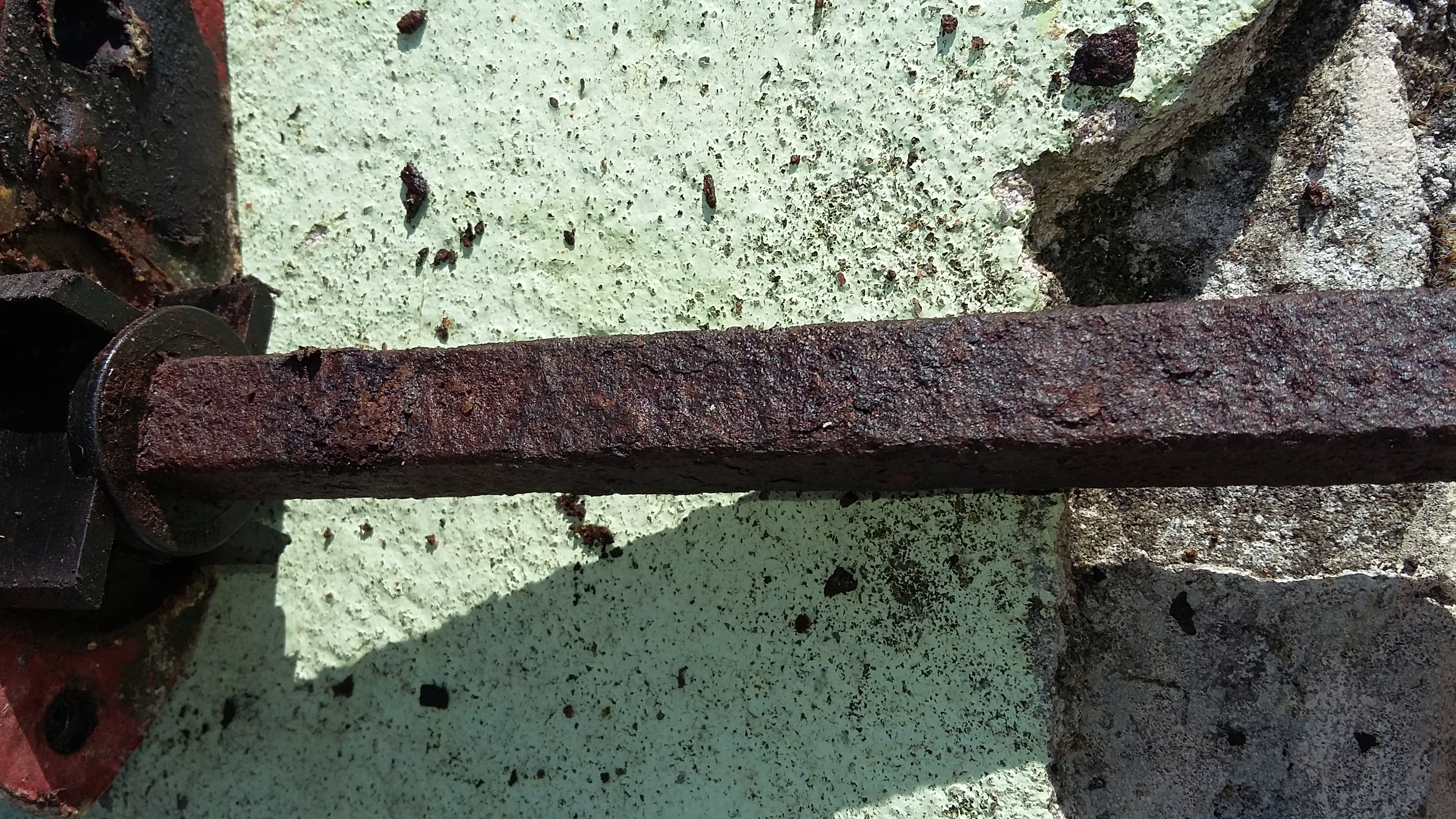

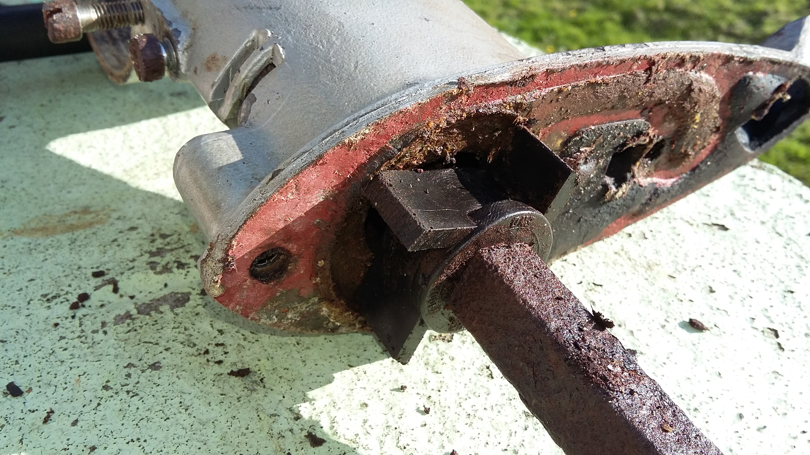

The square drive shaft that is now exposed will probably benefit from some rust treatment. Also a good opportunity to see how much play there is in the drive pinion.
Take it apart if you think you can (better if you can so you can do a proper job) otherwise leave in place and treat the rust as you see it.
If you decide to replace the pump housing gasket, then the driveshaft will have to be removed first.This will almost certainly be corroded in place and will probably be a sod to get shifted. It's a tricky job, but if you think you're able then go for it.

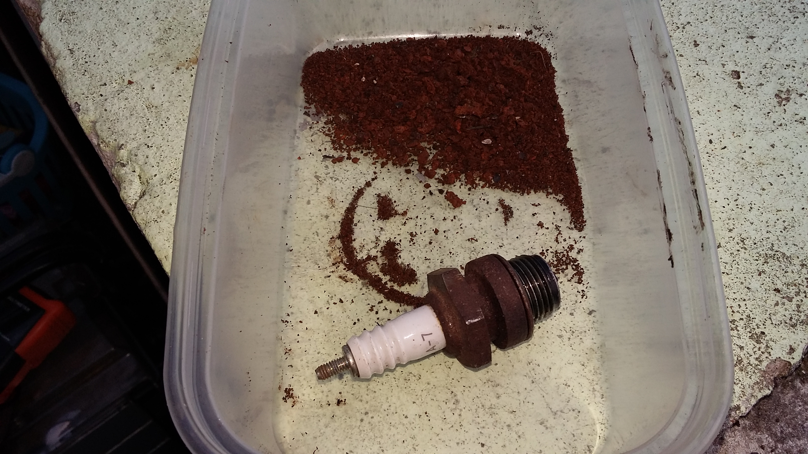

Cheers Whigum. I did the same as you, screwdriver and a long Allan key, and tapping with the rubber handle of a hammer. I'll try the vinigar tomorrow.
The amount of crud in the tub is about half of what has come out so far...
Welcome
That looks like quite a lot you got out there, I'd say it was definitely a good idea to clean it! Just don't store that mess in an old coffee jar, might give somebody a surprise

Thanks Jon. The drive shaft has rust (scale) on the bottom half, but a good (careful ) hammering indicates no weakness.headdownarseup wrote:Now would be a good time to assess how much further you want to go with this rebuild.

I want to replace the oil seals, but struggle with the cover over the lower seal, and how to remove the pinion from the drive shaft. That then seems to cover pretty much most of it, without taking the piston of the conrod and the crank out. I'll set about sourcing the various gaskets etc tomorrow.

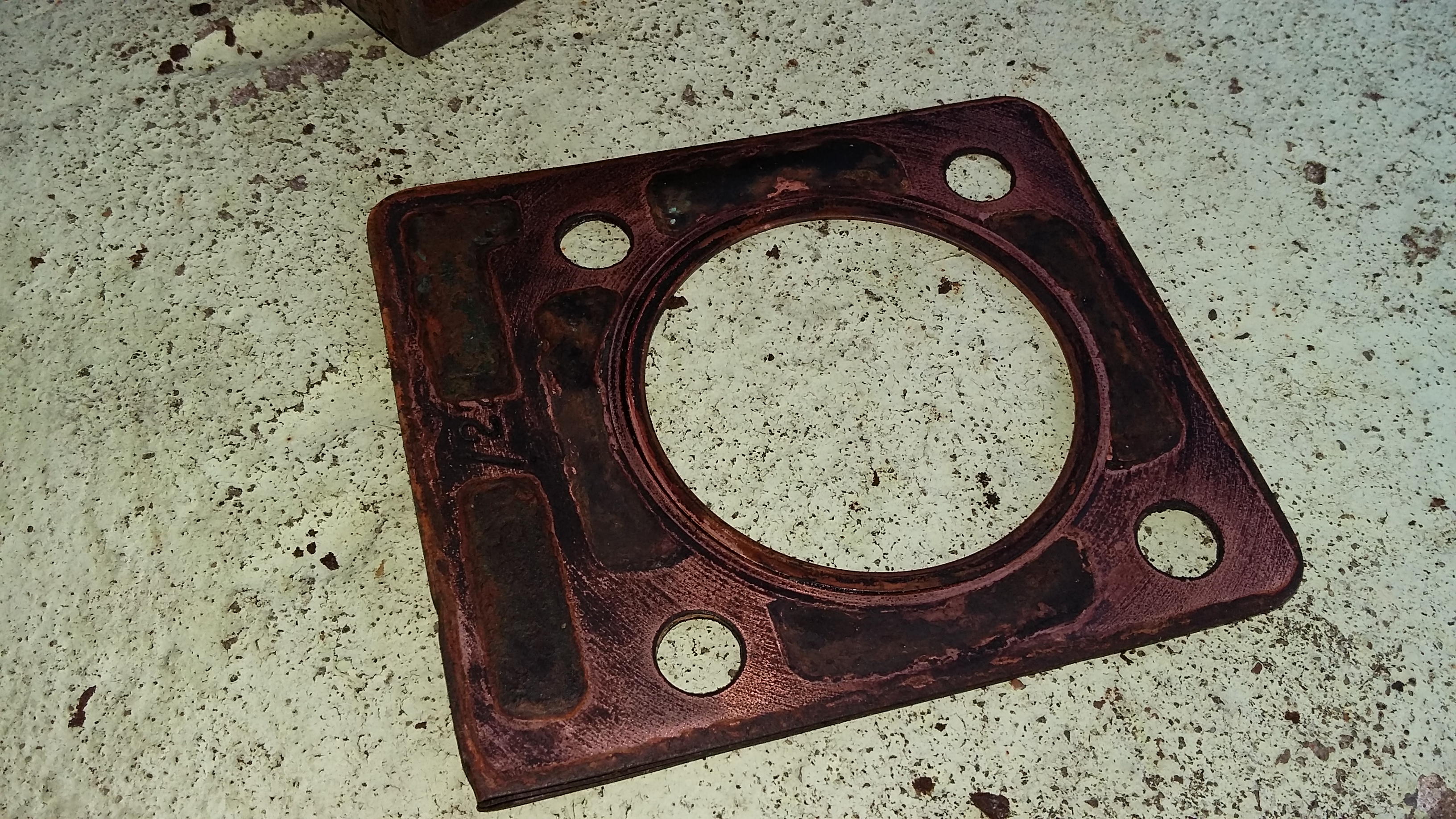

I'm making the list of parts to be ordered, and when I took the head off, there were three (3) head gaskets in place. Is that right?
Think you'll find it's only one they're layered.

I see. Cheers.tambikeboy wrote:Think you'll find it's only one they're layered.
This might help if you're shopping for bits.
Base gasket
Cylinder head gasket (as per Tam's reply they're layers of copper and crimped around the edges.)
