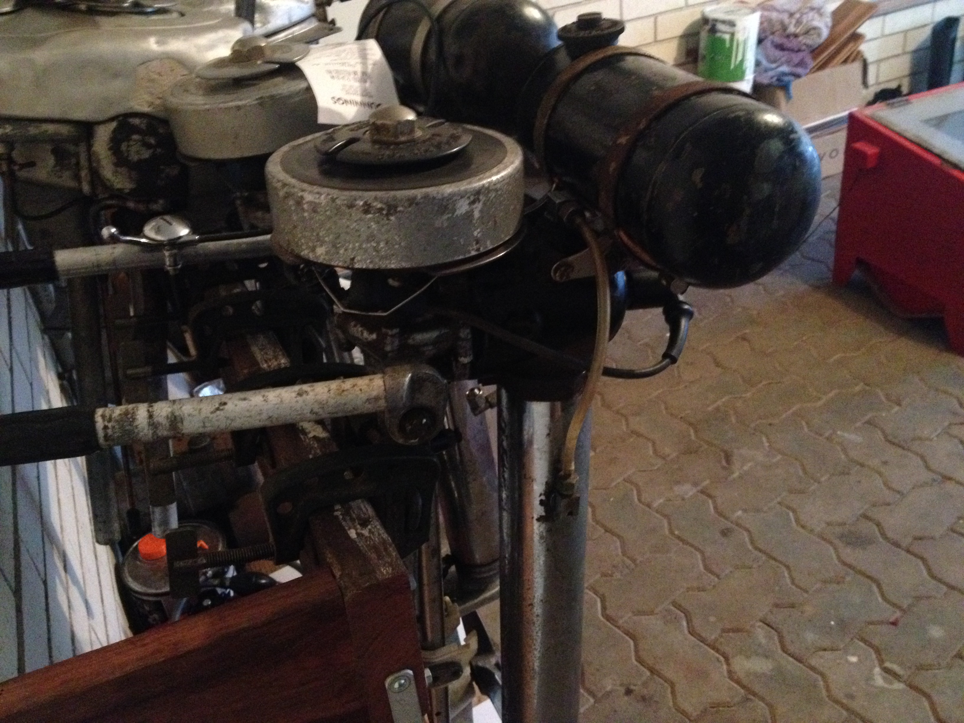

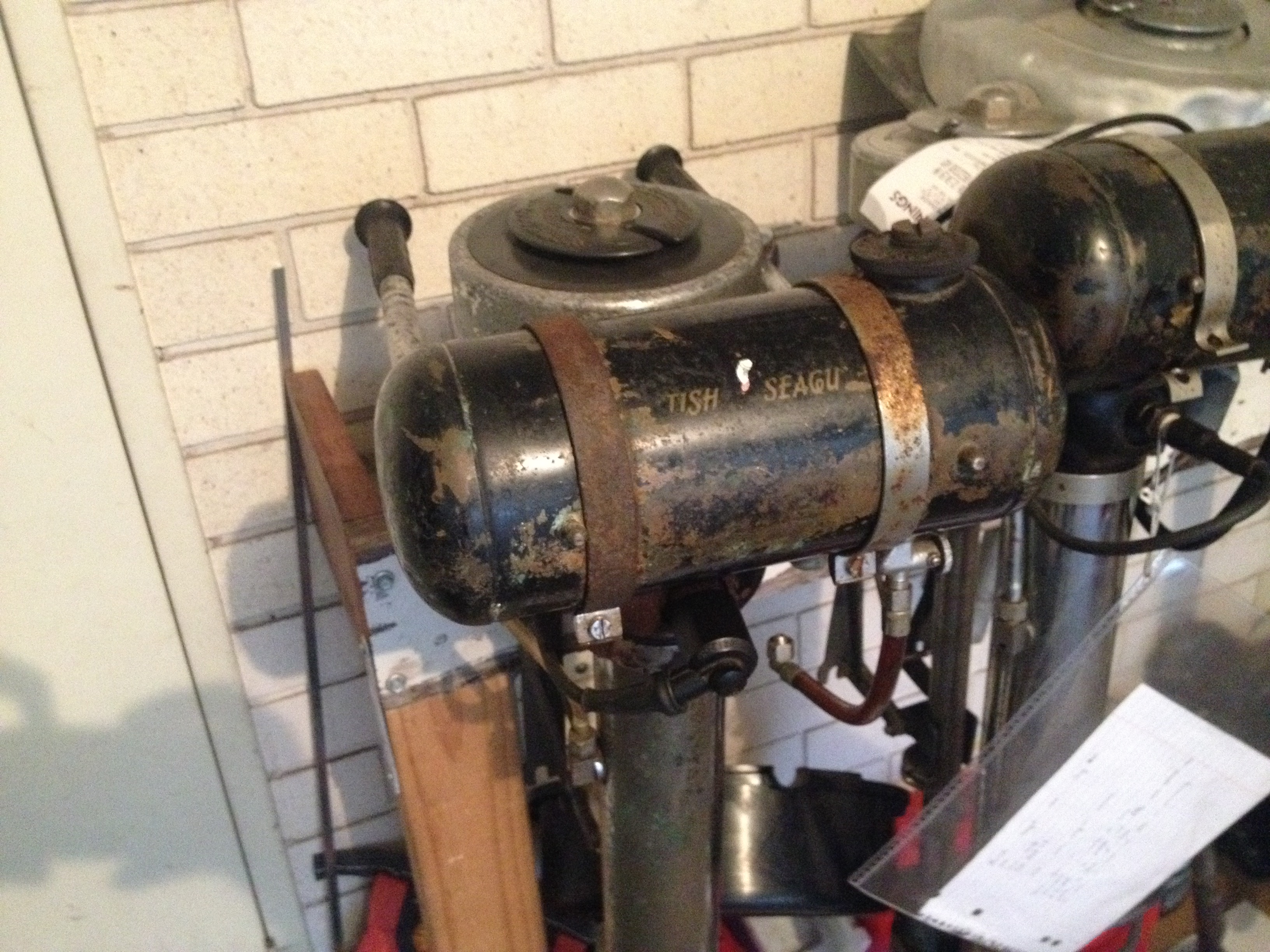

Hi all
Today I've been working on getting my other TD ready for our wet meet this coming Sunday. I have put the gearbox from AD13945 on it as it is in perfect working order, and with exams coming up every day this week I don't really have the time to get Te original gearbox to the TD working...
I know that this has been discussed on here before but I can't find the thread... Which prop (bow tie/hydrofan) should technically push the boat 'faster'?
I understand that Gulls weren't designed to go fast and they were meant as pushing power, but I'd like to hypothesise that one prop will push my dinghy slightly faster than the other, I'm not sure which one.
I will be taking both props to the meet, so let's place bets on which prop wins before Sunday then!! :lol:
Pics below are of the motor in question.
