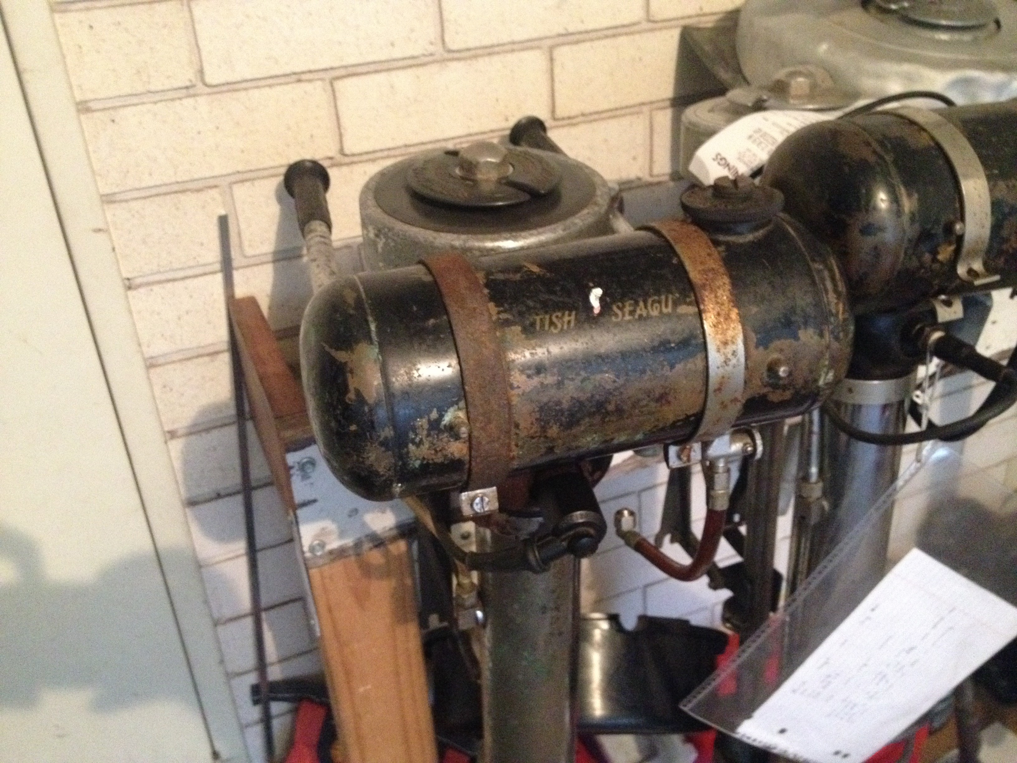

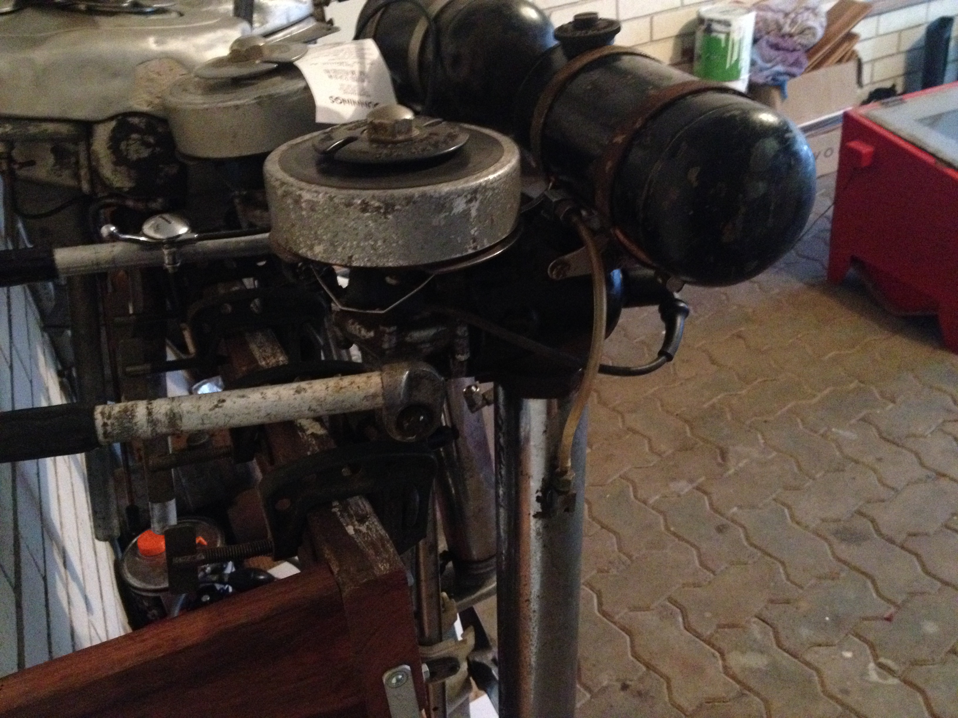

Pics below are of the motor in question.
