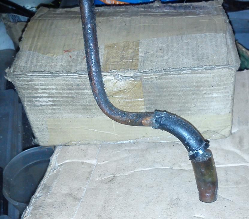

Hi,
This is the water transfer pipe from my TCL. It has the same water pump housing as yours.
It is as received. The lower pipe fits into the dimple of the housing. Not the best solution I could say. I prefer the older type with the short tube fitted in the housing.
To my understanding in case you use a hard nylon pipe and the copper tube pushes it into the dimple then it should work OK. But with what I see in your picture, indeed the connection looks fragile. Try to do something similar to what you see in my picture. The black tube doesn't seem to have any particular reason to be there. Or maybe it is the original after it get loose. Or maybe the black piece in your picture may be the remains of the original part.

Re: 102+ water delivery Pipe to waterpump conector
That clear plastic is a standard Seagull part for this style of water pump housing, the black rubber is a this will do the job for now repair.
