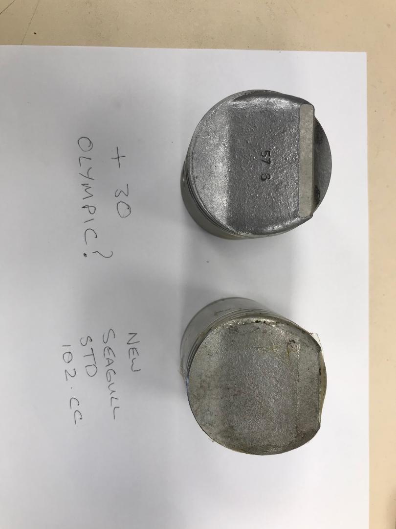

I've found my 30 thou oversize piston can't find the 10+ & the boxes & rings, but the ring pins are in the Seagull position. The skirt diameter measures 57.47 mm
A new seagull 56.73 mm
Re: Australian Olympic vs British Seagull AD102
Thanks for sharing Charles. I'm not convinced that +30 piston is from an Olympic. The castings looks different. Could you please post of pic of the ring pin please? I would like to see where it sits in the groove. Also a pic from the underside of the piston to see if there are through holes or fixed castings for the ring pin.Charles uk wrote:The anal bit is in my genes Bruce, If I did one of those DNA things, they would find an awful lot of POM in there!

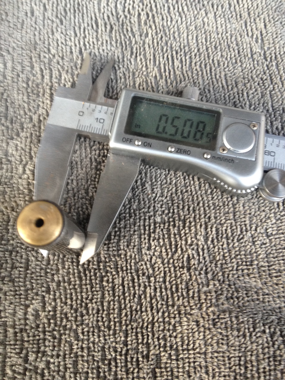

Gudgeon pin diameter?

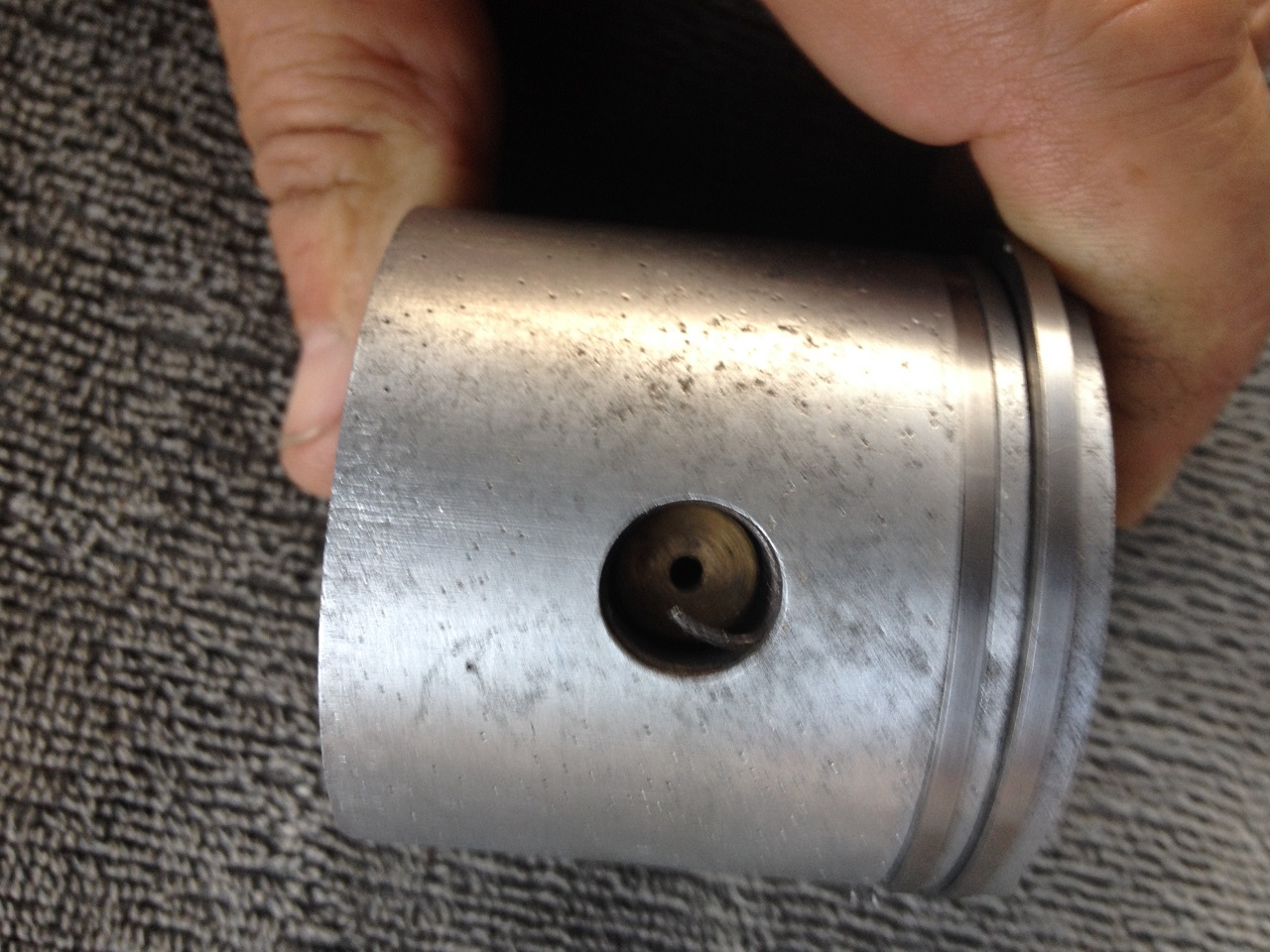

Olympic piston no circlips? Yes, on both sides of course.

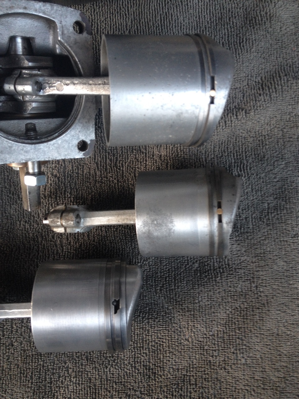

Olympic piston ring pin positions? Same positions as Seagull. Pic below, from top to bottom Olympic # 276, Olympic # 103 and Seagull AD 102 (early 50's)
