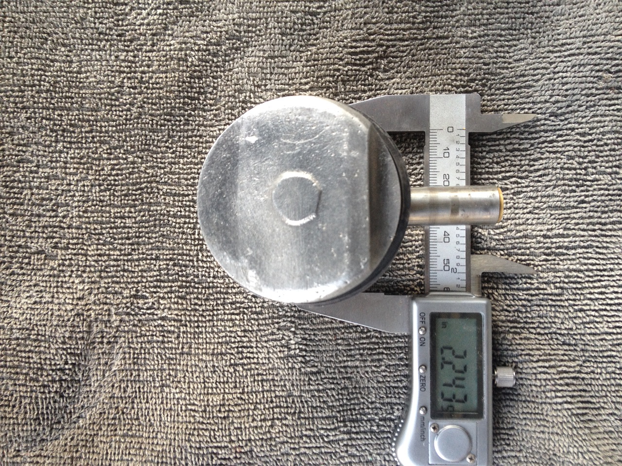

Measurements are correct, hence the inclusion of the feeler gauge in the images. Ring breakage is more common when the gaps are under rather than over-sized, but yeah, I agree those gaps are ridiculously large.Collector Inspector wrote:The ring gaps..........totally incorrect I am afraid.
Such as those indicates at the very least ring breakage under load.
That is if the poor things actually run.
I suggest revisit?
As said above, will drop rings from # 103 in to the barrel of # 276 and re-measure. The barrel then becomes the common for comparison purposes.
Also as said earlier, locating/stop pin sits centrally in the ring groove, therefore the ring gap will be much bigger than standard for a Seagull on which, the pin is offset sitting half in, half out of the ring groove.

Before you go anywhere near that ring with a file.
Gap it again when it's in the right location, 5 mm above the exhaust port, push it into that position with the skirt of a piston, to ensure squareness.
Measure again.
The previous position was good enough to show that the bore diameters were different.
Measure again.

I've found my 30 thou oversize piston can't find the 10+ & the boxes & rings, but the ring pins are in the Seagull position. The skirt diameter measures 57.47 mm
A new seagull 56.73 mm

Thanks for sharing Charles. I'm not convinced that +30 piston is from an Olympic. The castings looks different. Could you please post of pic of the ring pin please? I would like to see where it sits in the groove. Also a pic from the underside of the piston to see if there are through holes or fixed castings for the ring pin.Charles uk wrote:The anal bit is in my genes Bruce, If I did one of those DNA things, they would find an awful lot of POM in there!
To your previous questions, please see post below.

Gudgeon pin diameter?
Olympic piston no circlips? Yes, on both sides of course.
Olympic exhaust port bridged? Yes, refer previous pics inside barrel. You may need to brighten them up a little to see more clearly.
Spark plug 18mm x 1/2"? Yes, sames as AD 102. Confirmed by fitting the same spark plug to Olympic and BS Ad 102 barrel.
Olympic piston OD at bottom of skirt? Sorry, didn't realise you were going to provide metric measurements. Seagull piston had a slightly smaller OD but it looks like I have accidentally deleted that photo.
Olympic piston ring pin positions? Same positions as Seagull. Pic below, from top to bottom Olympic # 276, Olympic # 103 and Seagull AD 102 (early 50's)
Charles, I should say the battery on my vernier is on its way out, reflected by display cycling on off on off etc. Usually when this happens, the measurements taken can be slightly out. Just a point to note.
Now I have some questions. Next post aye!
