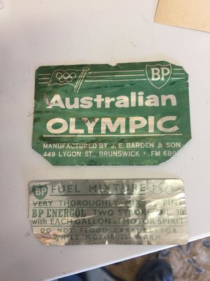

For those of you who may not already be aware, J.E. Barden & Son of 449 Lygon Street, Brunswick, Victoria, Australia produced an outboard motor (the the Olympic Big 4) which looked very much like a British Seagull AD 102.

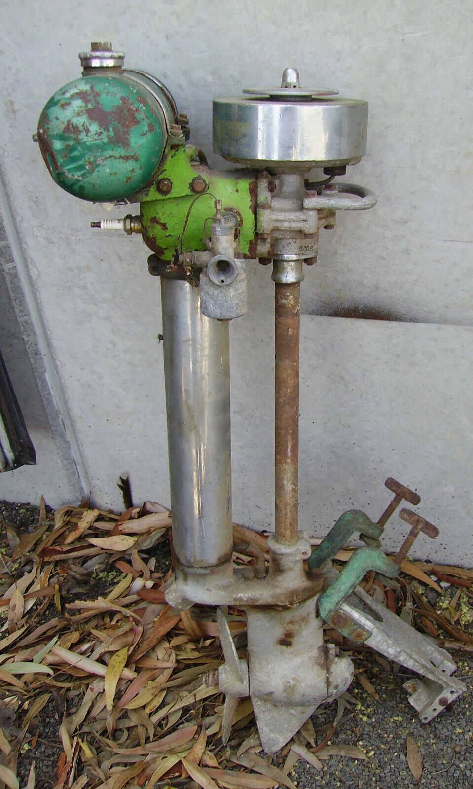

Over the last couple of weeks, I've been fortunate to purchase two examples, both in rather poor condition, but hopefully sufficient to allow the build of one running unit with a few parts remaining.
The first, advertised on eBay was collected a little over a week ago. The second due to arrive later this week is from SOS member Hugz who responded to a request for parts on my facebook group Vintage Outboards Australia. Here they are;

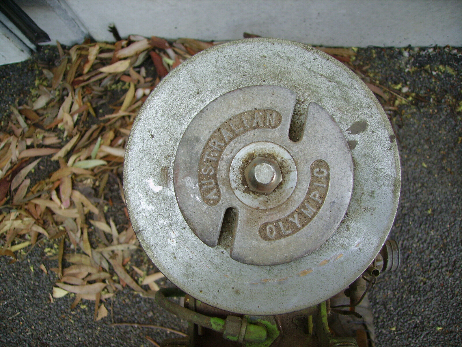

The most obvious differences between the Australian Olympic and the AD 102 is the flywheel magneto (made by Bailey Australia), the fuel tank mounts and straps and the forward mounted carry handle. All else looks to be the same until one takes a MUCH close look.

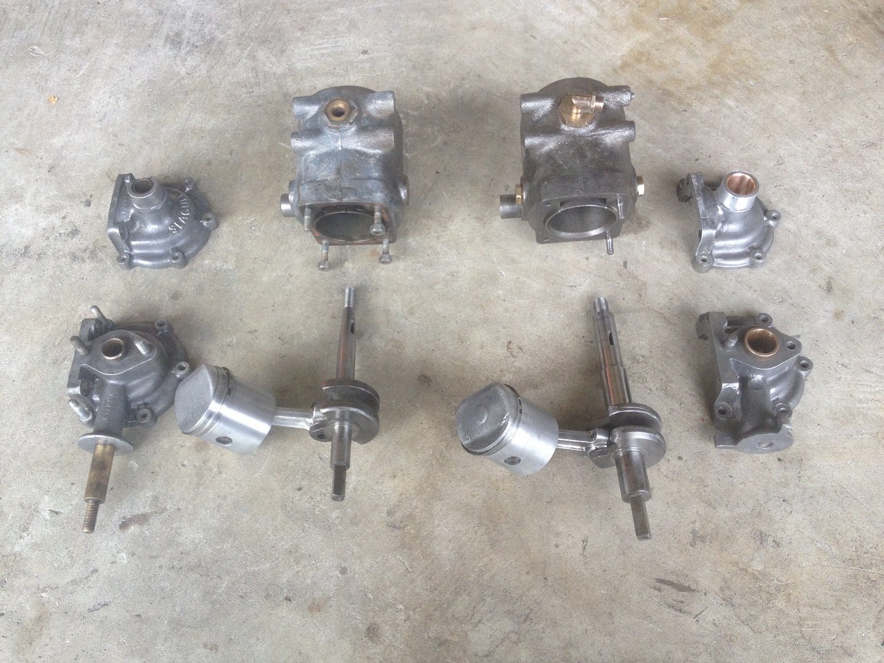

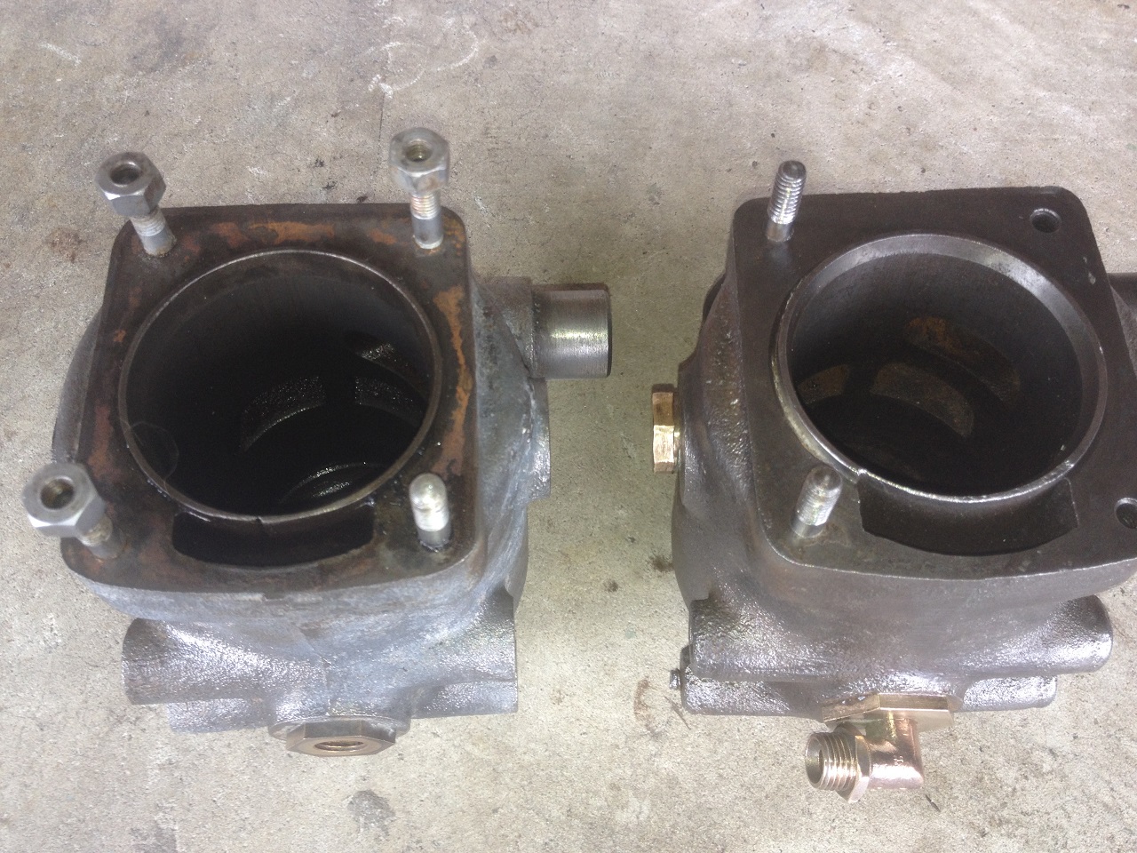

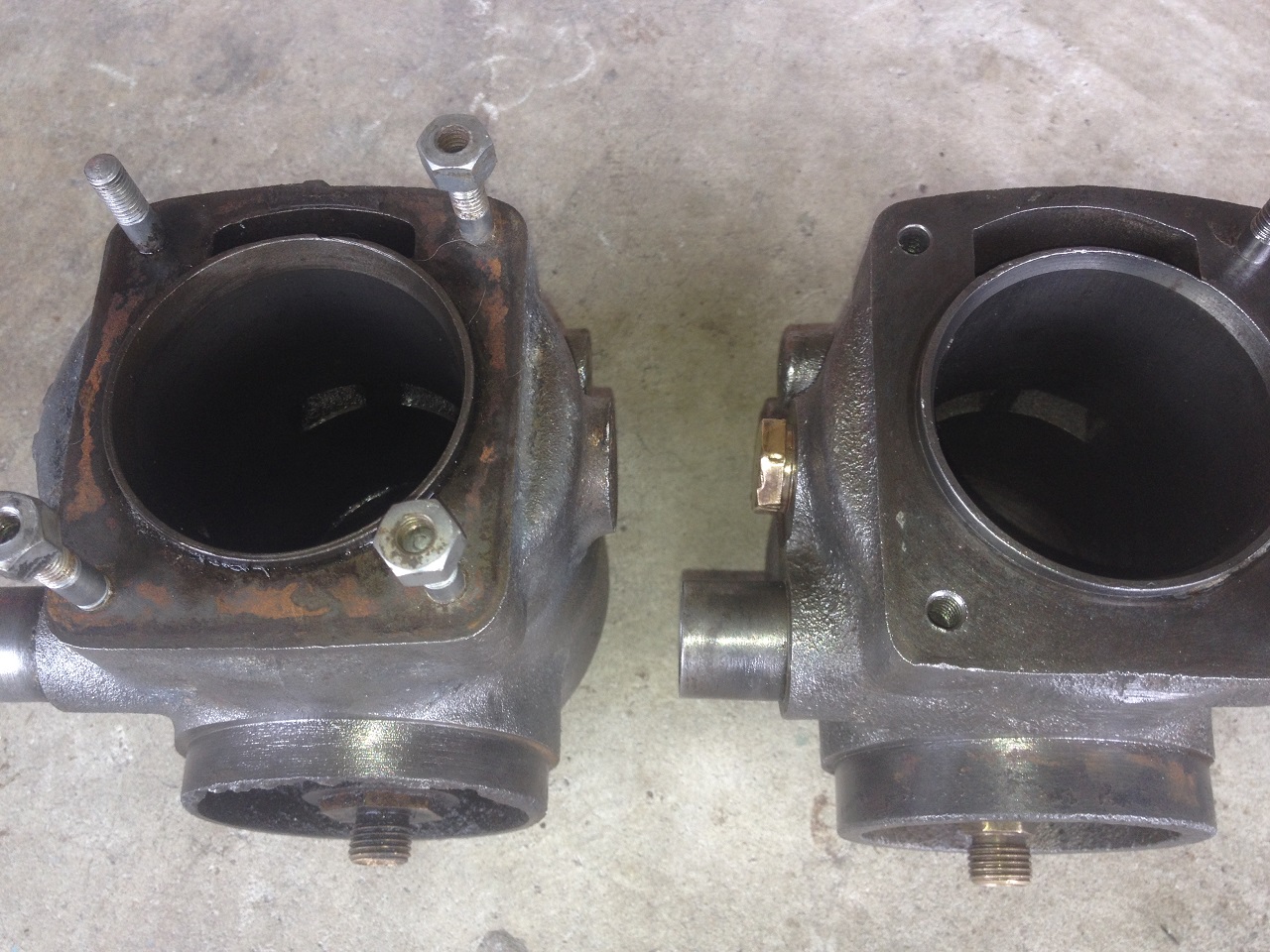

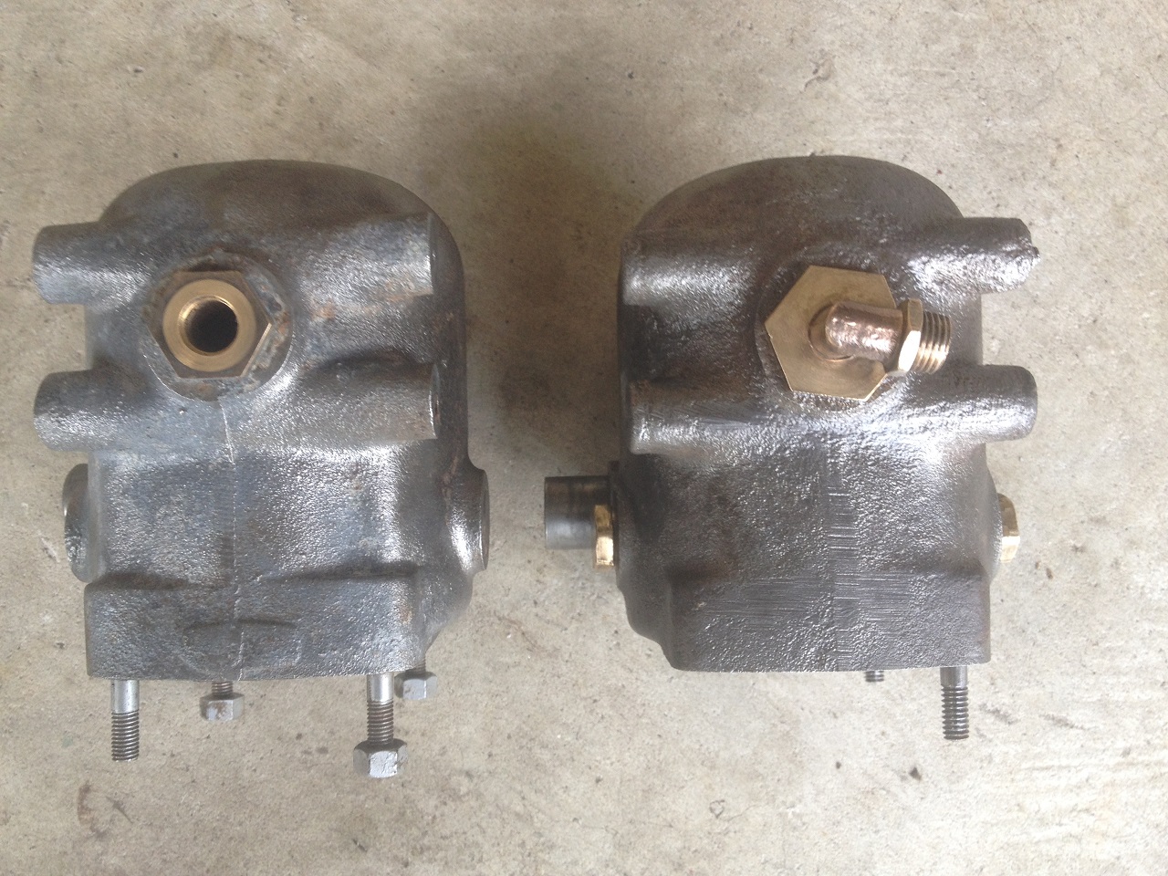

Lets start with a general view of the engine components.

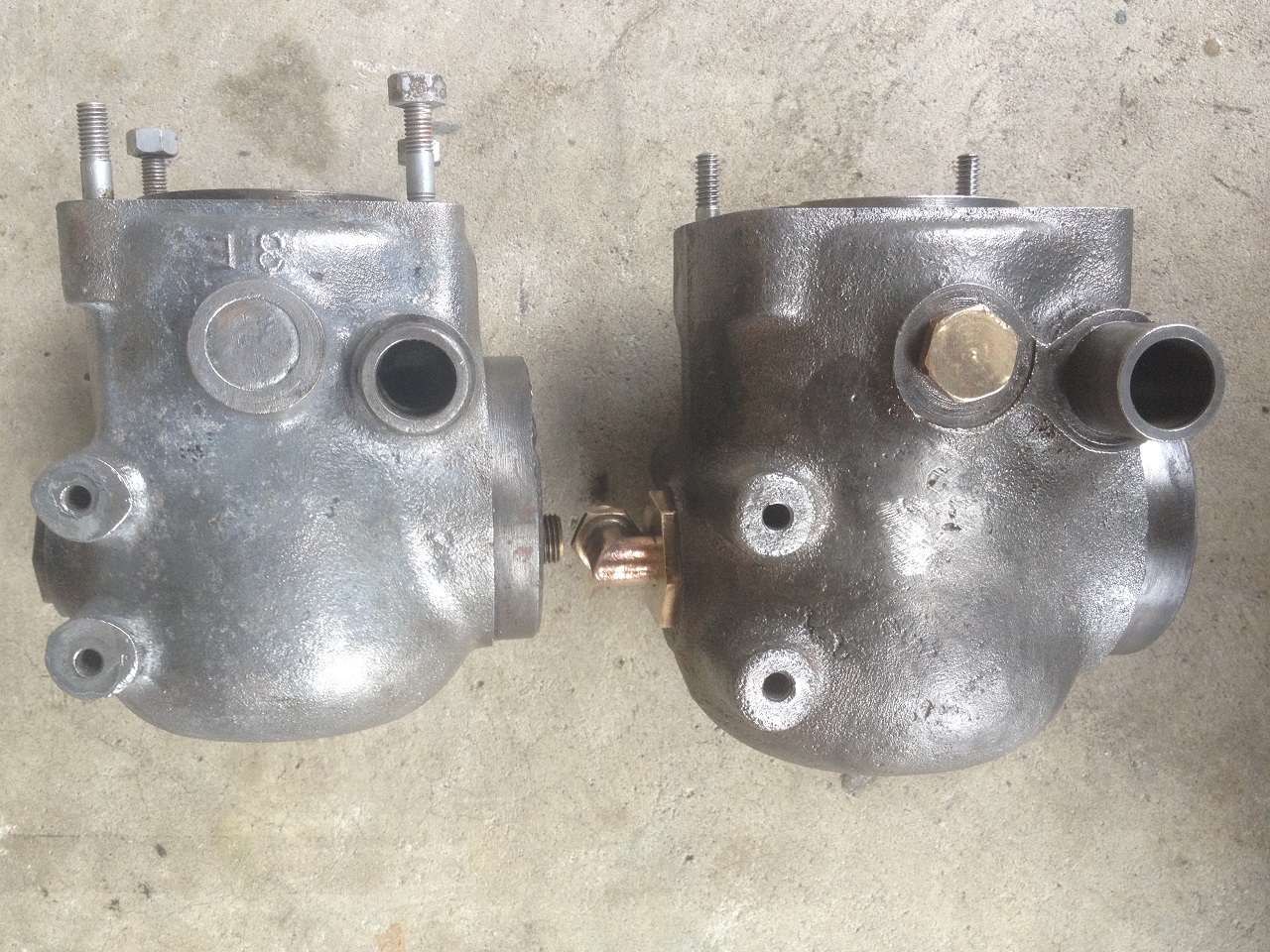

The cylinders appear almost identical externally. There are however some subtle differences in the castings to suggest those used by J.E. Barden may have been cast locally.
British Seagull AD 102 Left, Olympic Big 4 right.
The Olympic is fitted with Brass Hex Head core plugs for easier flushing of the cylinders as and when the need arises.
The British Seagull has a better spark plug recess, machined for better sealing.

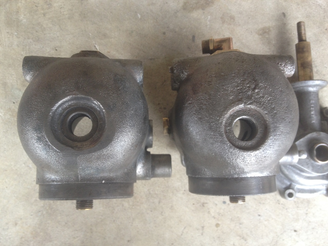

All ports in the Olympic feel larger. I will map these at next opportunity to provide a better comparison. Please excuse the poor picture quality.
British Seagull left, Olympic Big 4 right.

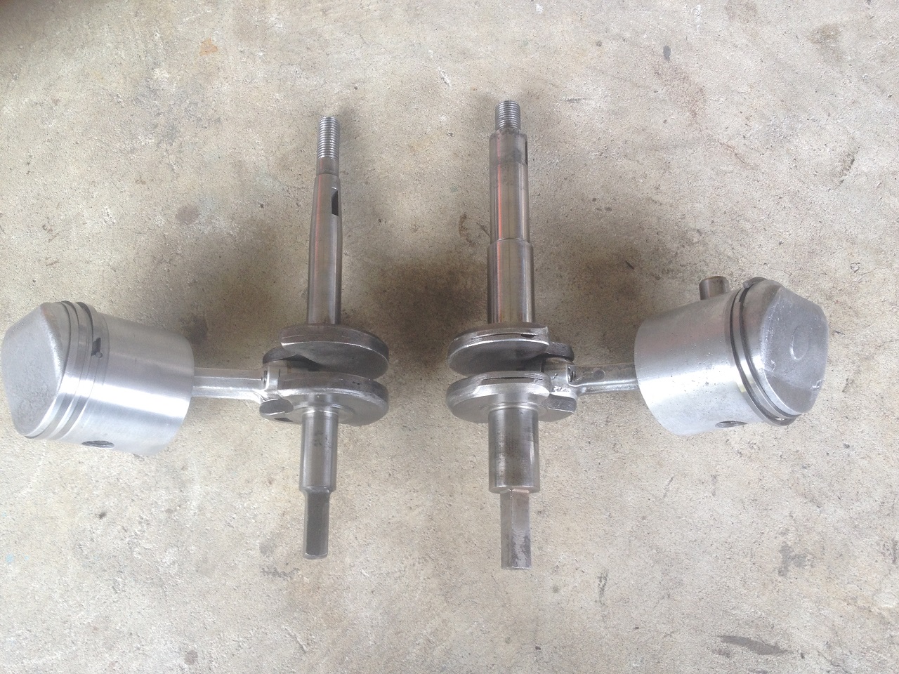

The crank in the Olympic Big 4 is much more substantial. The Bailey ignition comprises a crank mounted magnet and a chrome plated brass enclosed flywheel.

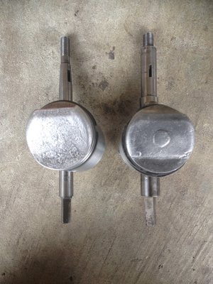

Pistons appear to be of the same dimensions. There are however sufficient differences to suggest those used in the Big 4 may have been cast locally. In addition, the gudgeon pins are closed at both ends via brass inserts.

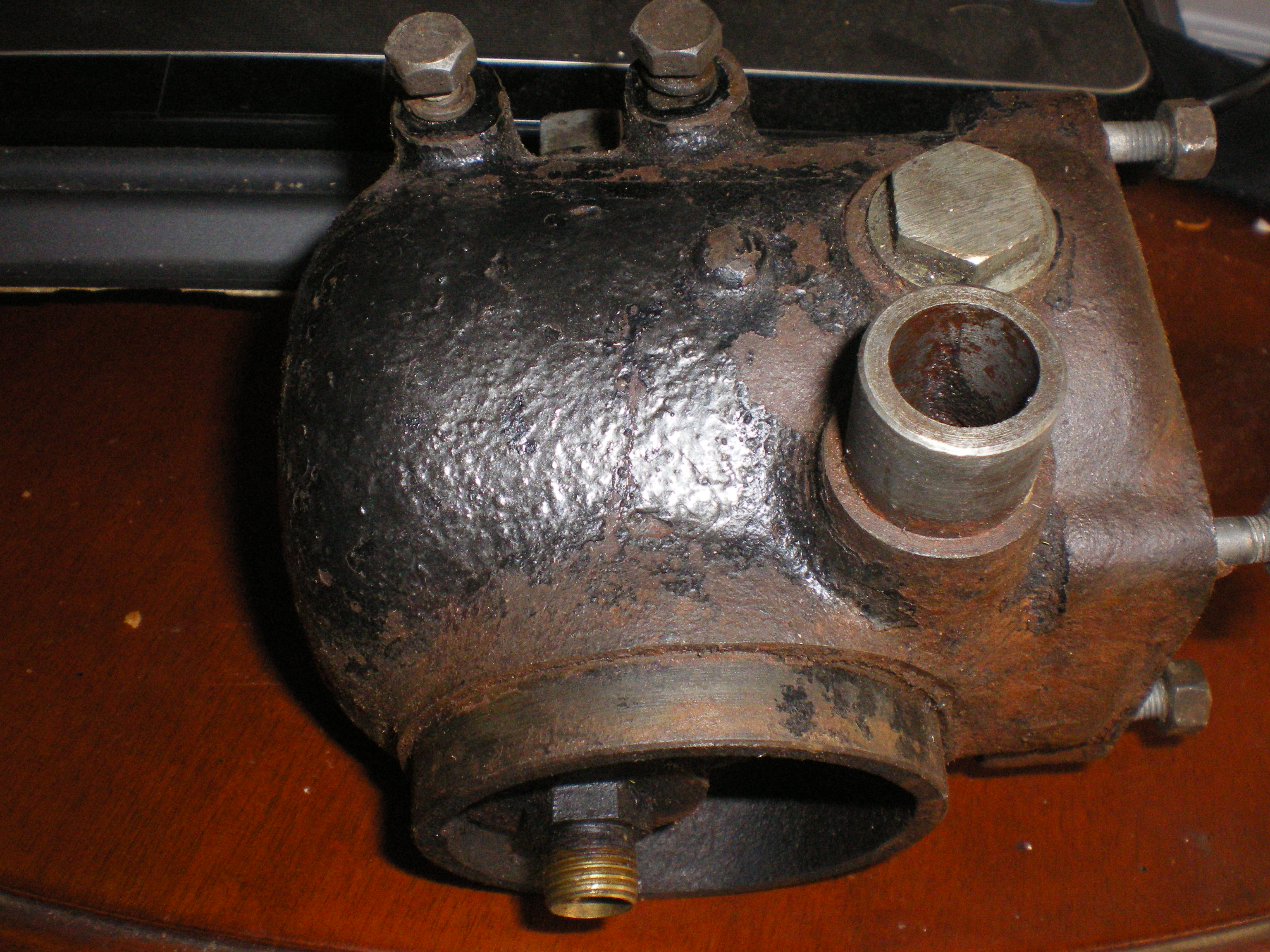

Brilliant! Actually the AD did come with a brass hex head core plugs and also slotted ones. Your AD barrel has probably been replaced. Wow, look at the size of your crank!

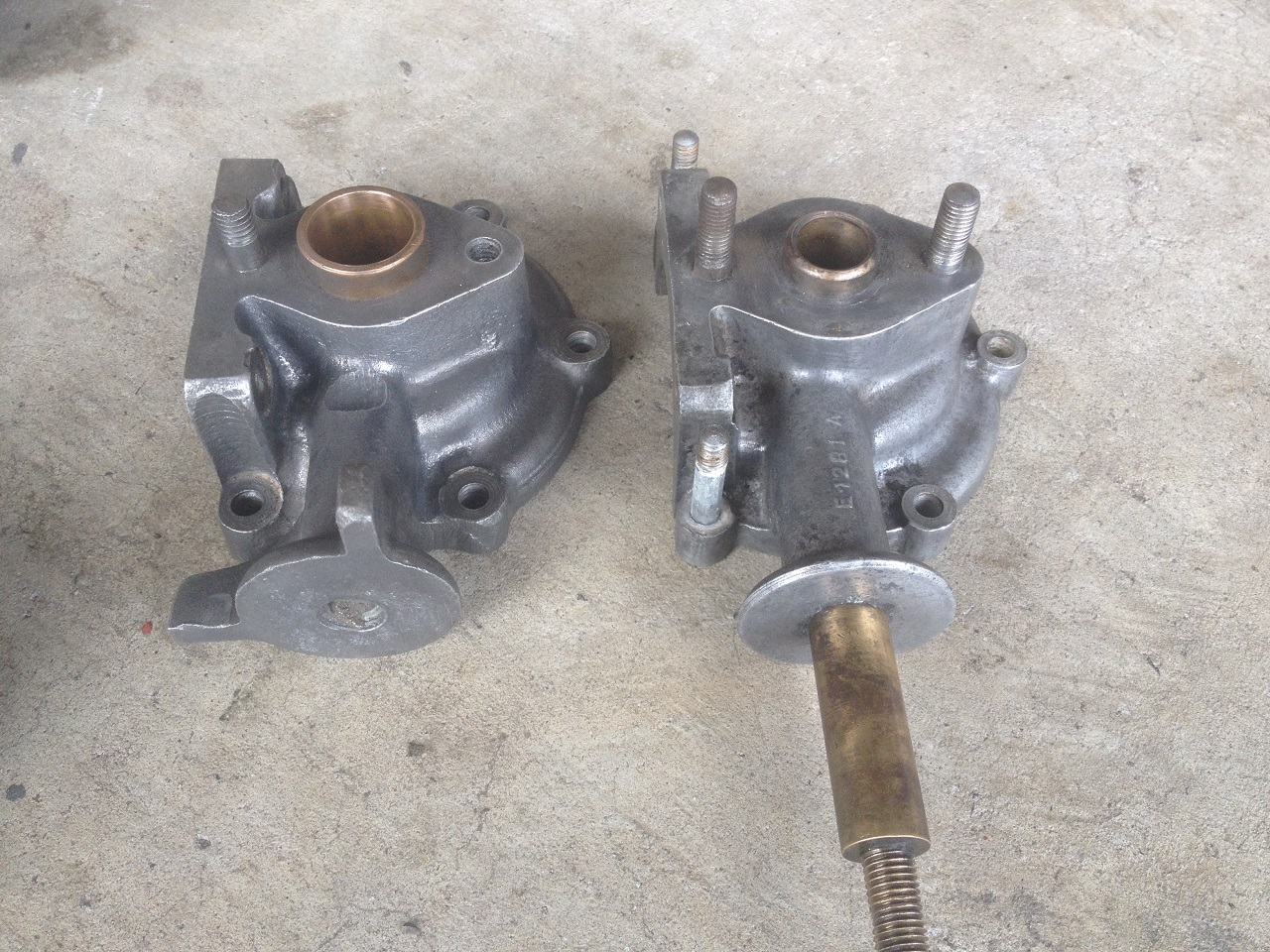

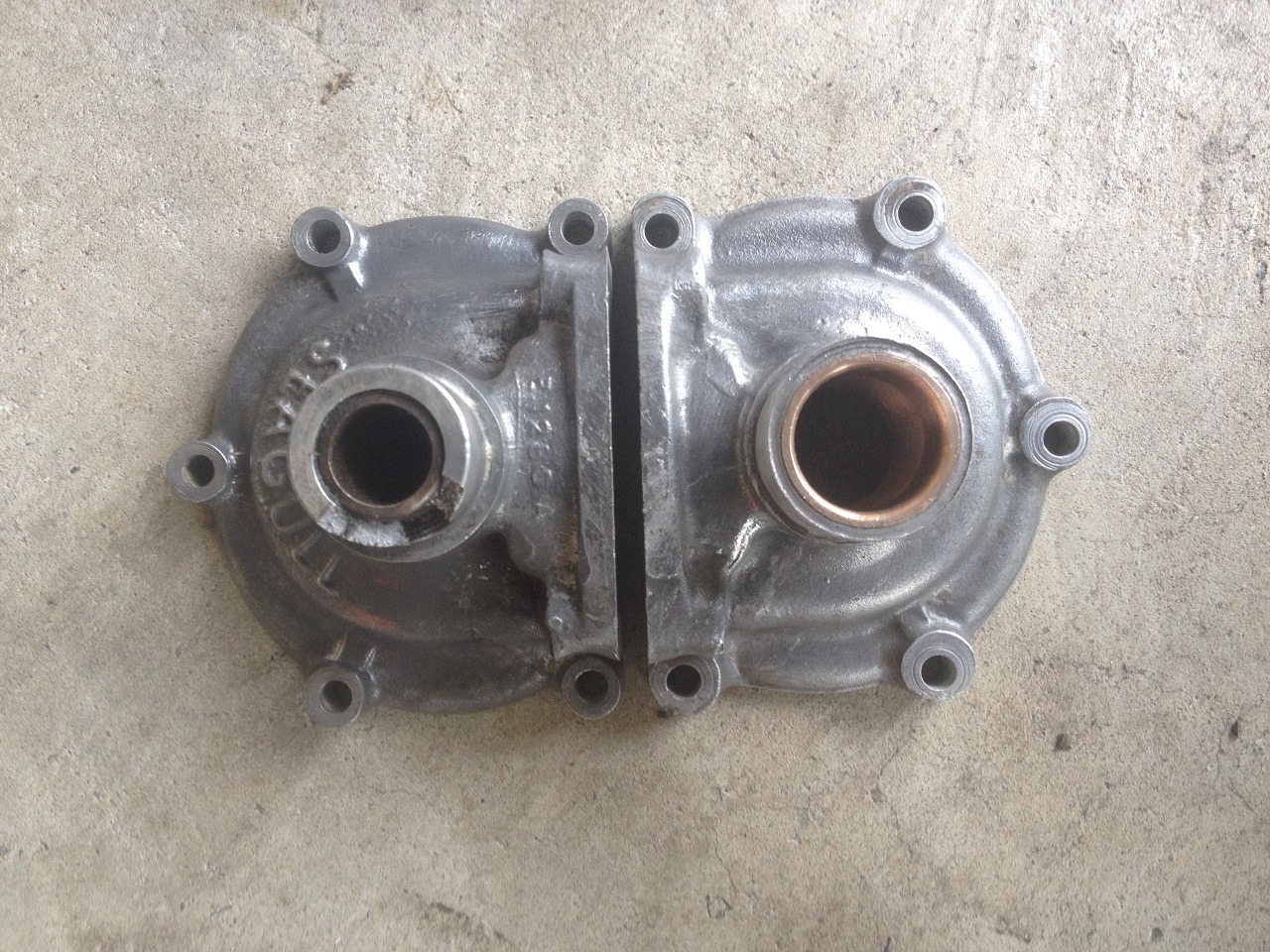

Crank cases are also very similar in appearance, with the most obvious difference being the bearing size and the end stops for the tiller. On closer inspection however, the castings particularly around the crank case bolts (studs) appear to be beafier on the Olympic Big 4.
Olympic Big 4 left, British Seagull AD 102 Right
British Seagull AD 102 left, Olympic Big 4 right.
Sorry to mix those up guys!
Plan now is to map cylinder ports and compare all other significant dimensions ie before moving on to the gearbox and water pump housings etc.
More to follow in due course.

Very interesting Hugo. I've seen the slotted brass core plugs on early Seagulls before, but never the Hex. Always learning something new!Hugz wrote:Brilliant! Actually the AD did come with a brass hex head core plugs and also slotted ones. Your AD barrel has probably been replaced. Wow, look at the size of your crank!
