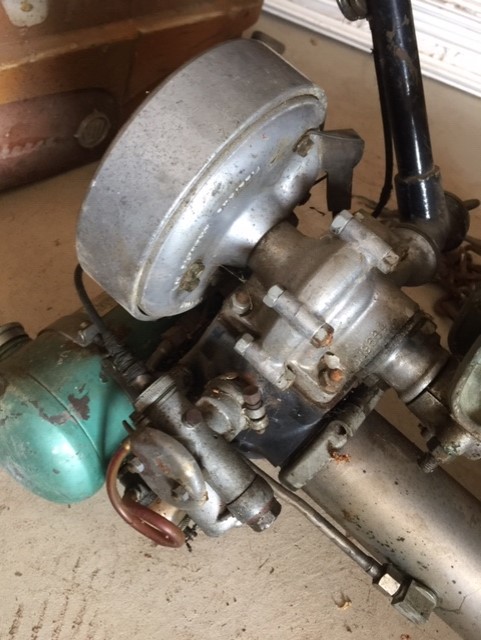

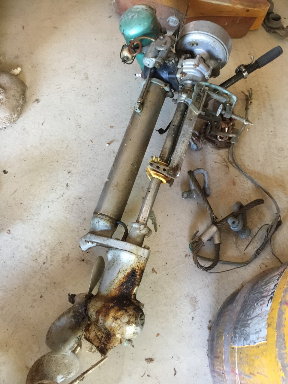

Another Australian Olympic has turned up in Oz, this one in Lilydale VIC, engine number '450'.
The vendor is the daughter of the original owner (now deceased) and is looking for a good home for his two motors.
The other, with the broken gearbox fin, is a British Seagull AD19664.
The two motors have swapped some parts, with the green-painted tank, glassbowl fuel filter, carburettor and probably throttle cable and throttle mechanism from the Olympic at present on the Seagull.
You'll note the Olympic (with black Seagull tank) has the typical Olympic carry handle, and in one pic you can clearly see the cavitation plate evident on the gearbox that was typical of Olympics.
Thanks to Bruce (collectorinspector) for the above ID. At first blush I just assumed it was an owner-painted Seagull. Doh.
Have advised the vendor it's worth around $350-400 in this condition. Anyone local in VIC wants it, let me know and I'll put you in touch.

Nice find!
However with most advertised in recent times in the $100 to $150 range, I would think that runner in very nice original condition would be worth $250 at best. I'm not quite seeing that here, but it may just be the photos!
I sincerely hope you haven't set the owner up for disappointment.
It is located within half hour from me. I would love to see it and be able to make a decent offer, but am concerned that their expectations now are very unrealistic.

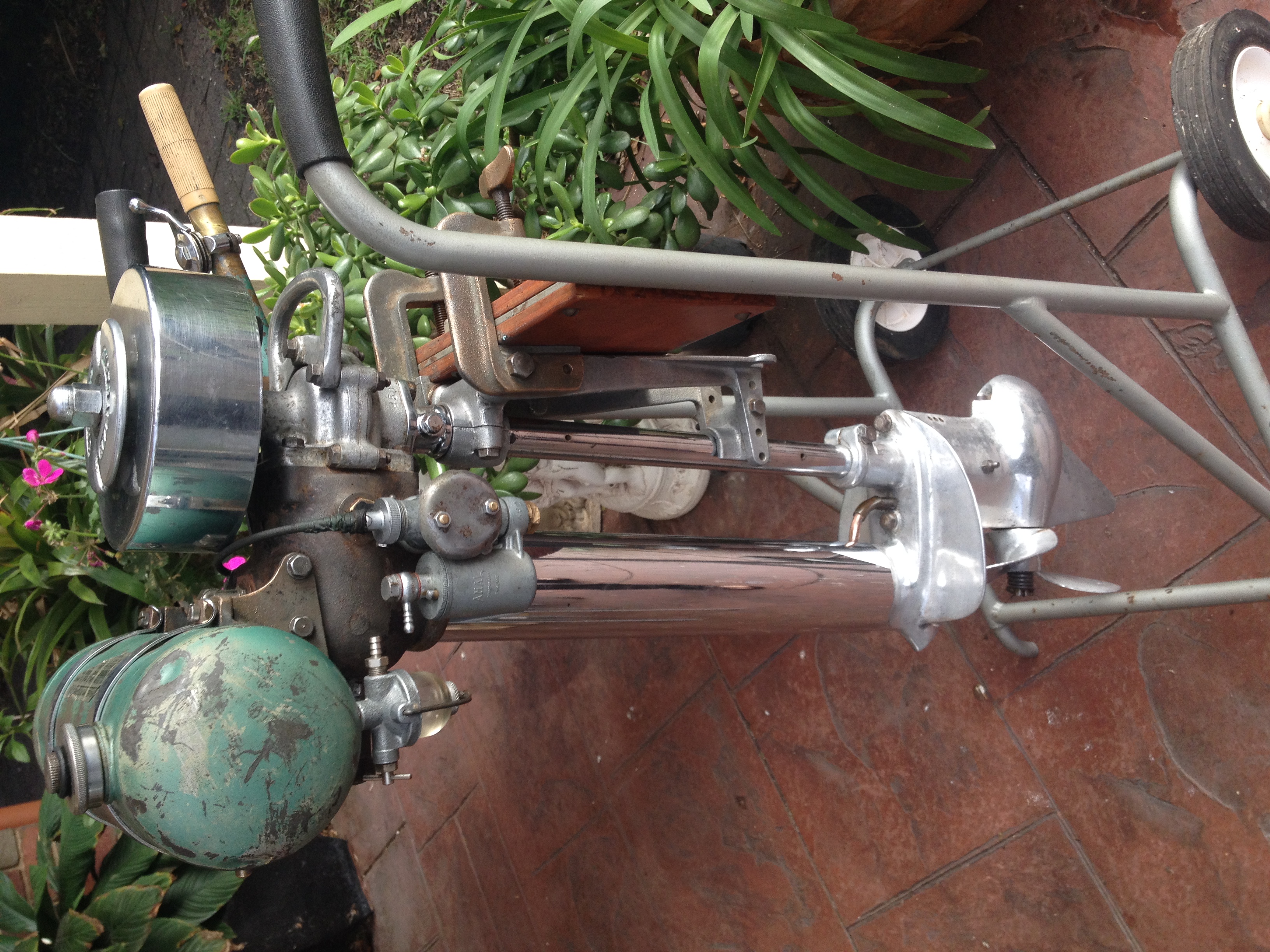

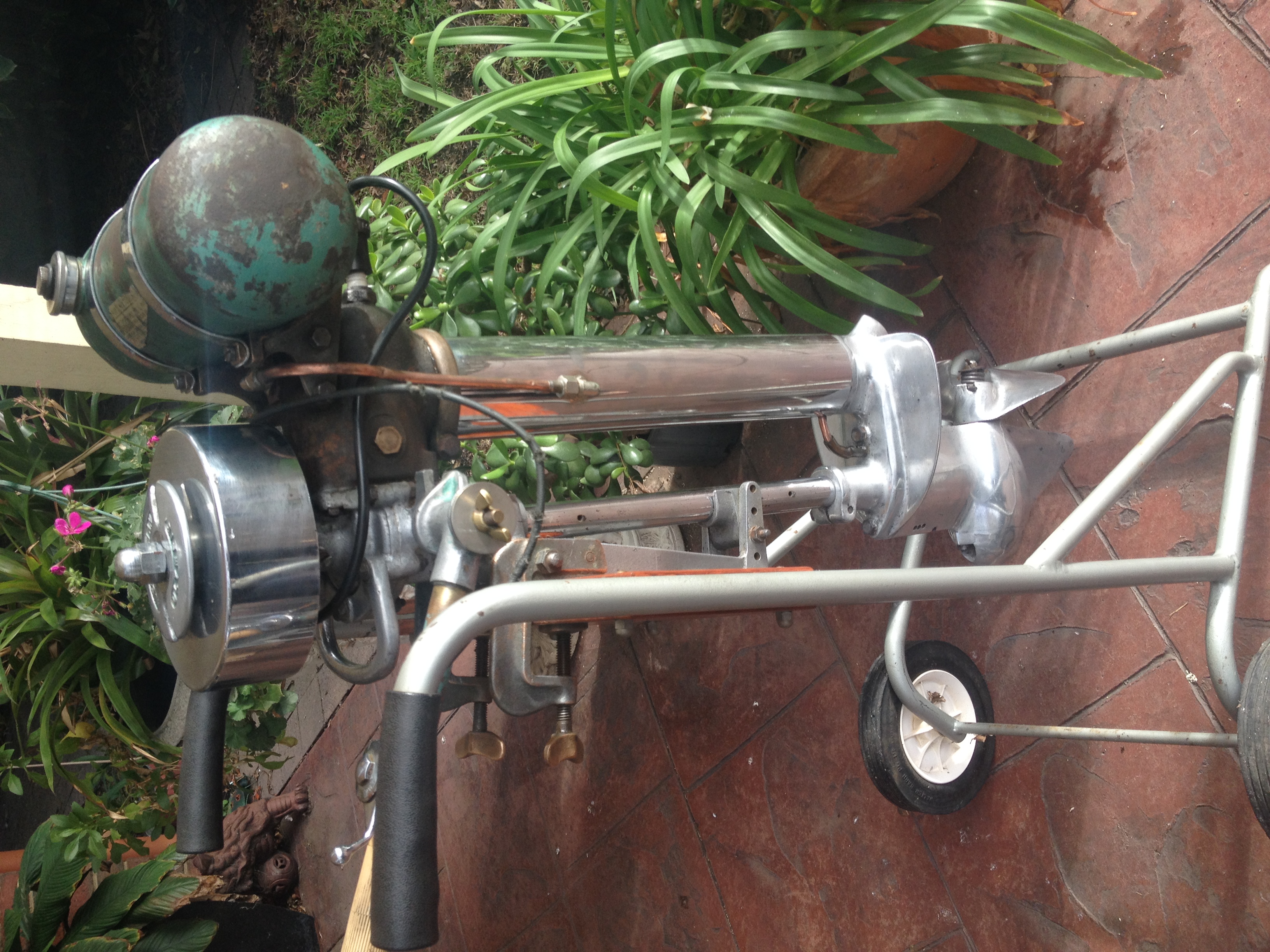

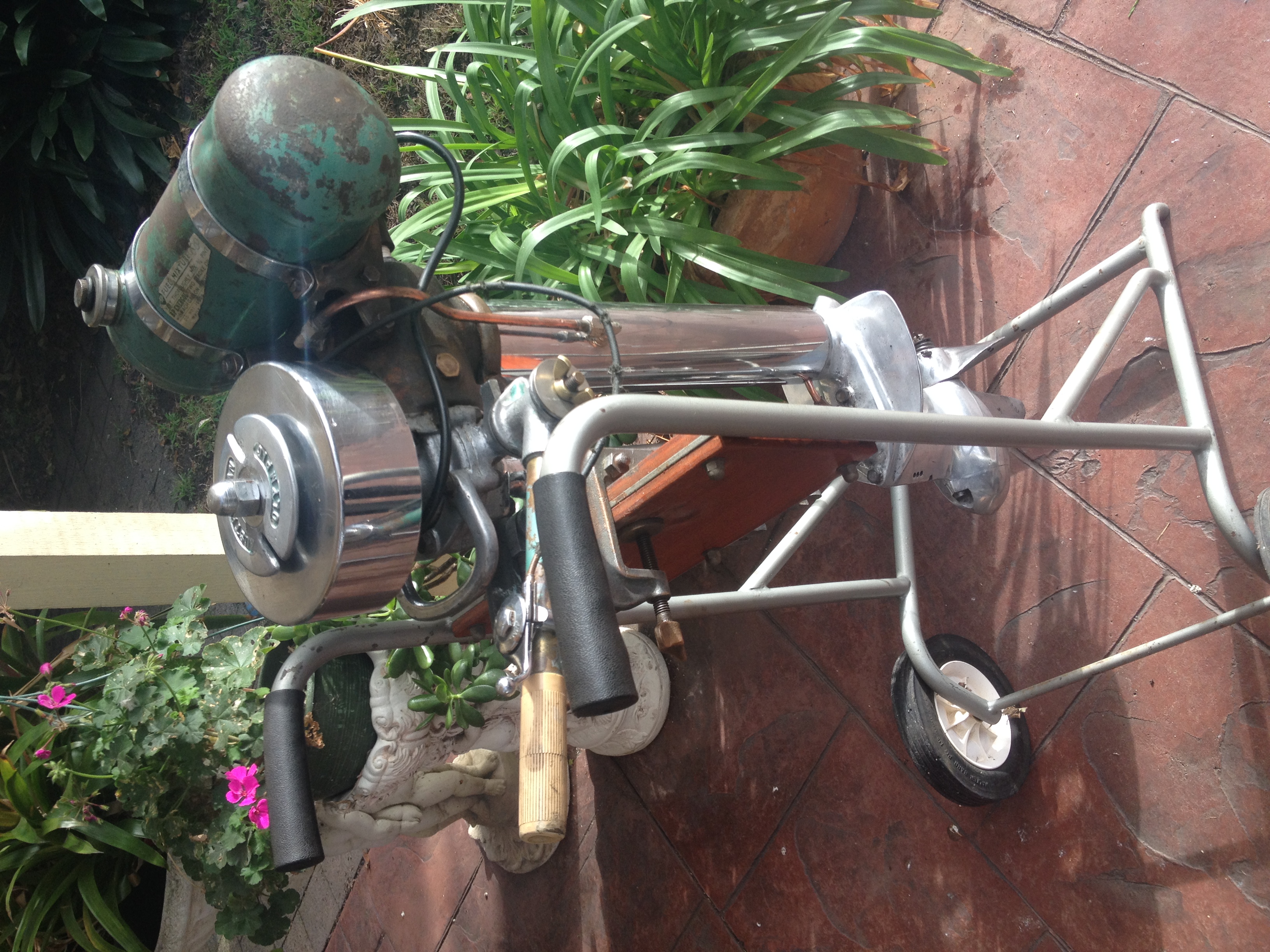

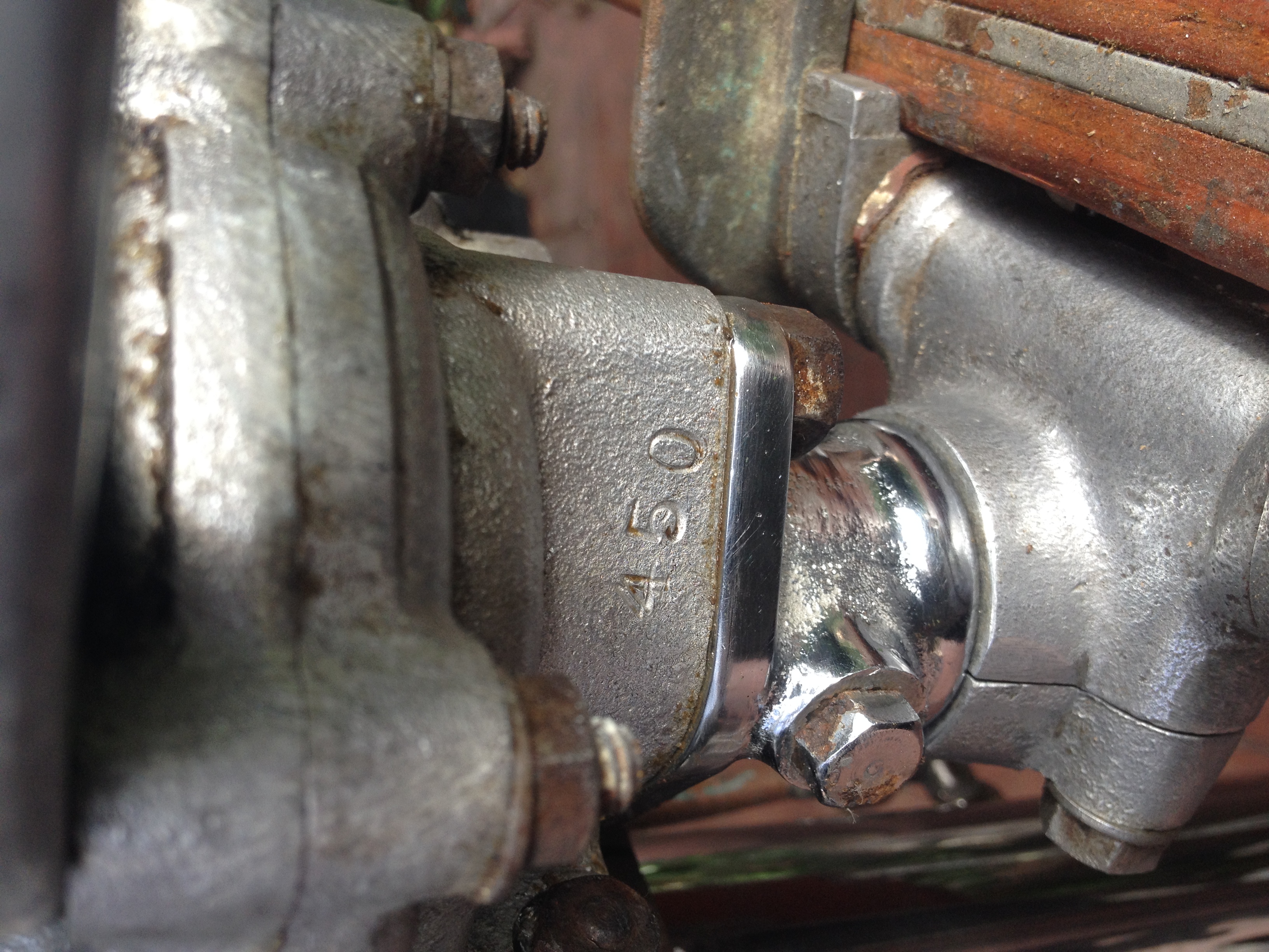

Just sharing some pics of Olympic # 450 after a clean up by its previous owners.
I am also happy to say it is now part of my collection.
Re: Australian Olympic vs British Seagull AD102
It is in great condition for its age, turns over smoothly, has a heap of compression and a healthy spark.
The chrome and aluminium are in really nice condition with only minimal rust and oxidisation.
The tank brackets and transom clamps have lost their original nickel plating, so I plan to get those redone soon. I'll have the tank straps cleaned up at the same time, and will repair and repaint the tank, tiller and cylinder to bring it back to as near as possible ex-factory condition. Along the way, it will also receive a new throttle cable and fuel hose which is currently missing.
Being a more recent build than those mentioned earlier in this thread, # 450 features the cavitation plate water-pump/exhaust housing and is a nice addition to the collection.
More pics down the track.
