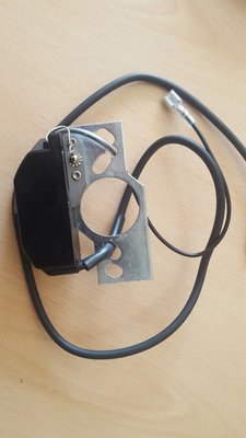

So the stop switch is something to do with grounding the signal to the CDi right? Make with the science dude. Yep, the module I referred to has the requisite wire.

Re: Forty Feather
Mk4 CDi module
Mk3&4 nut, washer, pulley, spacer
Mk4 module with extra wire

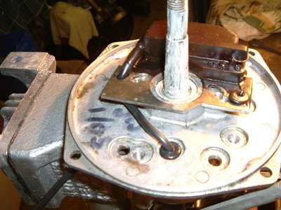

If you put your motor back together with that wire hanging through one of the holes in the base plate, start it & see what happens when you earth that cable on the motor.

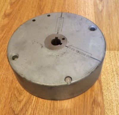

Your picture of the Mk4 flywheel & spacer is missing the locking pin that fits in both holes to stop the spacer spinning when the recoil is pulled, between the starter cup & spacer they rely on the aluminium binding under the nut pressure.

I think the lanyard idea is the best course of action. get us a picture of the flywheel rim & I'll be able to tell you if this is an easy job that only requires a switch that costs less than £10 from Ebay, just ensure it's waterproof.
If you have any doubts about the reason why, next time your out in your Seagull boat sit down & let go of the tiller at full throttle!
Give your flywheel taper interface a small squirt of WD40 or the like, this will involve removing the nut, starter cup & spacer, & follow Seagull's instructions on how to remove the flywheel, it's not usually a drama 9 out of 10 times, Just make sure the hammer hits the nut firmly & dead square, it's probably better that the 4 hands doing this are male!
I know I've got a reconditioned Mk3 with a stop button in storage I'll try & get a picture this afternoon.

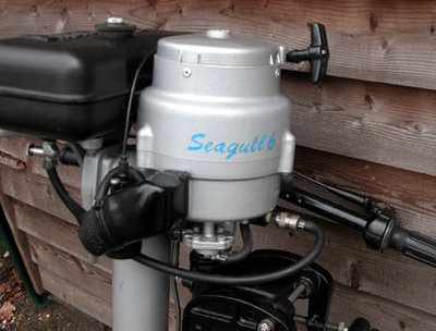

I already have the lanyard kill switch, but must admit to being a bit of a dexter, the tiller will probably get removed as not needed, the engine will be fixed in straight position, as my trident has a rudder fitted on the rear with foot controls for turning, I may even be able to set a lanyard onto the throttle, so it can be set at a pre determined speed and let go off, but still cut out if I leave the kayak unexpectedlyCharles uk wrote: If you have any doubts about the reason why, next time your out in your Seagull boat sit down & let go of the tiller at full throttle!

Just had a dexter thought which I'll try out first, as I'm sure if I was to fall out, it'll be from opposite side to the seagull, as the seagull side will also have an outrigger,
So my cheap easier cut out, will be to drill the knob on end of throttle, and place a ring with lanyard attached to me, still keep both hands free and original fittings
