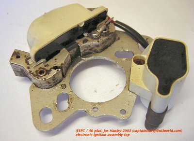

Mk3 CDi module
Mk4 CDi module

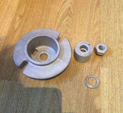

Mk3&4 nut, washer, pulley, spacer
Mk4 module with extra wire
Mk4 Flywheel

If you put your motor back together with that wire hanging through one of the holes in the base plate, start it & see what happens when you earth that cable on the motor.
Your picture of the Mk4 flywheel & spacer is missing the locking pin that fits in both holes to stop the spacer spinning when the recoil is pulled, between the starter cup & spacer they rely on the aluminium binding under the nut pressure.
