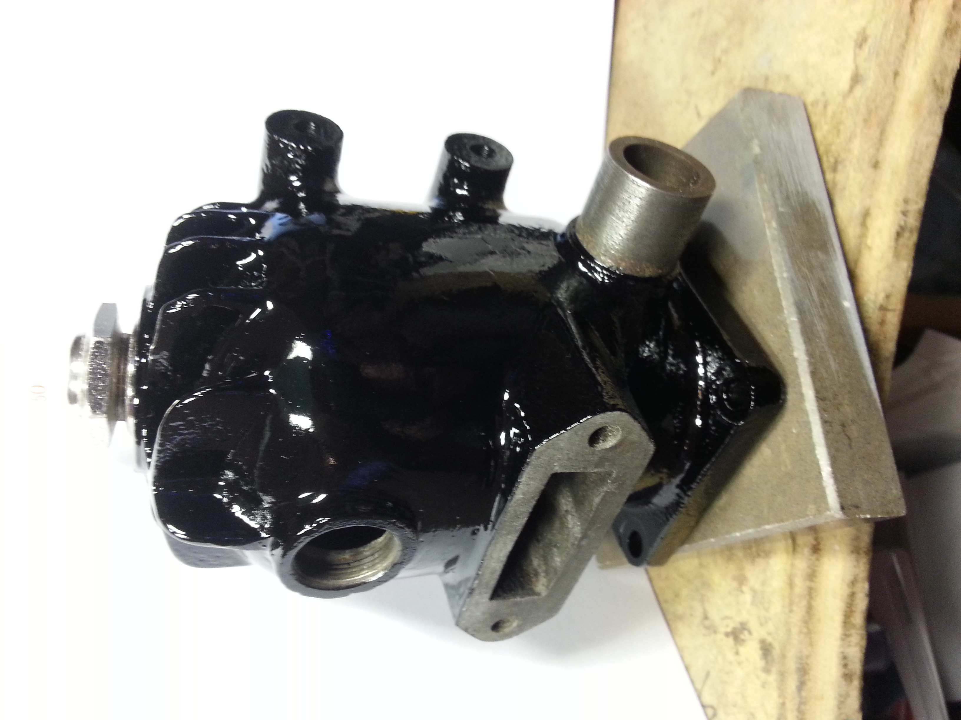

The gloss and satin "Simoniz Tough" are all that I have used for the last few years, appears to be petrol resistant, and gives a good finish.
I used it on this cylinder.

How does the paint stand up to temperature H-A being as this is a cylinder?

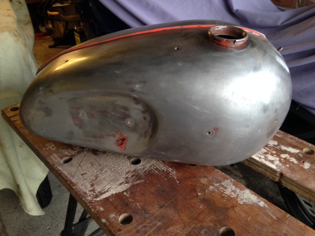

Yes, I've used it to do the headlight nacelle, it's the petrol tank next..spent the last 2 days stipping off about 8 layers of old paint
Horrible job.After all this prep I don't want to piant it and then find the paint ruined by a drop of petrol!

Yes I have emailed a couple of local specialists for a price. With me doing the prep it won't be too expensive. A poor paint job on the tank will let the rest of the bike down!
