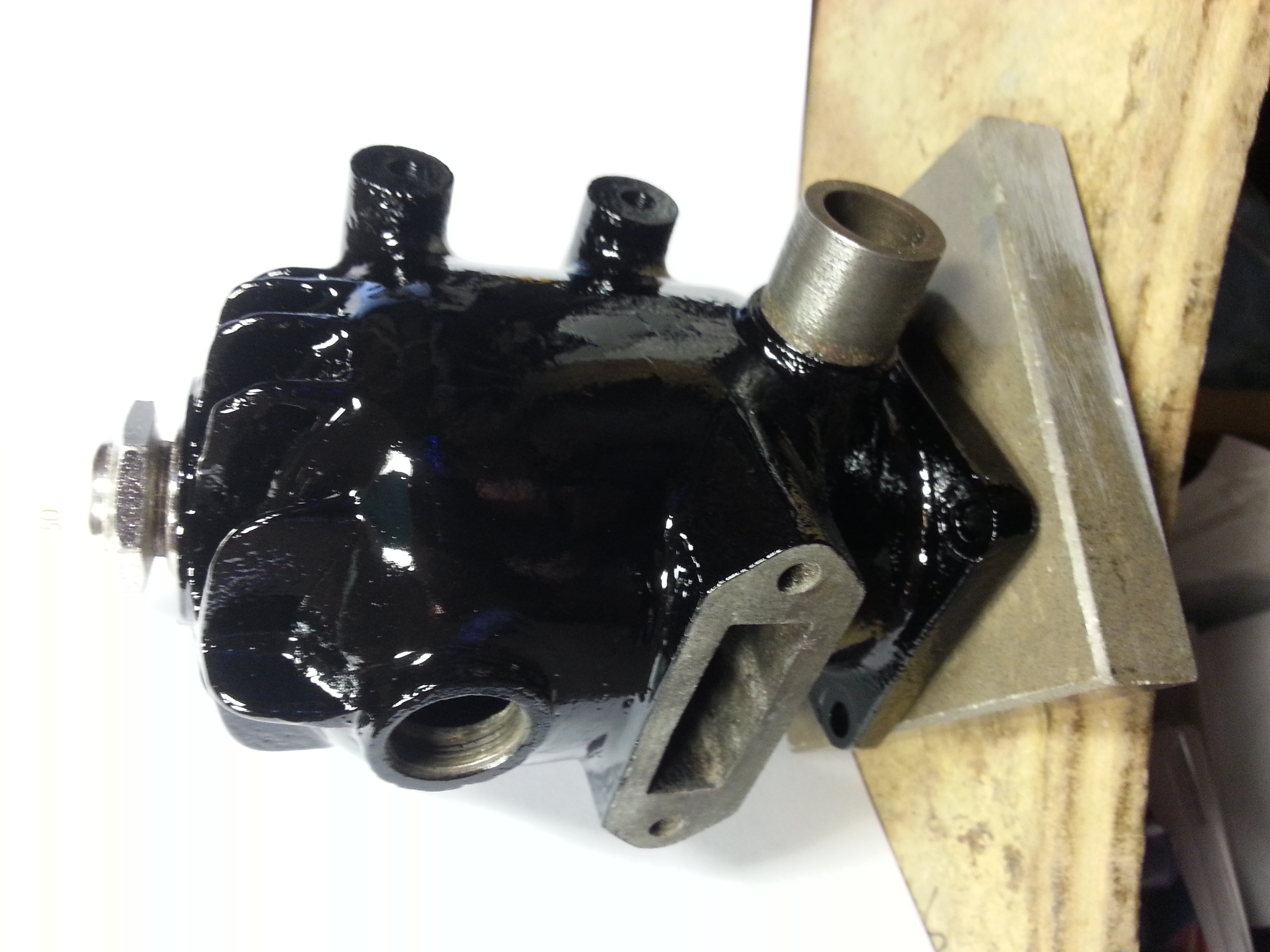

The gloss and satin "Simoniz Tough" are all that I have used for the last few years, appears to be petrol resistant, and gives a good finish.
I used it on this cylinder.

How does the paint stand up to temperature H-A being as this is a cylinder?

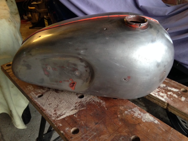

Yes, I've used it to do the headlight nacelle, it's the petrol tank next..spent the last 2 days stipping off about 8 layers of old paint   Horrible job.After all this prep I don't want to piant it and then find the paint ruined by a drop of petrol!
  Horrible job.After all this prep I don't want to piant it and then find the paint ruined by a drop of petrol!-

For a bike tank I would go with 2K, or if you are worried about toxicity then use Cellulose.
http://www.ebay.co.uk/itm/1L-Cellulose- ... SwLVZVwalt.
Cellulose is a bit softer when dry but easyier to apply and polish.
Could be easier to pop down the local sprayers and get them to base and clear it, if you dont have access to the kit.

Yes I have emailed a couple of local specialists for a price. With me doing the prep it won't be too expensive. A poor paint job on the tank will let the rest of the bike down!
