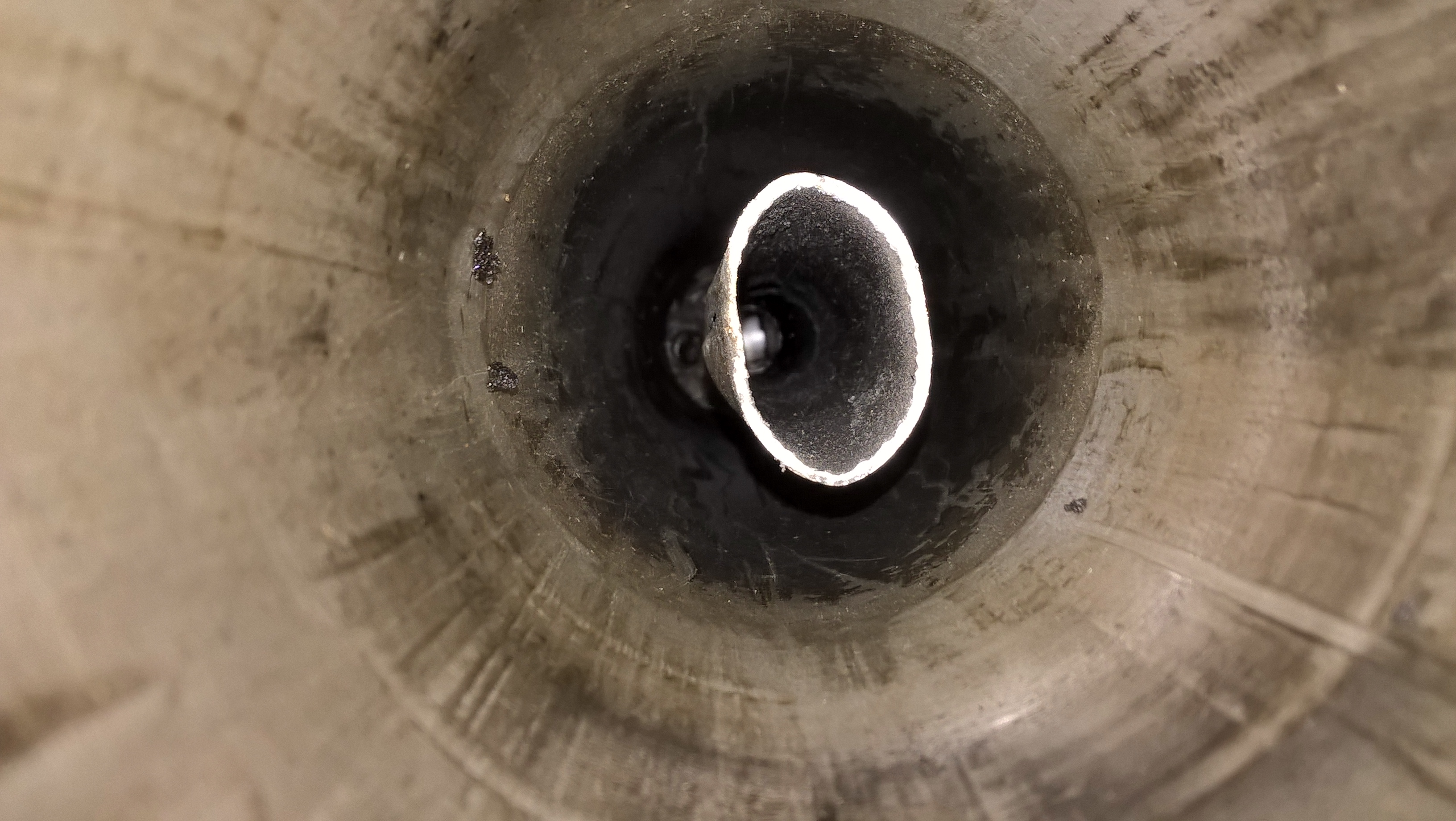

I managed to get the inner and outer exhaust off today. Just want to let you know how it worked. I started on the suggestion of Charles. I got the power head less flywheel and flywheel housing and tank on a jig. The idea was to wiggle the exhaust off. The exhaust was to stubborn for this gentile treatment. Off with the cylinder (H-A). Head removed. Produced two wooden parts to protect the upper and lower end of the cylinder an tried a second jig. The clamps were to flexible so that did not work. Up to a large vice. I inserted a wooden log in the outer exhaust to get more leverage and a good surface to hammer against with a wooden mallet. No movement. A week of wd 40 followed. I saw that by using an extension (1/4 inch) on a socket wrench I just managed to unscrew the nuts which hold the inner exhaust to the cylinder. Then back to the vice, liberal heat and a lot of hammering finally persuaded The inner an outer exhaust to move a little. Finally holding exhaust to a wooden beam and hammering against the underside of the cylinder (plastic hammer) and quite some heat again did the trick. The pictures below tells the story. Many thanks for the suggestions.
