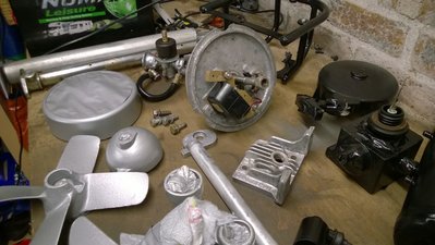

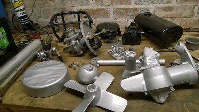

Hi... These are some pics with the engine in bits so you can see what parts I used.

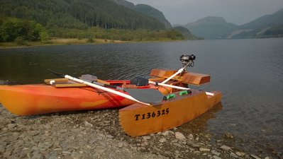

Now then that's an interesting craft you have there!
can see two fuel cans sticking up out of the outrigger.good for exploring eh but do watch out for those very big Calmac ferrys wont you
They will have a Big job seeing you!...It was scary enough in my yacht when they are bearing down on you at speed!

Calmac Ferries! HaHa... I thought it was just me. The other year they nearly run me down in the sound of Kerrera so I got myself a VHF radio license (T136325).
The extra fuel tanks are when I get the courage to go for the outer Hebrides or maybe even St. Kilda! one day.
