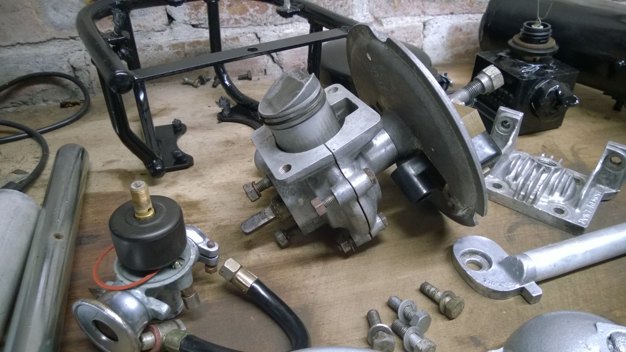

Post a few pictures so we can see what it looks like, makes diagnosis easier, ignition type etc.

Hi... These are some pics with the engine in bits so you can see what parts I used.
