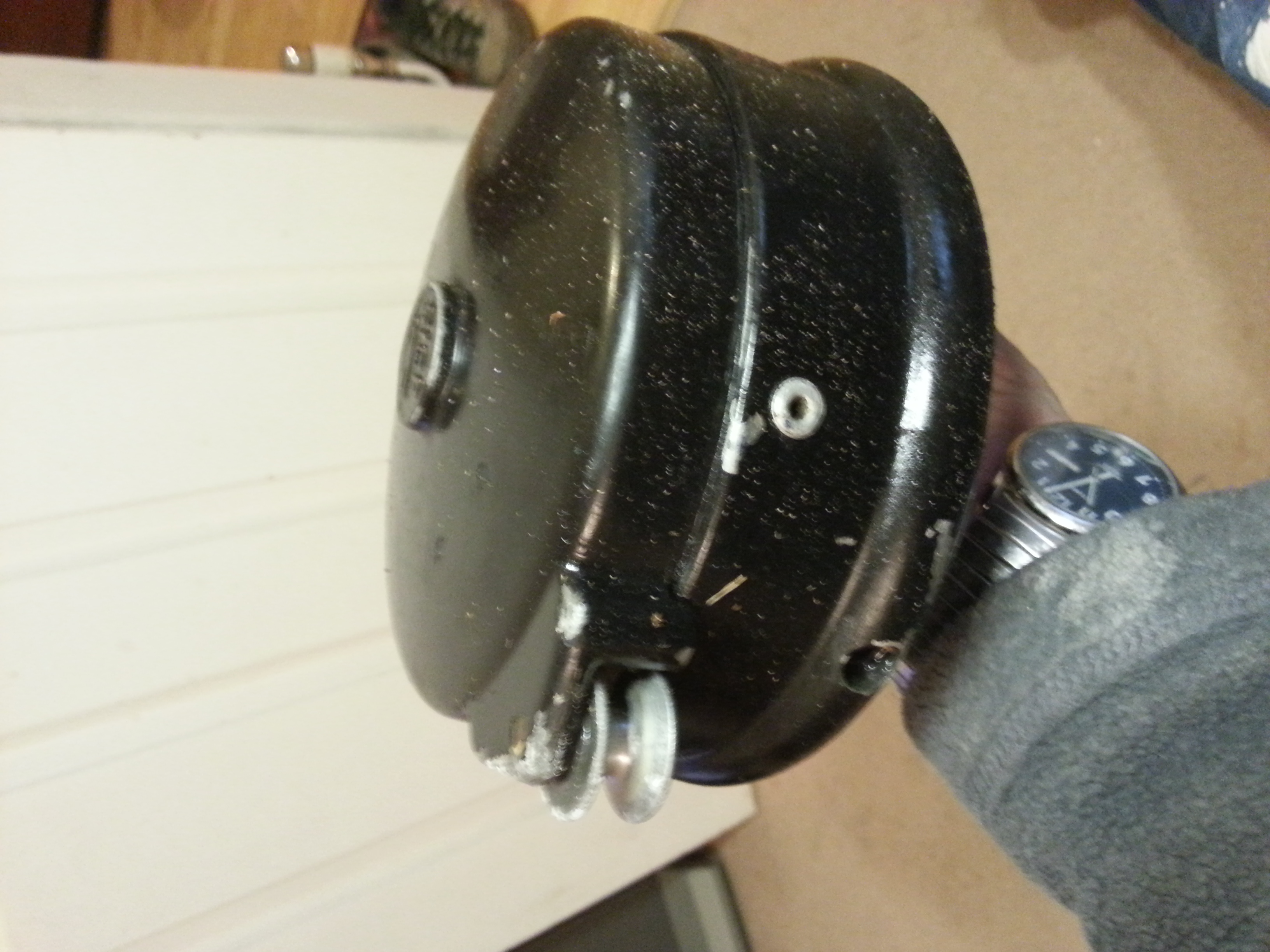

Do you have any idea how to get the pull starter unit off.
The handbook shows two screws. I have two empty holes.
And the starter don't engage for the first foot of cord so something is amiss.
Re: New plug cap for CDI engine
THCL500J8 wrote:Thanks both of you,
Block of hard wood and a hammer.
Hit under the raised edge where the 2 screws are located, ali on ali corrosion locks them solid.
This is the bit that comes off.

Yep, done, tapped it off as you said, nice ring of corrosion all the way around. Have replaced the rivets, with large pop rivets. there weren't any in it. And resembled the starter as per the picture in the service sheets. works a treat. I guess at some stage someone tried to fix the starter.But is done now so thanks all.
