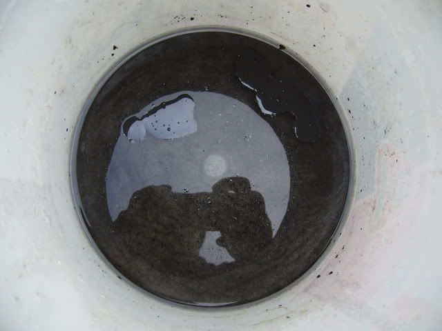

I unscrewed the plastic cap and I started to feel a very strong smell of rotten eggs come from the interior of the foot;
I poured the contents into a bucket e. .. Horror!
It came out smelling water and a few drops of a dense black liquid that resembles crude oil.
Here's the photo.
I proceeded to restore the proper oil level with the W140 and I closed the lid.
If the engine starts I would like to make it run a bit of time in the bin and then change again to be sure the oil of the foot, what do you think I do well?
