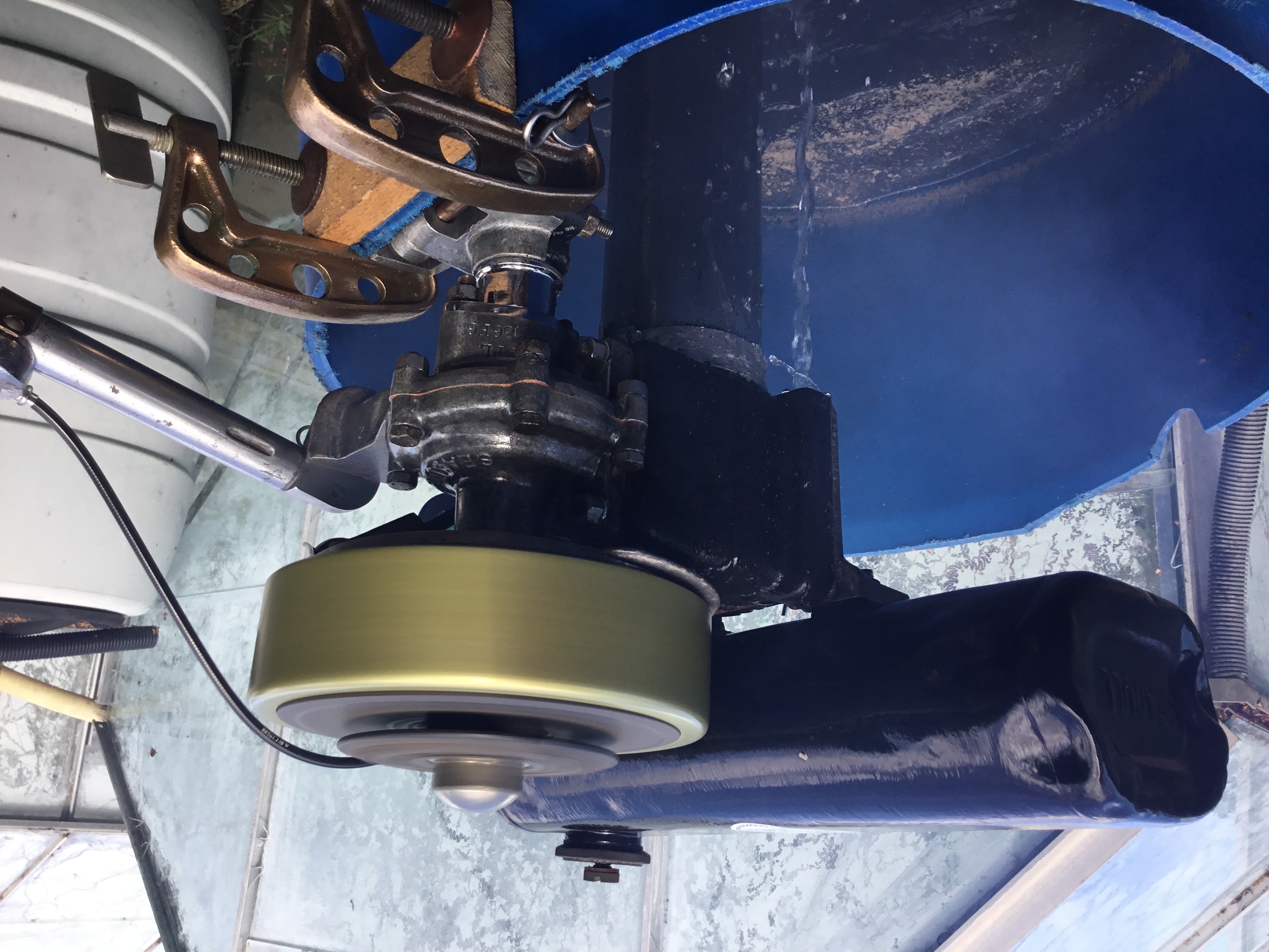

Good news, the motor is now running. I put the old ignition coil in and it fired up without any problem. I thought the old coil was duff but it has enough zap to run. I ran it in a barrel with the propellor removed. Sorry the pic is inverted, but if you click on it then it shows the right way up.
