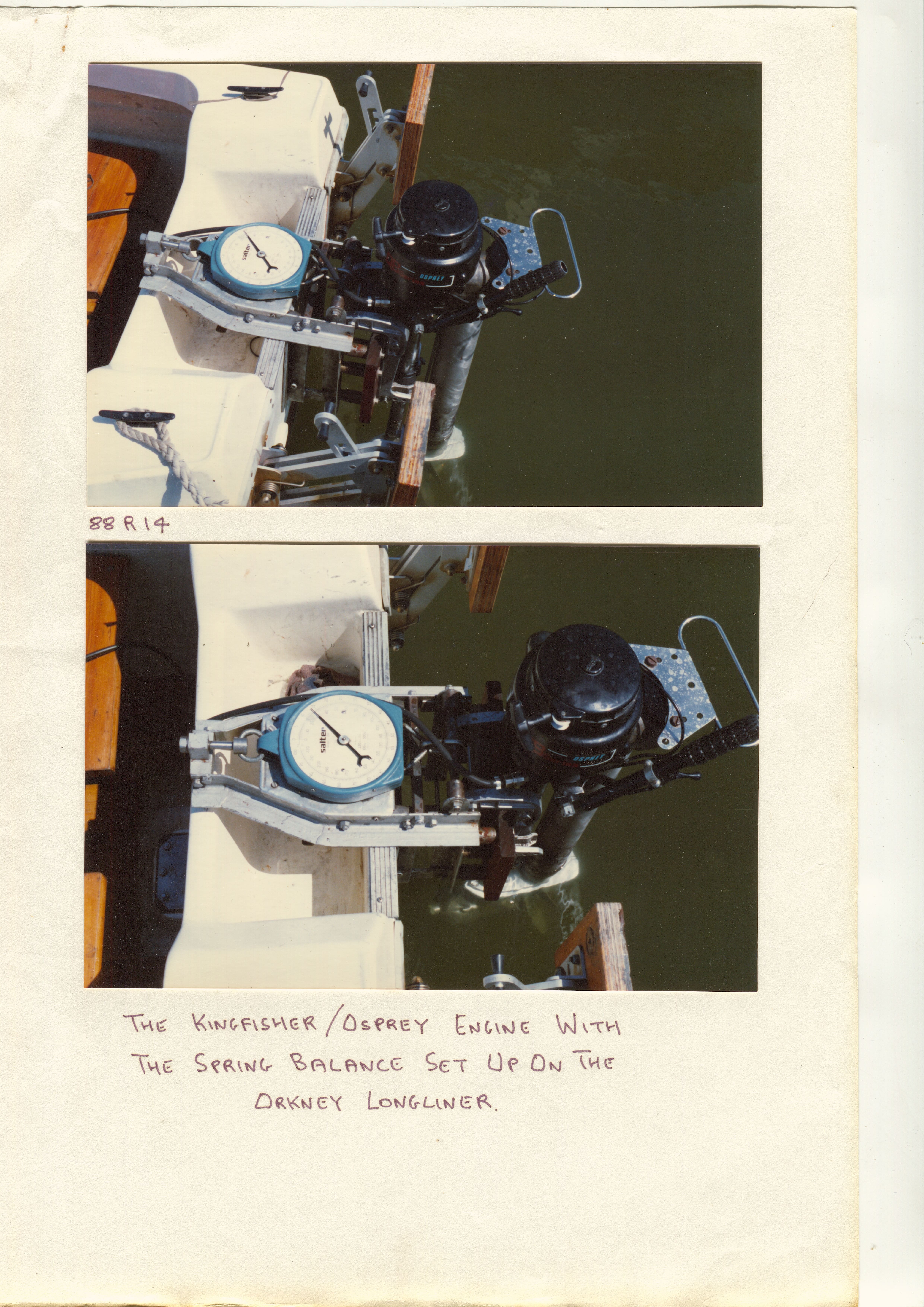

Yes Seagull did, but not a static bollard pull, they had in the late 1980's a transom bracket with a set of scales built into it, so they could measure the thrust at the higher revs when under way.
Which was higher than the static bollard pull & more representative of the results that a customer could expect.

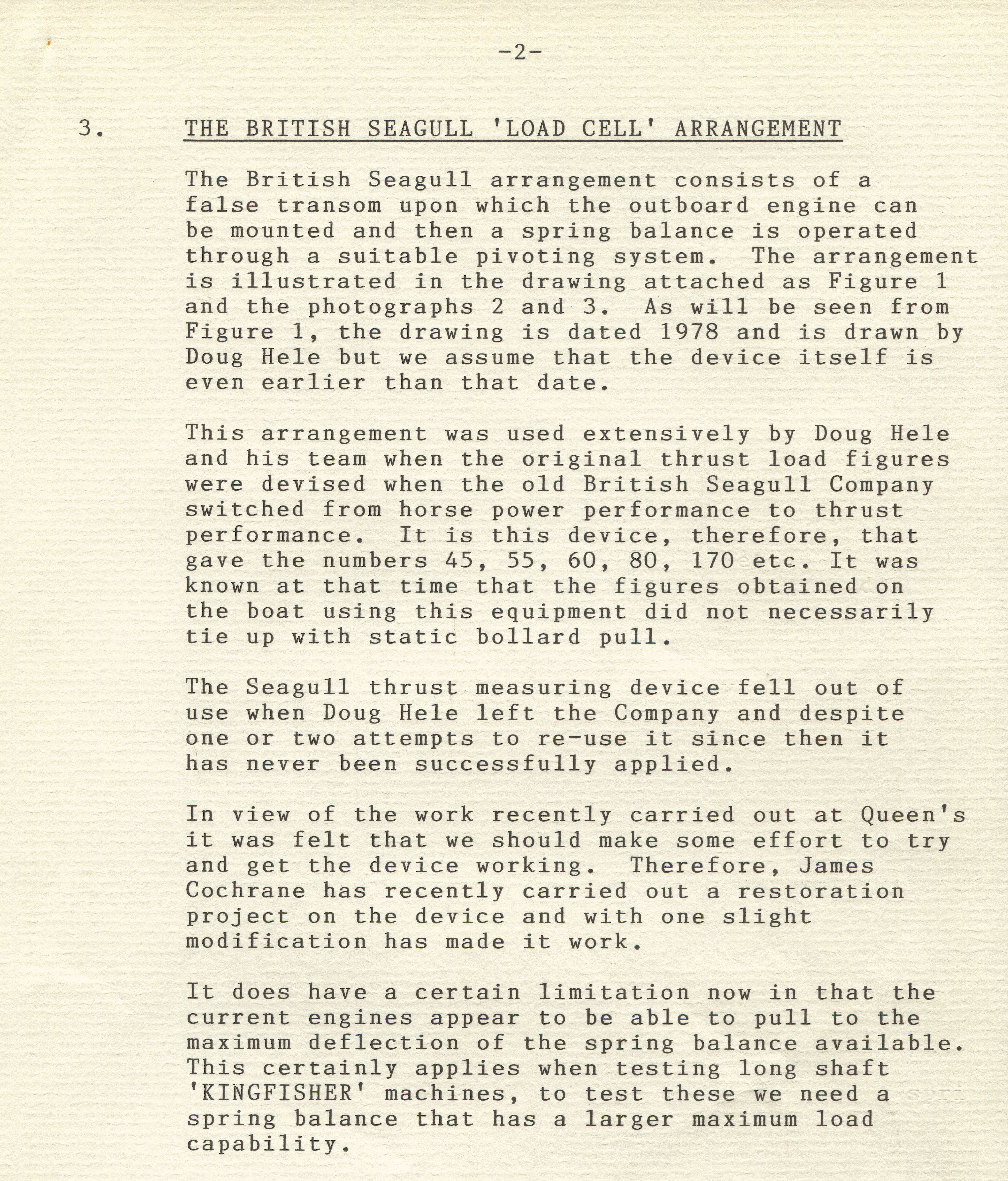

Perhaps the above might explain better what I'm trying to say, it was taken from a Seagull technical report S87 dated (01.09.88) unfortunately Doug Hele passed away some time ago, so it's no longer possible to pick his brain on the subject.
He was the gentleman responsible for the initial design of the 170/125 family & if you look him up on the net you can check his pedigree!

Thank you for sharing the interesting old document.
It says that there is a difference between results of bollard pull and of moving boat test. Unfortunately it does not say in which direction is dhe difference.

No comparison figures in that tech report only push in newtons!
You can't help wondering why they didn't try a height adjusting bracket for the long shaft Kingfisher, if they could measure a short shaft Kingfisher without major problems?
