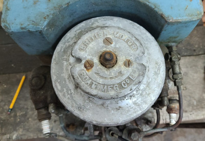

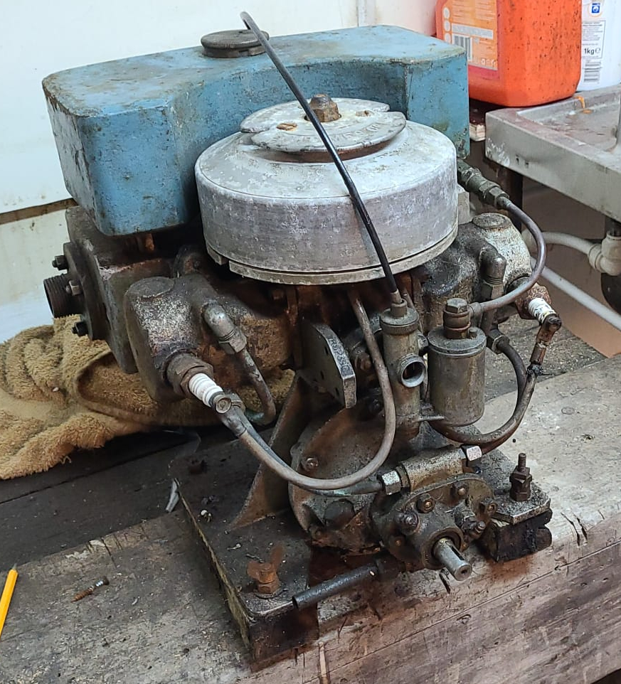

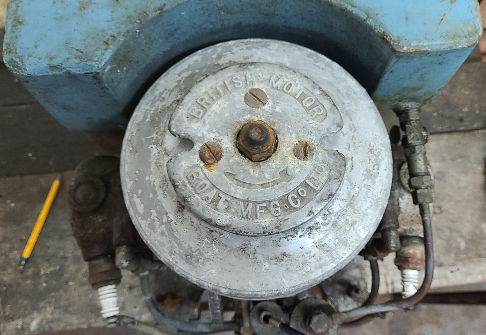

I have just acquired a genuine 'barn find' aluminium 12' boat which I estimate dates from the immediate post-war era. It still has a 1974 river licence disc which I suspect was the last time it got wet!
It's fitted with what I believe is a B.M.B. Mariner inboard with a direct drive coupled to a shaft and a feathering prop arrangement for selecting forward/reverse. The tiller is a curious, side-mounted arm that folds down inside the boat when not in use and up to the horizontal to provide a 'push for port, pull for stbd' steering arrangement.
After reading some very informative threads on this forum I've found that I need to get the 'Twin Spark' coil rewound but hopefully that is all that needs doing. The engine turns freely with good compression. I'm tempted to strip the water pump and gearbox but leave the rest of the engine intact as I suspect that I may have trouble sourcing any spares required for a full strip and rebuild.
I must admit I'm intrigued by the design of the 'top end' with no separate cylinder head and the side-mounted spark plugs. Was this a common design or unique to this family of engines I wonder?
A couple of pics attached and I look forward to any replies from others who have come across these engines.

Hi Bernie
The Mariner was introduced in 1933 with a 3:1 reduction gearbox which changed to 2:1 in 1946 and was in production up to at least 1950. The majority of Middy and Mariner motors I've come across have brass instruction plates soldered to the top of the tank. The motor looks to be in good condition, but it may be advisable to check the water circulation which may require removing the lower core plugs to ensure there is no build-up of sediment, I've seen so many cylinders with blown water jackets due to this.
I am unaware that new Twin Spark coils are available so you'll have to find someone to rewind your existing coil - last time I inquired it was in the region of £100.
The major components for the power head are common to both outboard and inboards. One other thing that may be of use is that most of the fixings are British Standard Cycle Threads.

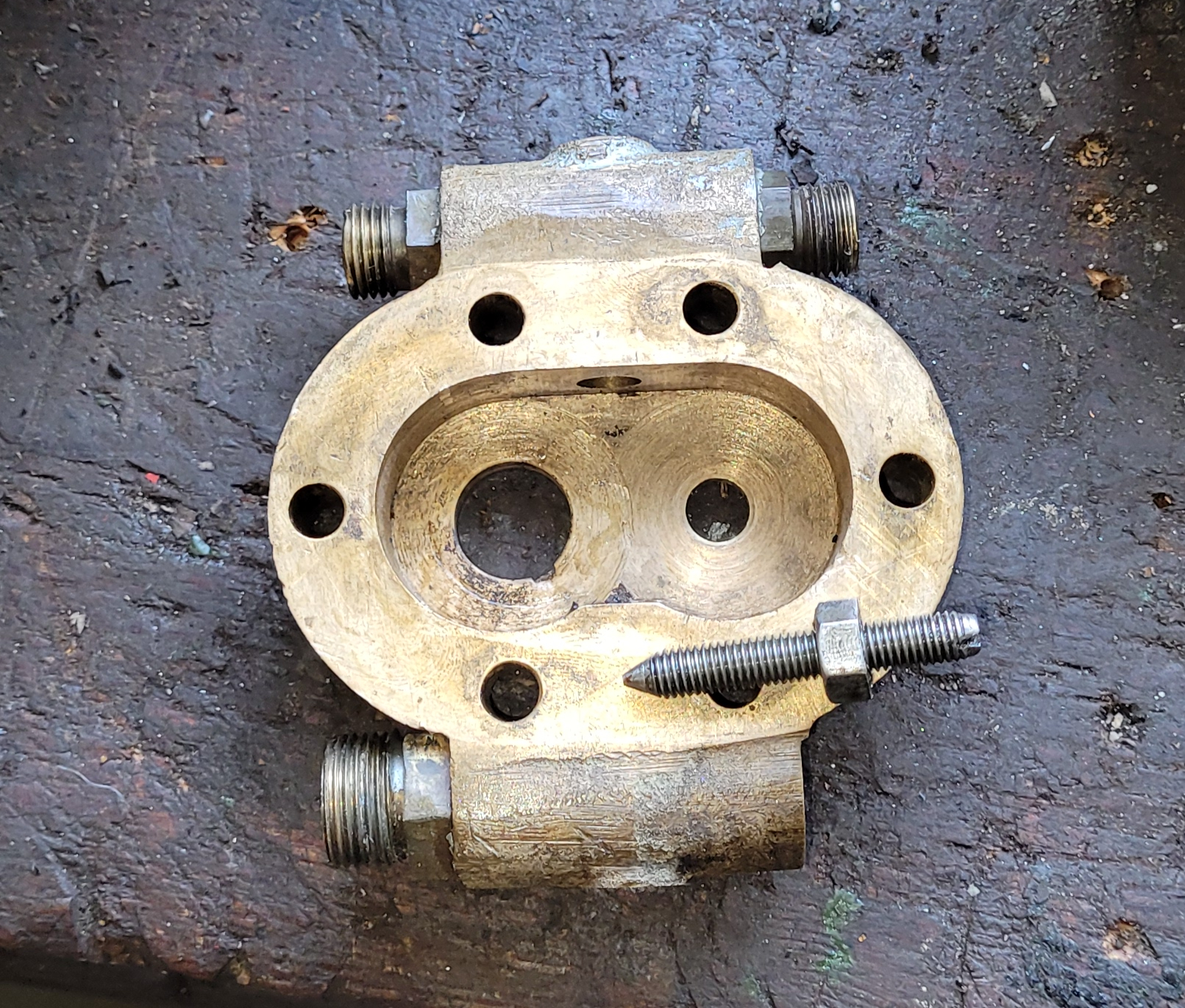

Opposite the water inlet connection to the water pump there is an adjustable needle valve (pic attached).
The only purpose of this would be to restrict the flow of cooling water - why would that be required? Might the engines run too cold and need the flow reducing to help them run at optimum temperature?
The pistons have no pins to prevent the rings rotating althought the ends of the rings are stepped. Just wondering why?
Thanks,
Bernie

A couple of great questions to which I don't have an answer, but I agree with your thoughts on reducing the water flow to ensure the engine doesn't run too hot or too cold especially when BMB were selling their engines all over the world. It would be nice if someone had an owners handbook that might confirm this.

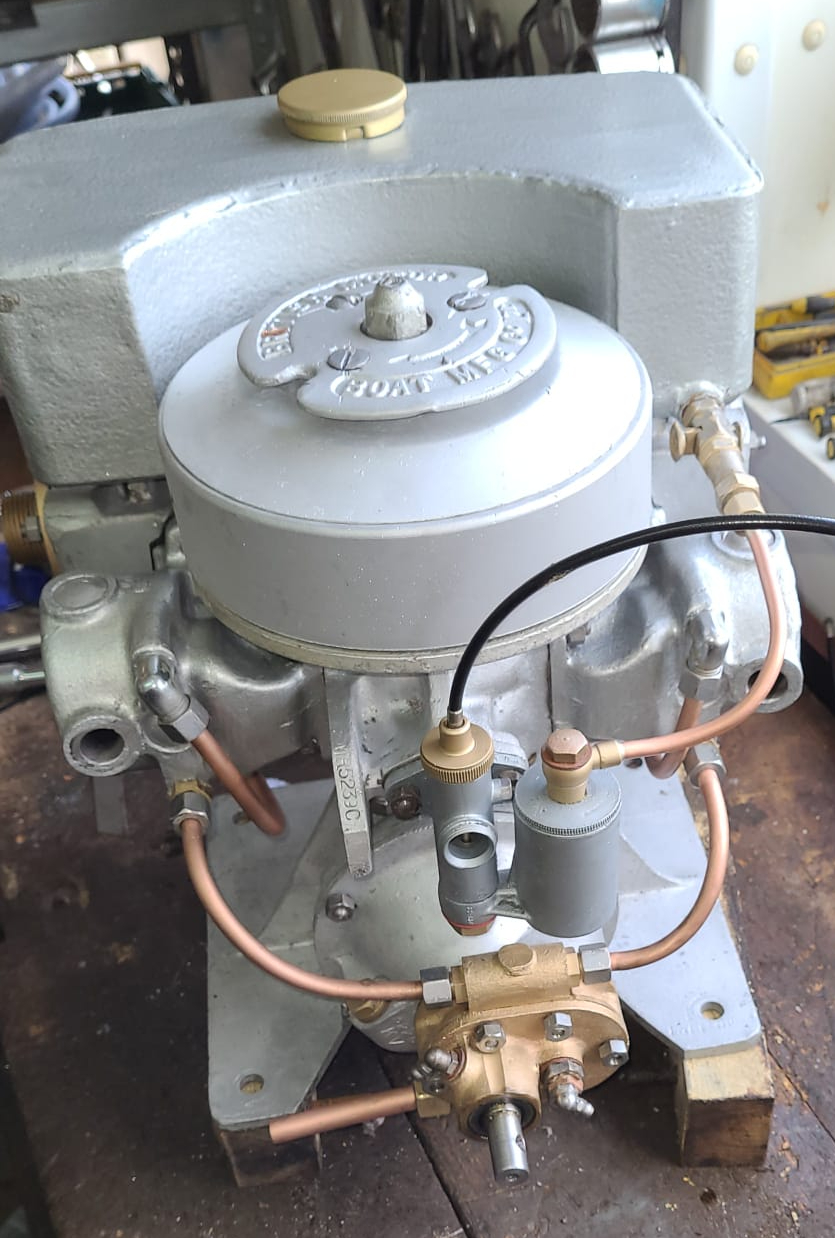

Looking quite pretty now. Just waiting for the coil to come back from a rewind and we'll go for the first start since about 1974!
