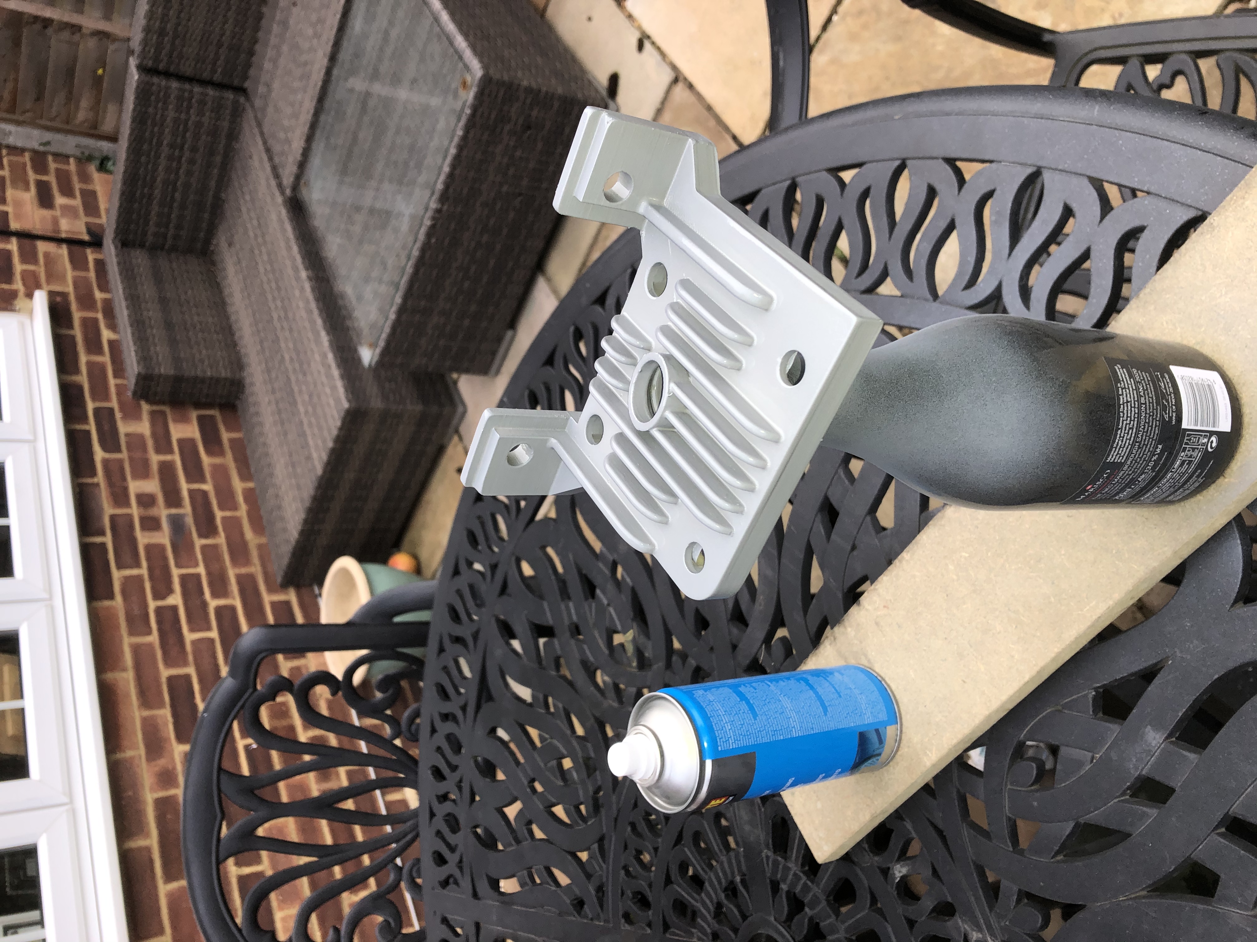

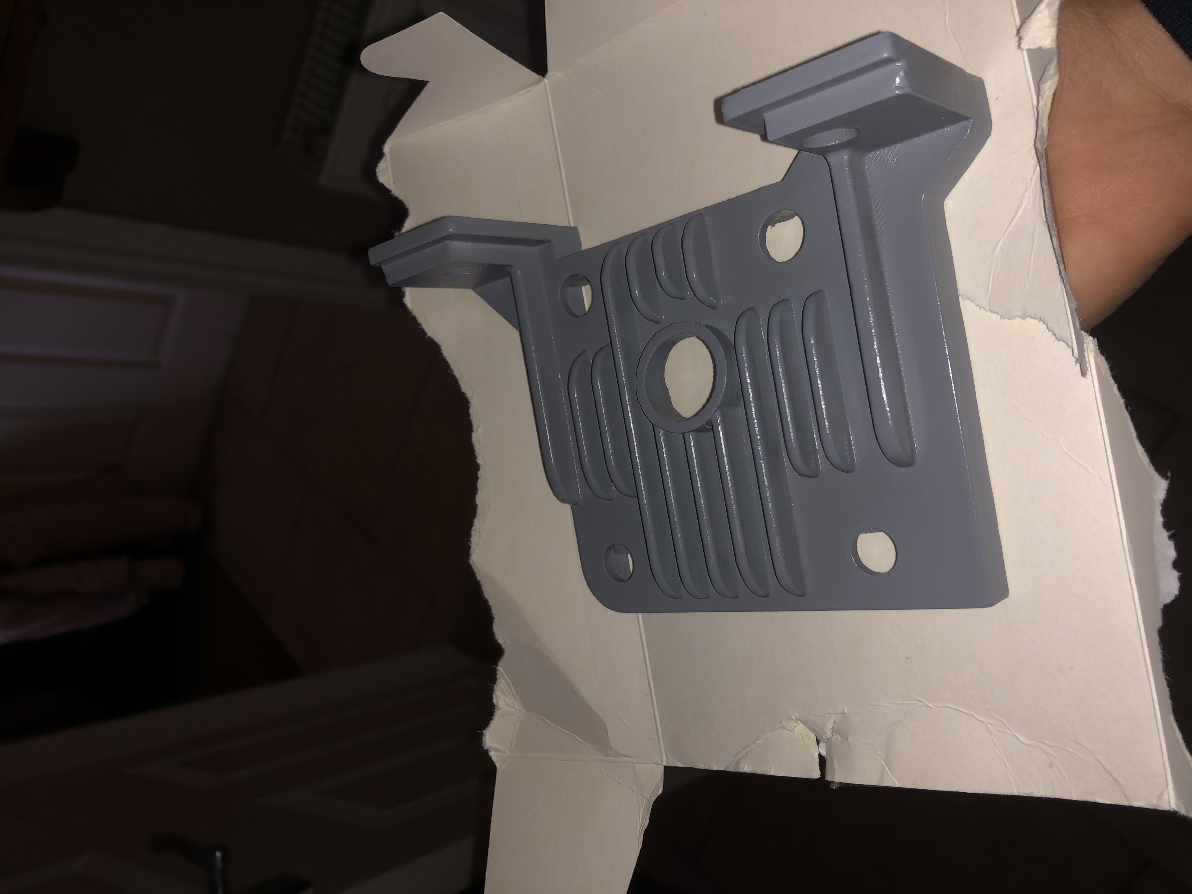

I’m currently experimenting with some 3D printing, and have tried to recreate a century cylinder head on fusion 360. I’m still getting used to the new software, so this is only version 1.
As for the underside of the head, there is lots of potential in the future. I may design a higher compression head with water cooling channels and use it as a positive so I could cast one... something to think about.
Hope this interests someone! And please let me know if anyone has tried this before.
Ed
In later versions I will correct the spark hole angle, and add some chamfers to edges all round. Maybe even add some casting lines and the “don’t remove” text. Printed in white pla, at 20 percent infill on a creality cr10s. I’ve then primed it in grey plastic primer, I’m going to add a black top coat, rub it down lightly and apply a silver rub n buff finish to try and see how close I can get it to the real thing!Something different

Interesting! I have an Ender 3Pro myself and am still learning. Definetely not at your level yet!
Re: Something different
Good job.
Looks like we may be trying "Lost PLA Aluminium Casting" .
You will soon be printing Marston cylinders I hope, watch this space.

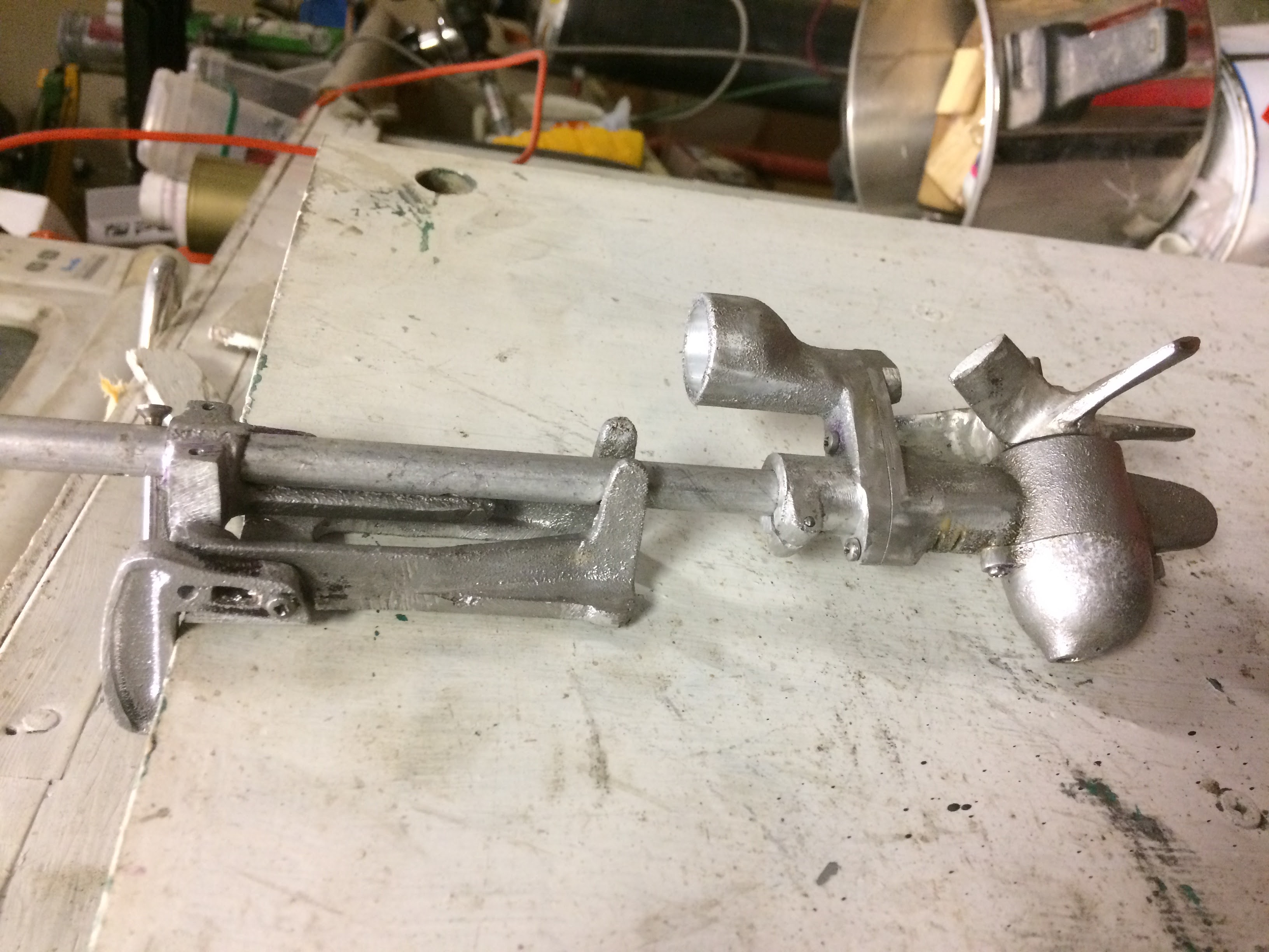

I have been having a play with F360 as well (I'm doing it for a 1/3 scale model)
This is drawn up full size with the water ways The cast parts where done with wooden patterns before I got the 3d printer. The plan is to make it a working engine. (only been 2 years so far) if only I didn't have to work!

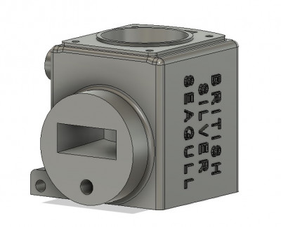

I was looking at a Marston cylinder the other day, wondering if a solid one could be cast, then machined out to take a liner.
It got me thinking if a 3d printed pattern would be doable?

3D pattern is definitely possible, I would like to attempt it, if anyone has drawings of a marston block with dimensions of waterways/ transfers I am happy to try to CAD one up. Printing a block would need to be scaled up a couple of percent for casting I would imagine? And the surface finish of the pla may need to be thought about, as the printing lines would affect the castings.
