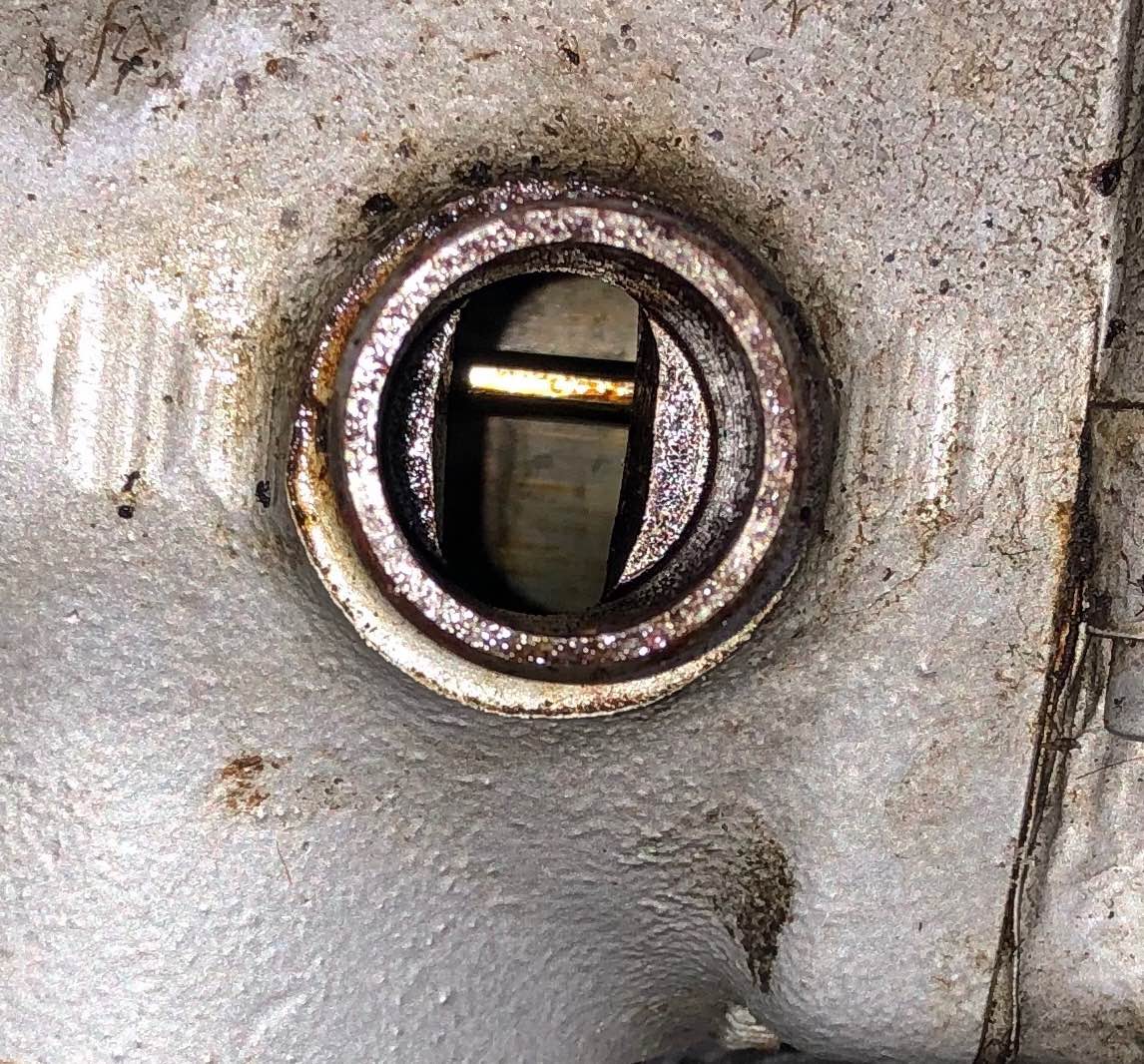

Now, the big question for the "6" is - is it a roller big end? or has it been replaced with a plain bearing version. As a first step, I have had a look at the con-rod through the inlet port and it looks to be a lot thinner than normal - see picture. So I'm thinking it's a roller and has to come apart. Crank end and flywheel taper is now soaking in wd40 before I try to remove the flywheel and take the bottom end off. I've got a spare Curlew crank with a no.4 con-rod to fit until I can inspect and overhaul the roller crank.

looks fine, much thinner than normal ali conrods.
Re: KSR1100
Thanks H-A. So I'm presuming that confirms it is a roller crank. I'll get it apart and take some pictures.

Don't take it apart until your sure it's necessary, is there any rust or discolouration around the big-end needles or excess play in the big end?
Yours looks like it hasn't had a hard life from here, so leave it alone!
Oh that wasn't yours it was H-A's.
And I don't know if there is anyone in the UK who could rebuild your crank.
And yes it's a needle crank.

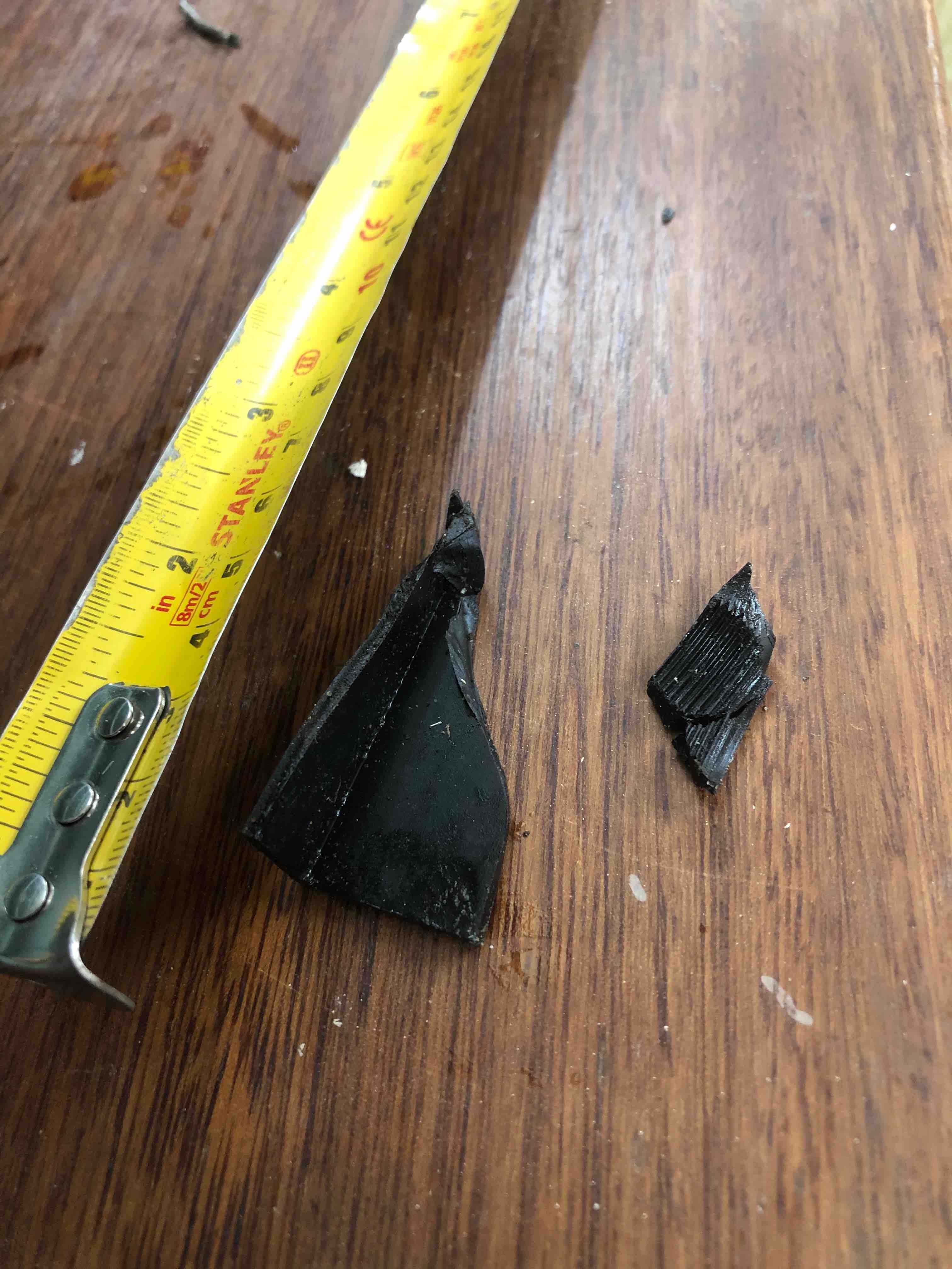

Under the flywheel, I found a couple of pieces of broken plastic, but I cannot see anything that they might have come off. The ignition module looks intact. Anyone recognise the pieces? The smaller one has a bit of a thread on it.

Part of the carb choke shroud.
Re: KSR1100
Spot on Charles.
I didn't notice that as I was looking for something with a bit broken off it and it turns out the choke shroud has been replaced.

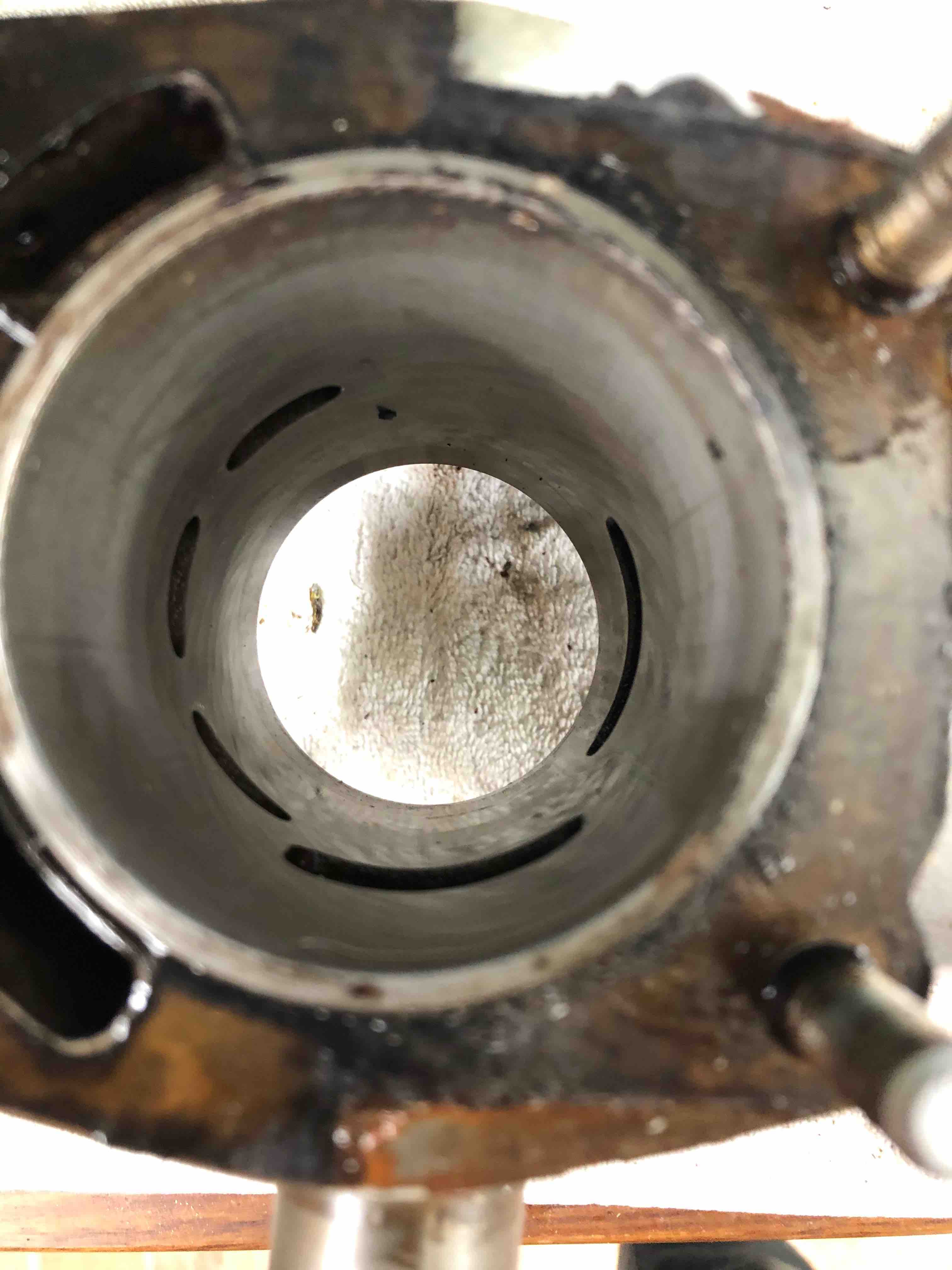

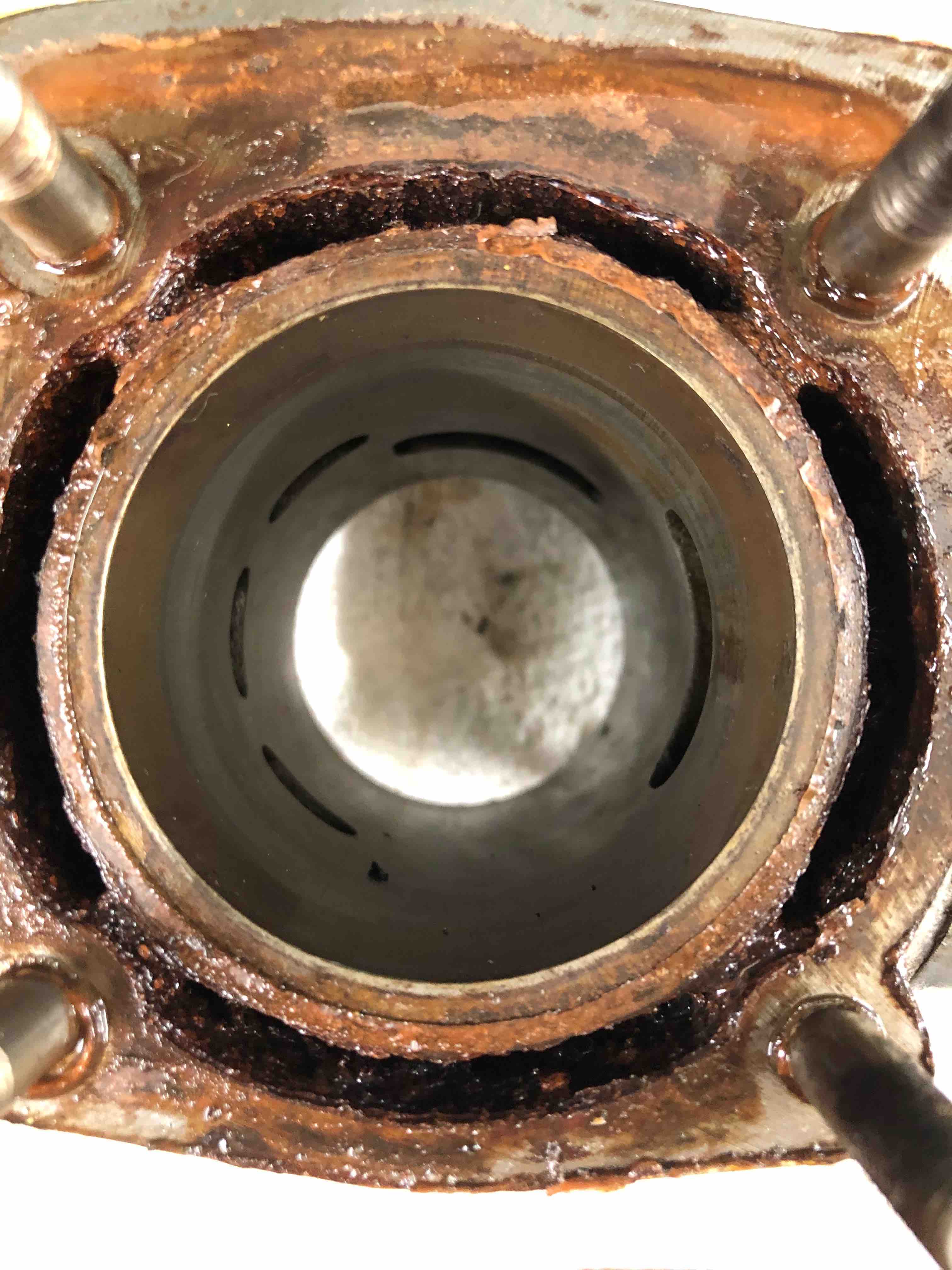

Well that was an interesting afternoon. Separated the crankcase & block & took the head off.
Pictures as follows
The head The bore The inner exhaust (couldn't get the exhaust tube off yet but it looks pristine by eye. The big end pics follow in the next post
Pictures as follows

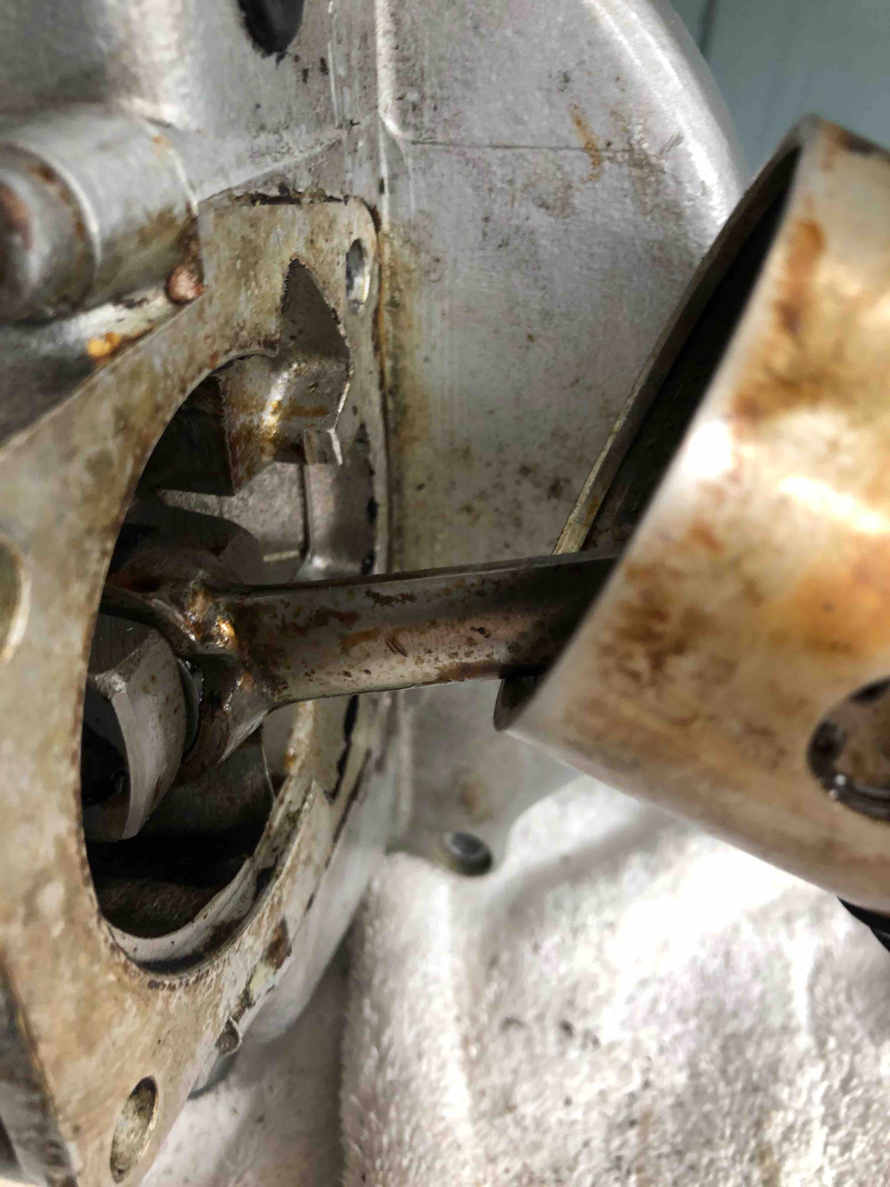

And the big end
Its all a bit tarry but no sign of rust or bluing, although one side of the slot through which you can see the needles looks a bit rough.
But the problem is - The big end pinches in the crank webs about 20 degrees either side of TDC & BDC so it will not even fall under the weight of the piston.
Maybe it was already like that or maybe I did it when removing the flywheel - followed the service manual and it only took a couple of firm blows with a lump hammer on the flywheel nut.
Oh well, i'll split the crankcases and get it onto a couple of v-blocks with a dial gauge and see what is going on. That way I can also get some better close-ups of the bearing.

Remove the piston & clean the crank & rod with fuel mix, remove all the waxy deposit with a paint brush.
