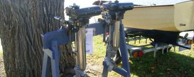

i am thinking of shortning the leg on my seagull 5 hp
by cutting the exsorst/ drive and water pipe so it fitts on my boat in the well. any coments please

I have just done it on a 40plus,I cut it to fit my Mirror.No problems as long as you cut the same of each piece.
viewtopic.php?f=2&t=6919

Does not seem to make any difference to the performance
(shortened by about 8") [attachment=0]tonys gulls.jpg[/attachment]
