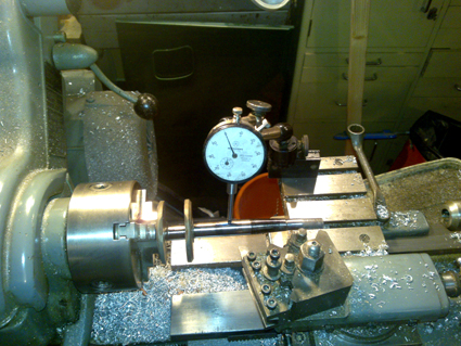

I try and get them to within a couple of thou.
Have straightened quite a few, including later needle roller crank, works OK.
Bit harder if they are twisted.
