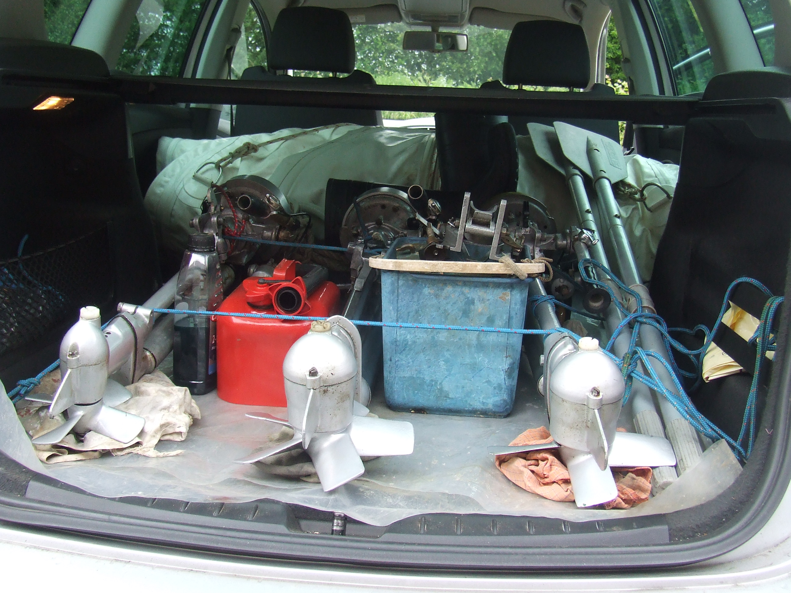

Packed up the three smaller Gulls and an inflatable and set off to catch the tide.
The inflatable was a freebie from Tams part of the world! (Not a sentence you hear very often!)
The idea was to give all three gulls a good run and decide which was the more suitable for a proposed adventure involving some French people.

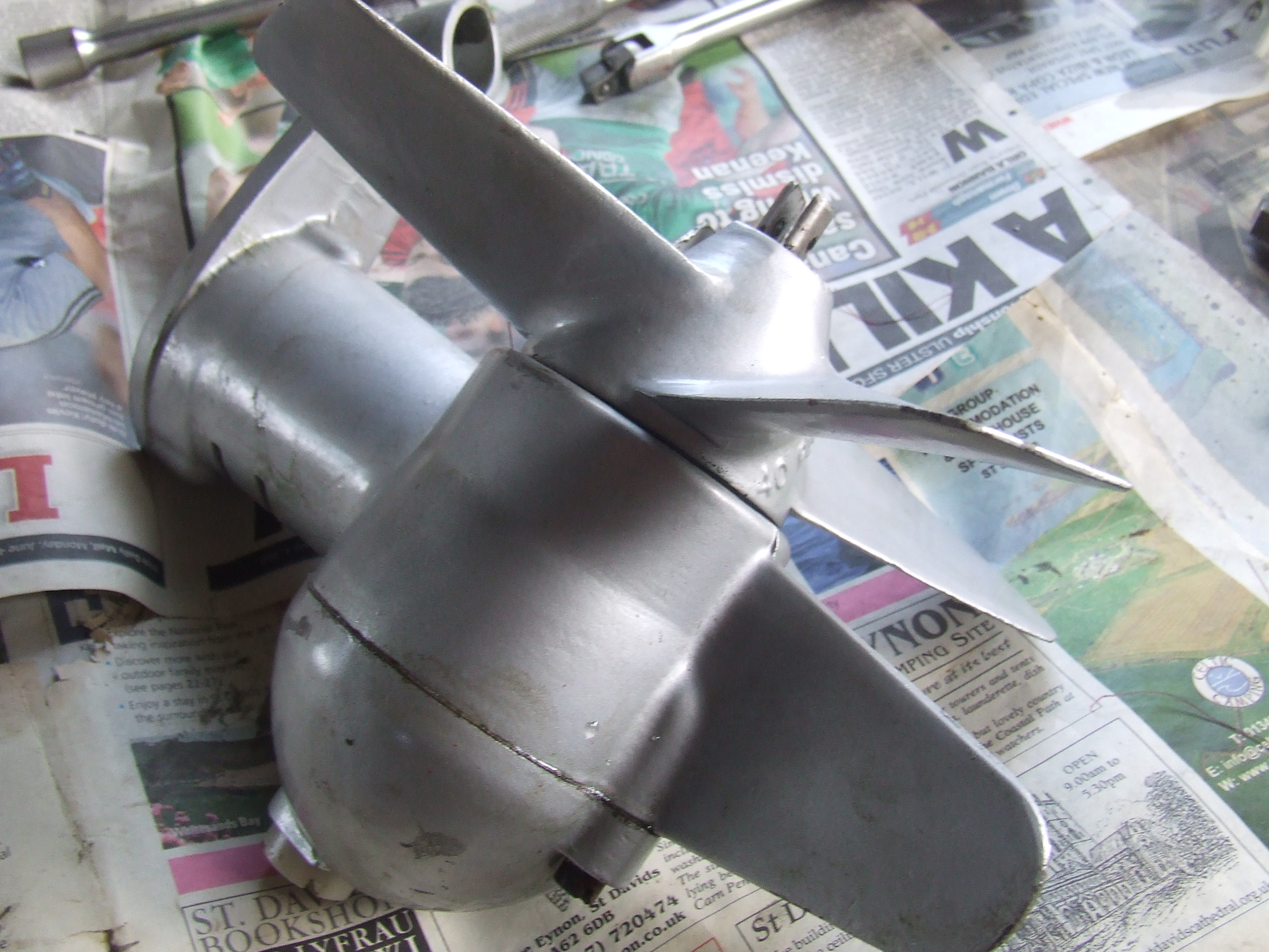

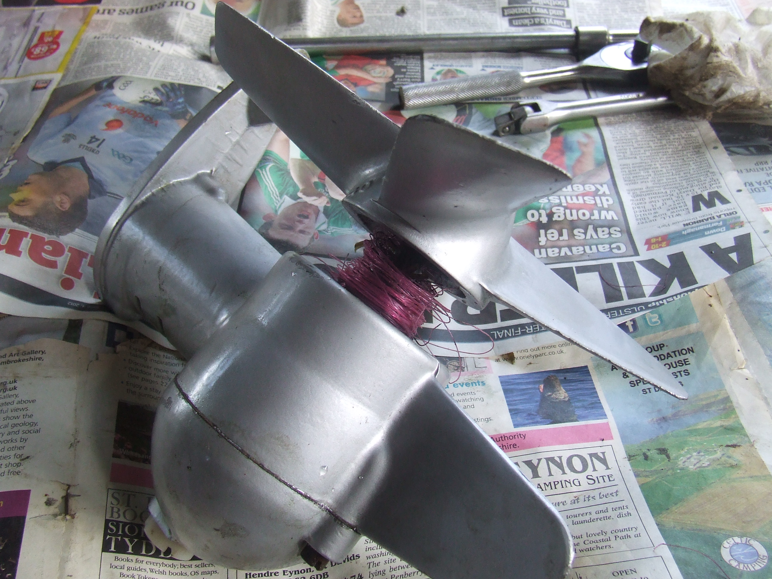

The 40+ stoped as I came out of the river, at first I thought it had run out of fuel and refilled it. But when I tried to start again it was very tight, nothing on the prop and nothing to be seen externally. It looked like it was going to be a long pull back against the wind and tide.

No sign of any thing amiss. But here is the reason the Gull ceased to proceed! She had managed to draw in all the fishing line filled the back of the prop without any showing on the outside. A lot of it had got between the collar and the gear box eventually it melted and the melted line jammed the shaft but left the prop free.
Even if I had found it I could not have fixed it on the water as I needed to remove the pin to take the collar off and clear the jam, what a mess.

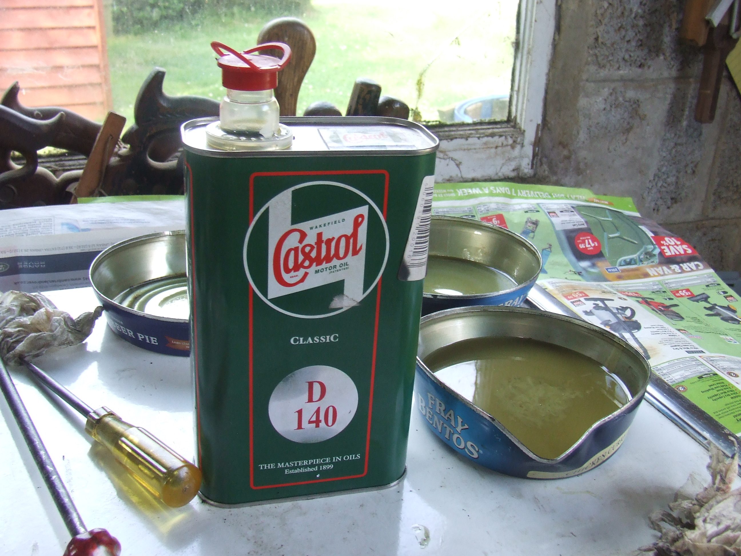

Has anyone come up with a solution to stop this hapening? By the way after three trips the oil was nicely emulsified, so I can recommend Castrol “D”

PPS Talking of red Charles the plug electrode was a nice Tan colour and further down on the insulator it was bright red, I’m assuming that this was from some additive in the TC-W3, what do you think?

The motor is all back together with new oil and tested this afternoon, ready for the next adventure.
