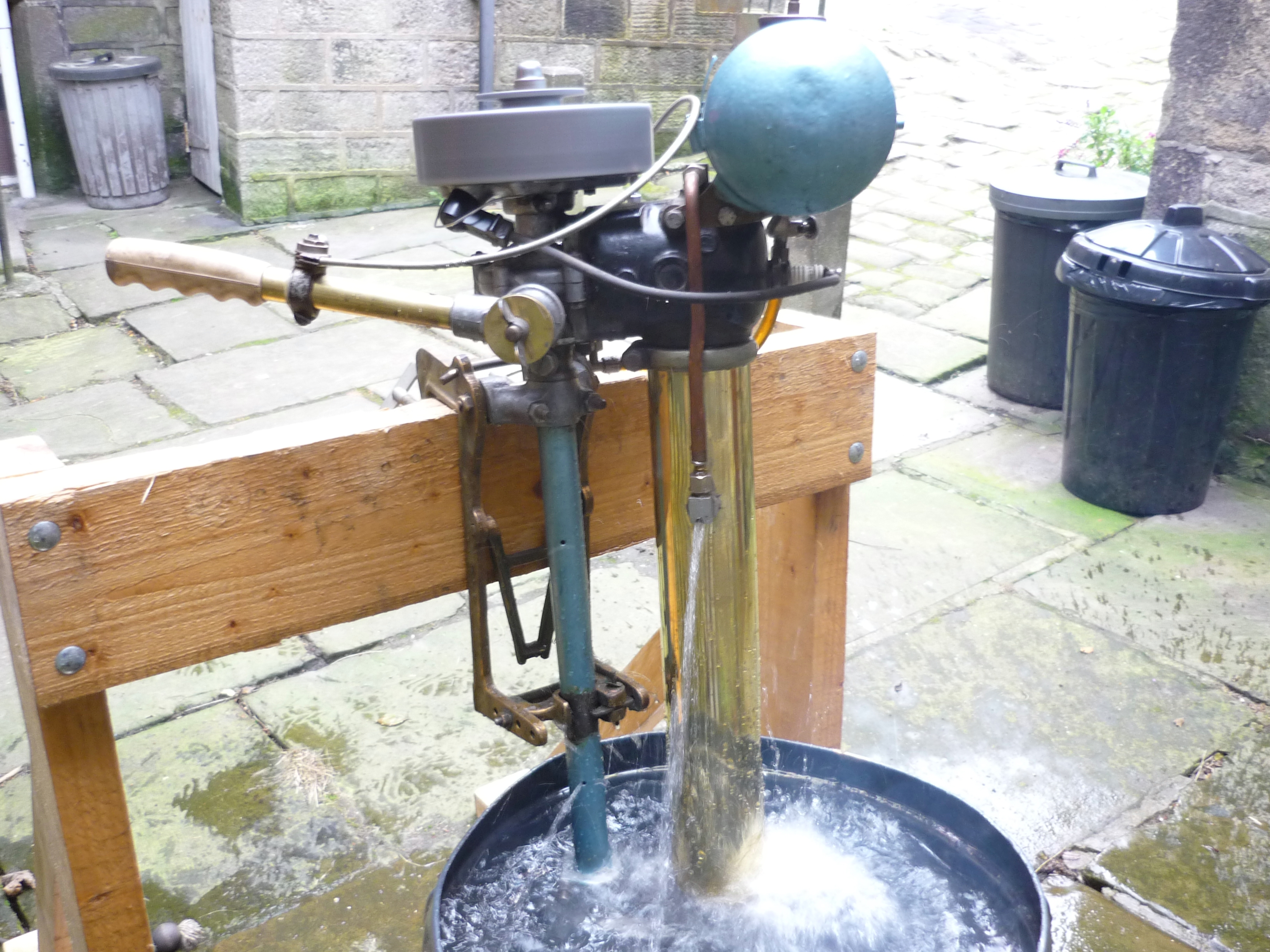

Can someone post a picture of the telltale block on the side of an 102 exhaust tube so Red can see where all 102's feed water back into the exhaust, perhaps a previous owner has used a silver century exhaust as a repair.
Without doing as I suggested you won't be able to see if the water delivery tube has split, not an uncommon problem with brass water delivery tubes.
Re: TC 102 water cooling problem
Here you go, the water outlet from the cylinder goes into the exhaust via a adaptor. Most goes back into the exhaust to help cool the lower exhaust, some spits out of the small hole to act as a witness.
Sometimes the water supply tube becomes blocked, or sometime the tube comes loose and is then not connected hence no water feed.
More often there is corrosion in the waterways in the cylinder and flakes of rust block the water flow. If you take the cylinder top and bottom pipe fittings off, then you can remove the flakes of corrosion.
I’d strip everything down, clean the tube etc, and also try to get as much out of the cylinder you can.
