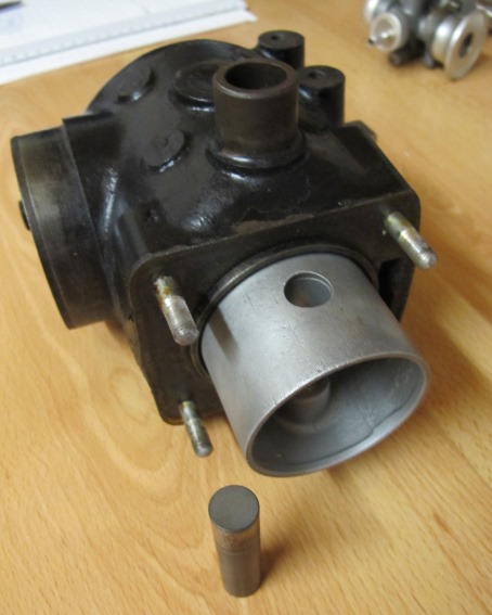

Why does one end of the gudgeon pin have a stop end?
Does it have something to do with how a 2 stroke engine runs its cycle?
I have a spare piston here and with pin, the piston from my 102 series motor is still fitted with its gudgeon pin, so I can see which way it should be fitted, or can it go either way in the piston?

I fit all of my seagulls gudgeon pins with the blocked end towards the top and away from the exhaust port. Stops any oil filling the hollow tube of the pin over time and adding extra weight to the reciprocating assembly.
Some early 102's had a slightly different design of pin where both ends had an aluminium plug at either end resembling a solid pin and no circlips either. Essentially a free floating pin.
Not all 2 stroke engines have a blocked end either. Perhaps this is just a seagull thing.

If you remove the gudgeon from a piston & slide the piston into the cylinder while looking up the exhaust port you will understand why they have a blanked off end.

Guys, thanks on your advice.
I will refit the gudgeon pin back in the same way that it came out

Yes Charles uk is right.
The gudgeon pin on my LLS is fitted with the open end facing down towards the exhaust port and the blank end facing the transfer port. This way there is less turbulence and interference with the incoming charge.

Journeyman wrote:Yes Charles uk is right.
Thanks,
Your saying not the way it was as in my picture?
I ask as that was the factory build ( i think ) and as it is again now that I have stripped the crank case and reassembled it all.
I used a power drill to spin up the 2 stroke lubricated engine, the compression is very good and the suction at the inlet port is very stong.
I used some 600 wet & dry paper on the bore to de glaze it before fitting the piston.

Crankcase compression is very important on a two-stroke.
Seagulls like most two-strokes have the transfer port and the exhaust port opposite each other cross the bore, so they can’t have a hollow gudgeon pin or they would lose crankcase compression as the pin passed the transfer port.
If you have the blank end towards the exhaust you will lose some of the compression, that’s why blokewithaboat is correct in fitting the blocked end towards the top.
They will run with the pin the way you have it but it will be better the other way round.

A question, why was it fitted the other way round when I opened the motor ?Journeyman wrote:Crankcase compression is very important on a two-stroke.

Question, should the blanked off end be as I found it when the motor was opened, or should it be the other way around as has been suggested?Charles uk wrote:If you remove the gudgeon from a piston & slide the piston into the cylinder while looking up the exhaust port you will understand why they have a blanked off end.
I ask as the motor is now re asembled and the blanked off end is fitted as I found it when the motor was opened.

Just leave it be as it is. The motor will still work!

Thanks, yes even with the Seagull Villiers carb fitted, the motor fired on the second pull and then started on the third pull of the pull cord and now starts a runs really wellNudge wrote:Just leave it be as it is. The motor will still work!
