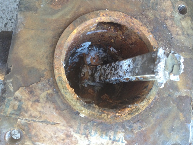

Recently i removed the barrel (cylinder) from a wartime Australian Commando outboard (number 3). In the process, the conrod literally fell apart ie main stem between the big and little end. Mind you were talking a rather thick aluminium casting of say 20 x 20mm. The piston was found to be soft also, albeit that it appears quite normal.
Point is, many of the engines we wish to restore will have had water ingress at some stage. If they dry out fairly quickly, then not a problem, there are ways to free stuck pistons and piston rings etc. But if the water sits over an extended period of time, then replacement parts may be needed.
EDIT: Adding Some pics.
1. Broken rod. I was able to break it again simply by gripping with a pair of pliers and twisting.
2. Piston removed, rings freed and given a quick clean. Aluminium is soft. Corrosion/pitting around the what was the wet area. Not reusable.
3. Cylinder after a light hone. Again, some pitting is apparent in what was the wet area so a slight bore might be in order.
