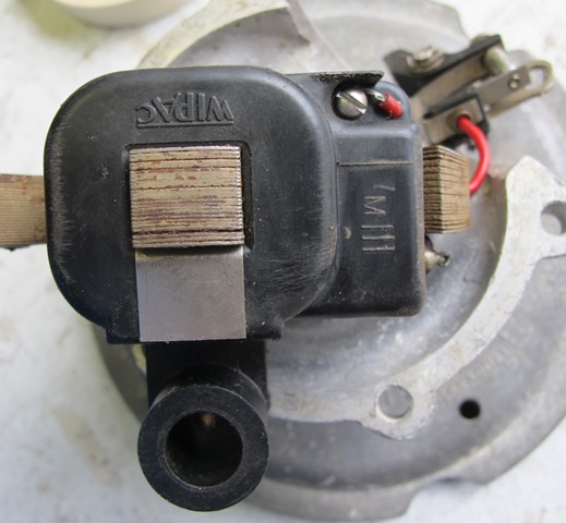

Having just used my one and only spare Wipac 2 coil on the 1974 Forty series motor that I have, it would be nice to buy in a new pare to be able to use when and if if ever require one?
Was the Wipac coil used on say a motor bike engine and if so what make and years made?

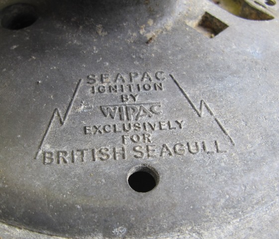

Nudge wrote:As far as I know it was made for Seagull.
I know that the base plate was, check the picture.
Re: What motor bike does the Wipac 2 coil fit?
I don't think the that coil was used anywhere else, unlike the Villiers.
