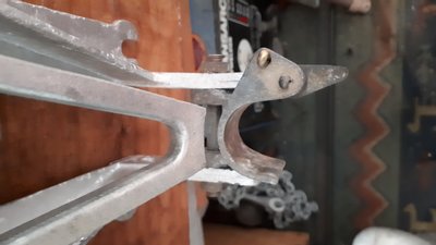

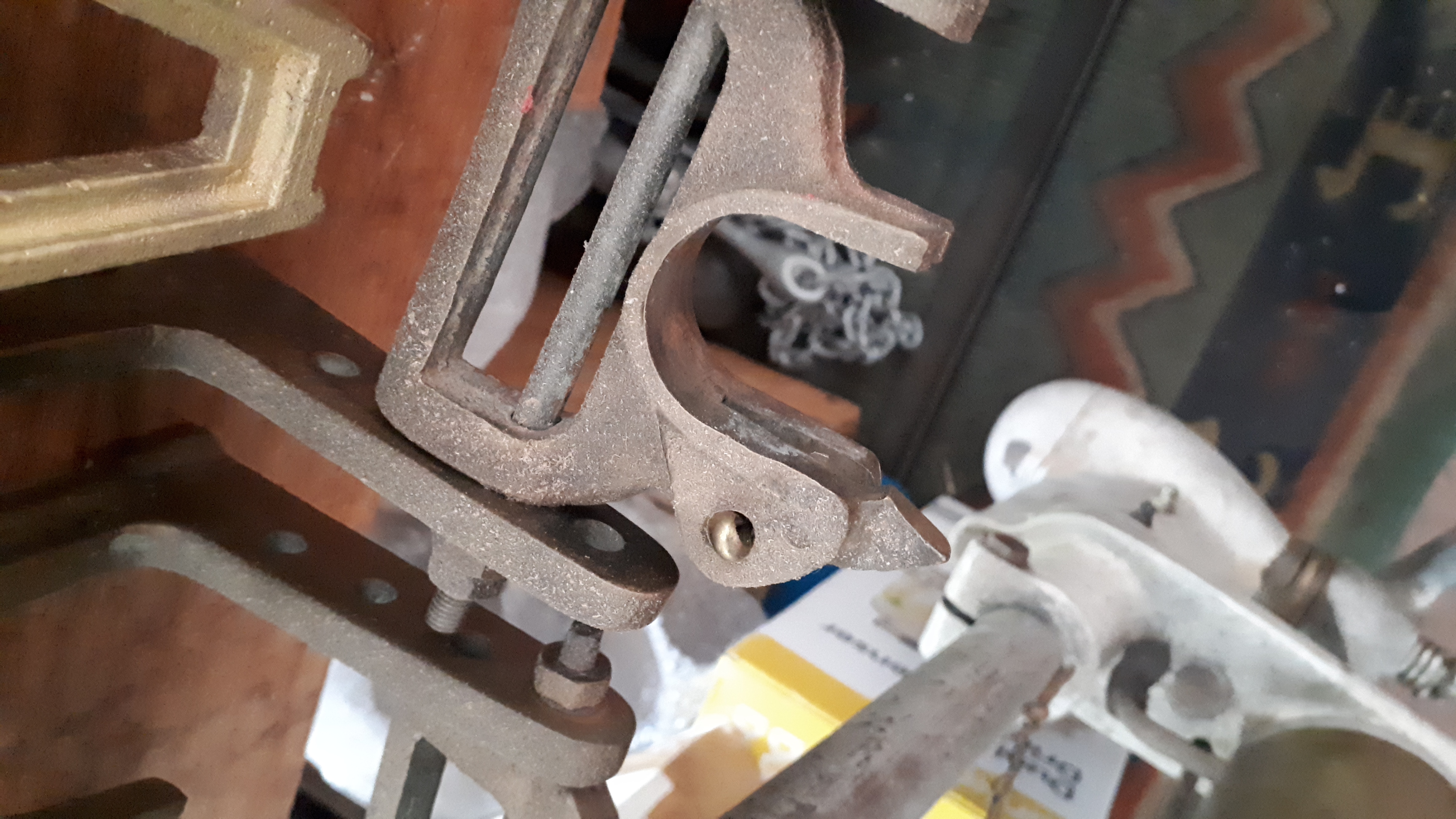

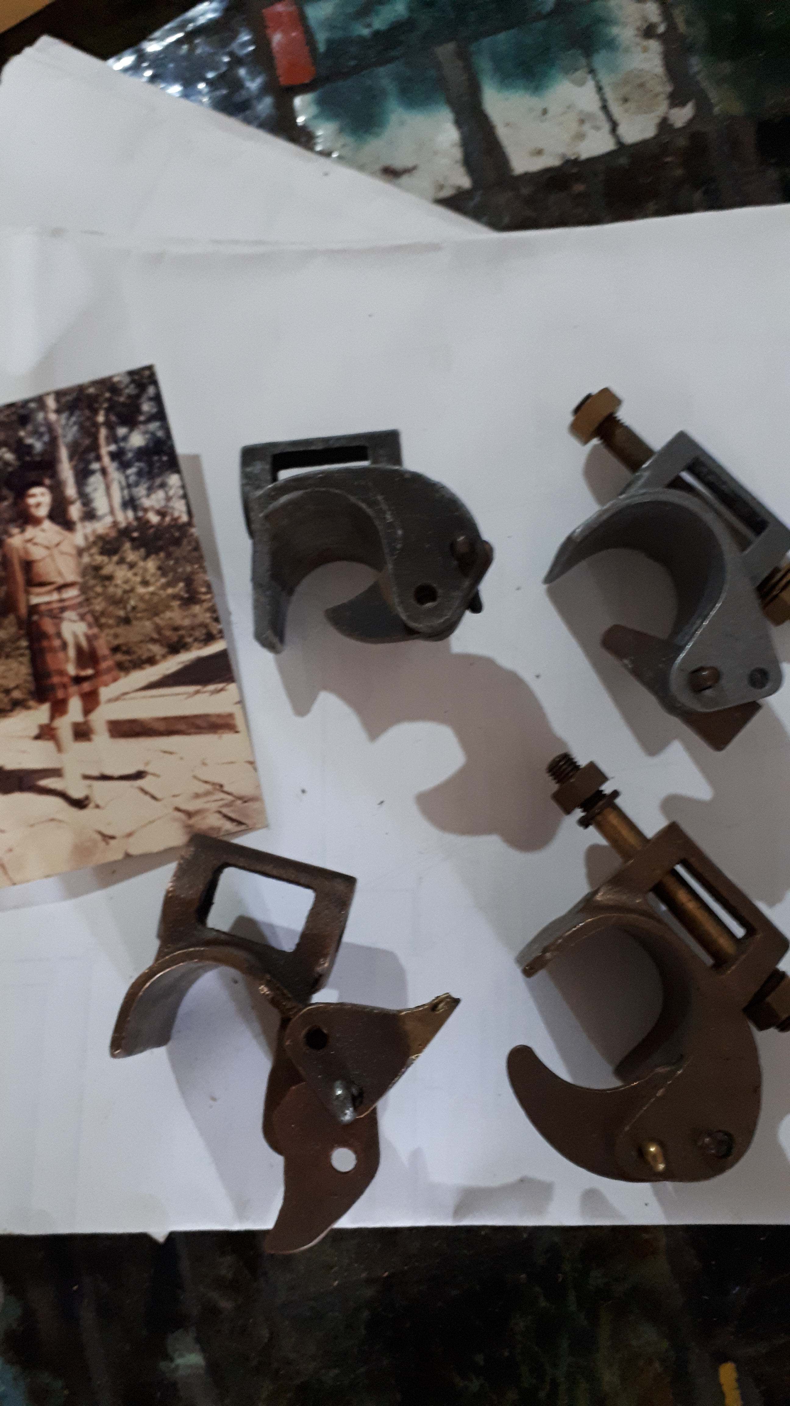

I thought they came with that latch at least some of them. Some have a hole for split pin and others, the split pin goes in front for open and back for locked. Two left ones are damaged.

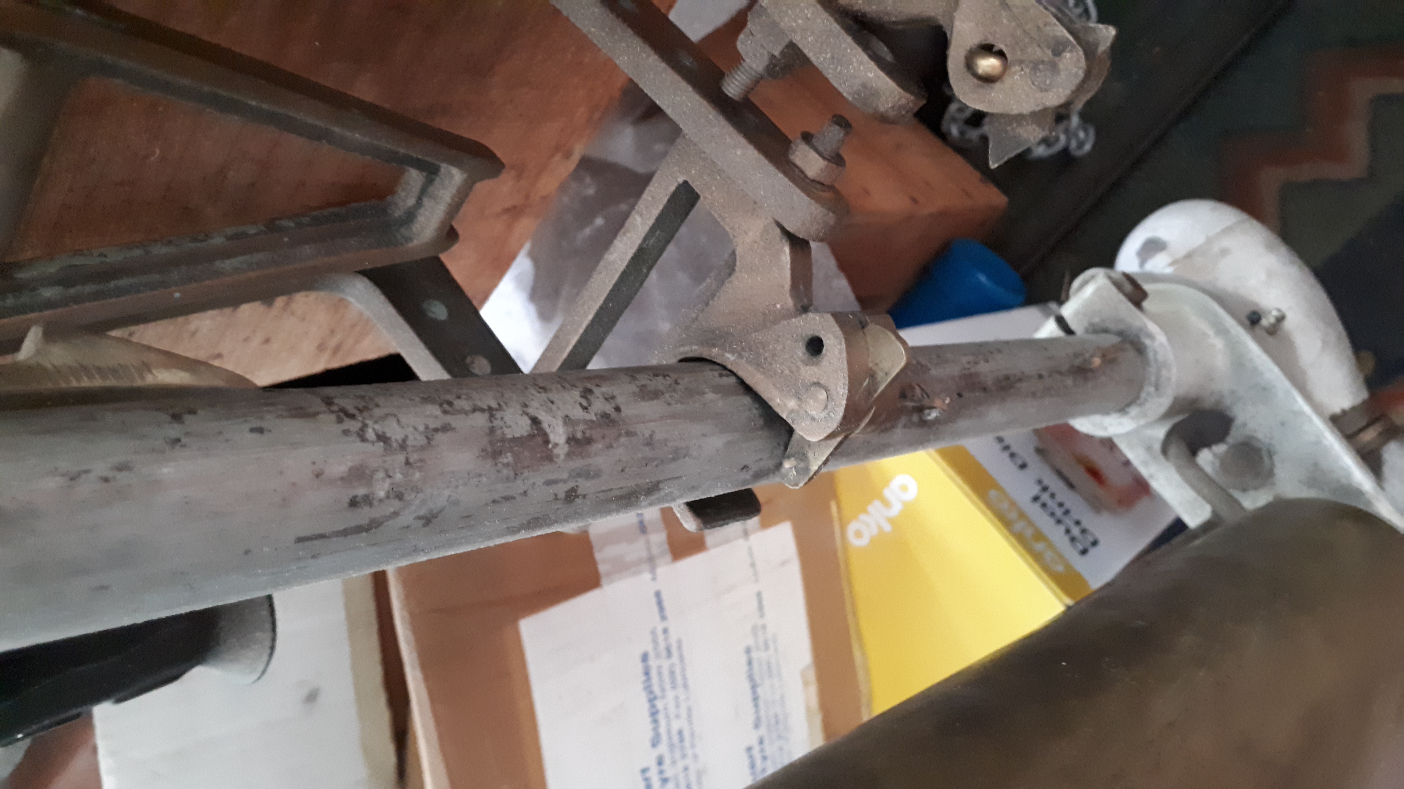

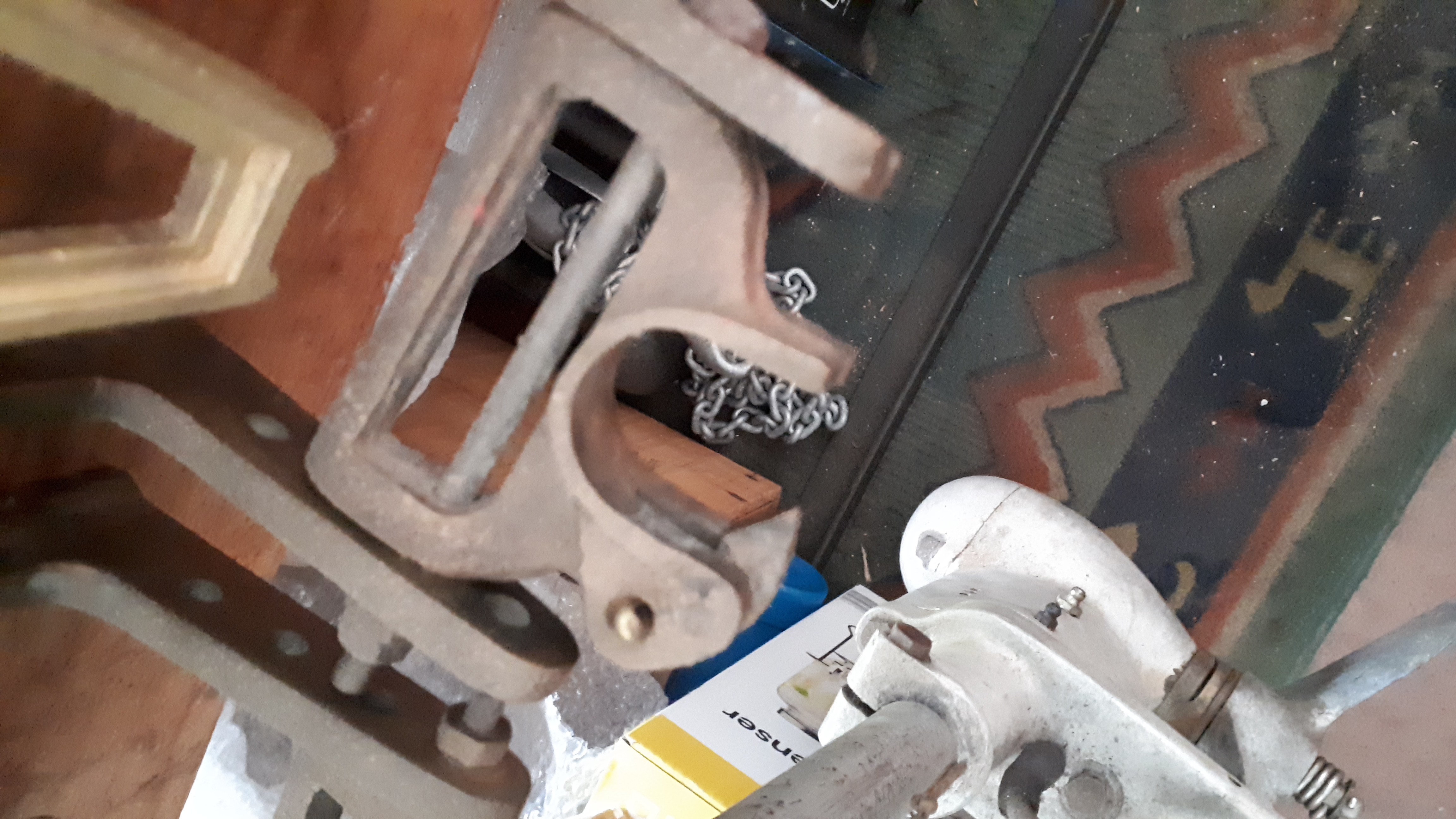

More:
Same story with skeletal:

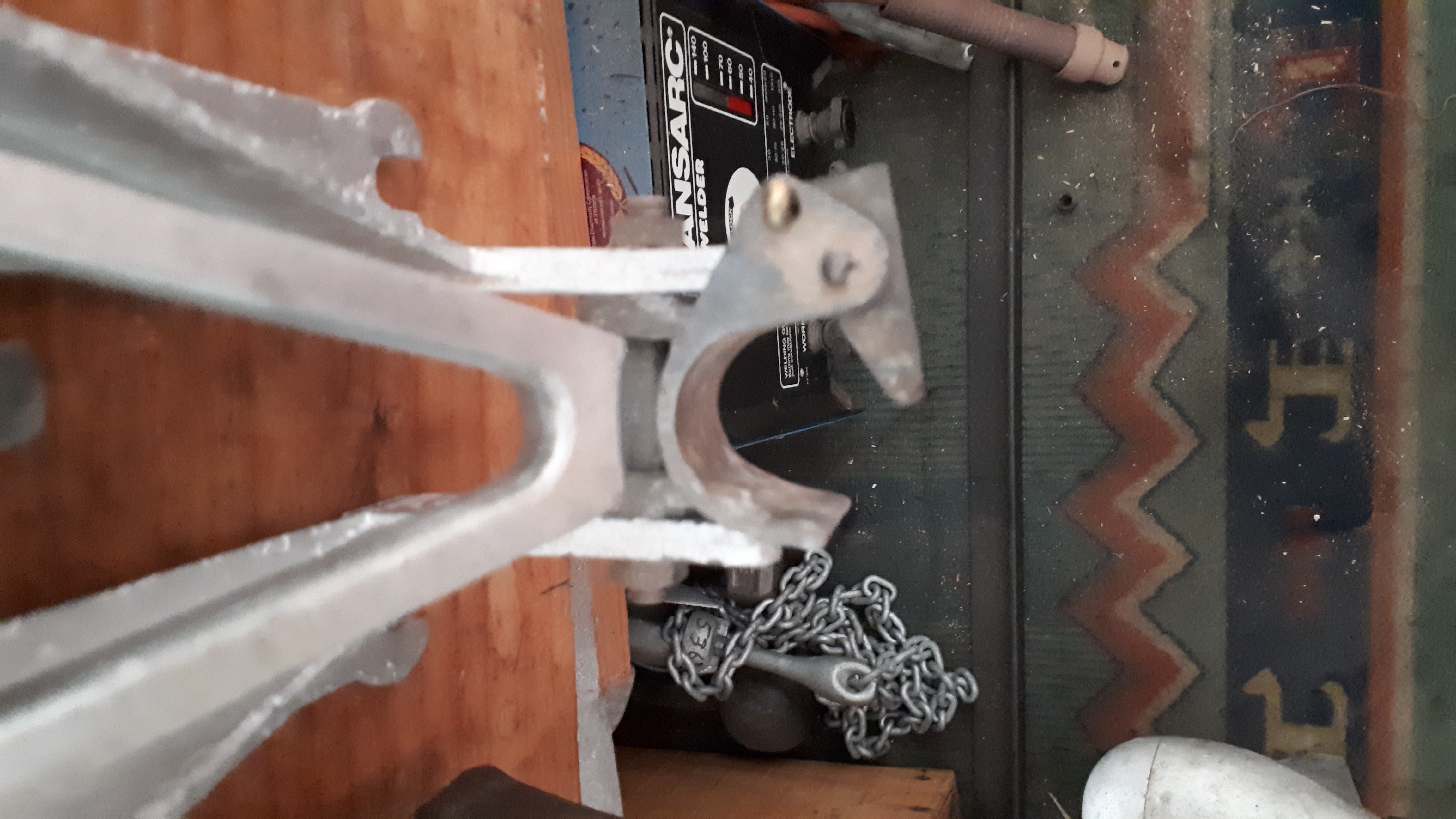

Another skeletal, no holes for split pin but either side.
Re: Locking latch
I'm putting forward the synopsis that earlier ones were wedged (wedge latch) shape with one hole and later ones were the sexy sickle shape with two holes (sickle latch).

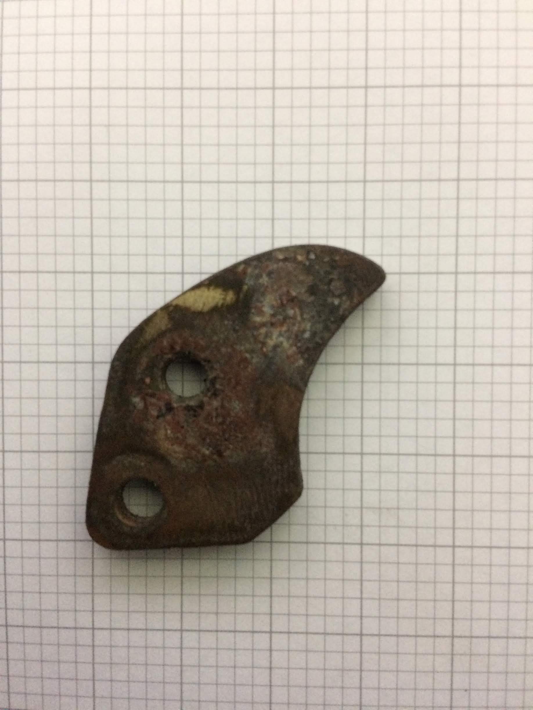

Small birds beak?
Is this the one your after? (if it is not I will need a good pic so I can draw it up) If it is give me a week or two and I will cast some.
How meany do we need?

Many thanks for your kind offer nudge it was the full locking device that I was after I now have one cheers ...
Re: Locking latch
I now have one of the Nudge styled ones, thanks John.
They appear to be stamped from 8 gauge brass sheet, I will see if I can get a 3D drawing done Nudge.
If I can find a laser cutter who stocks & will cut the right gauge material it will save time & money.
What I will need to know is what sort of chain was used to retain the locking pin, & the only one I've got with chain looks like their bath plug is no longer retained, & the chrome is starting to chip.
It would probably be easier if John stocked & sold the whole kit, latch, chain & the 2 sizes of split pins, it would save the owner a lot of driving around town looking for 2 different pins.

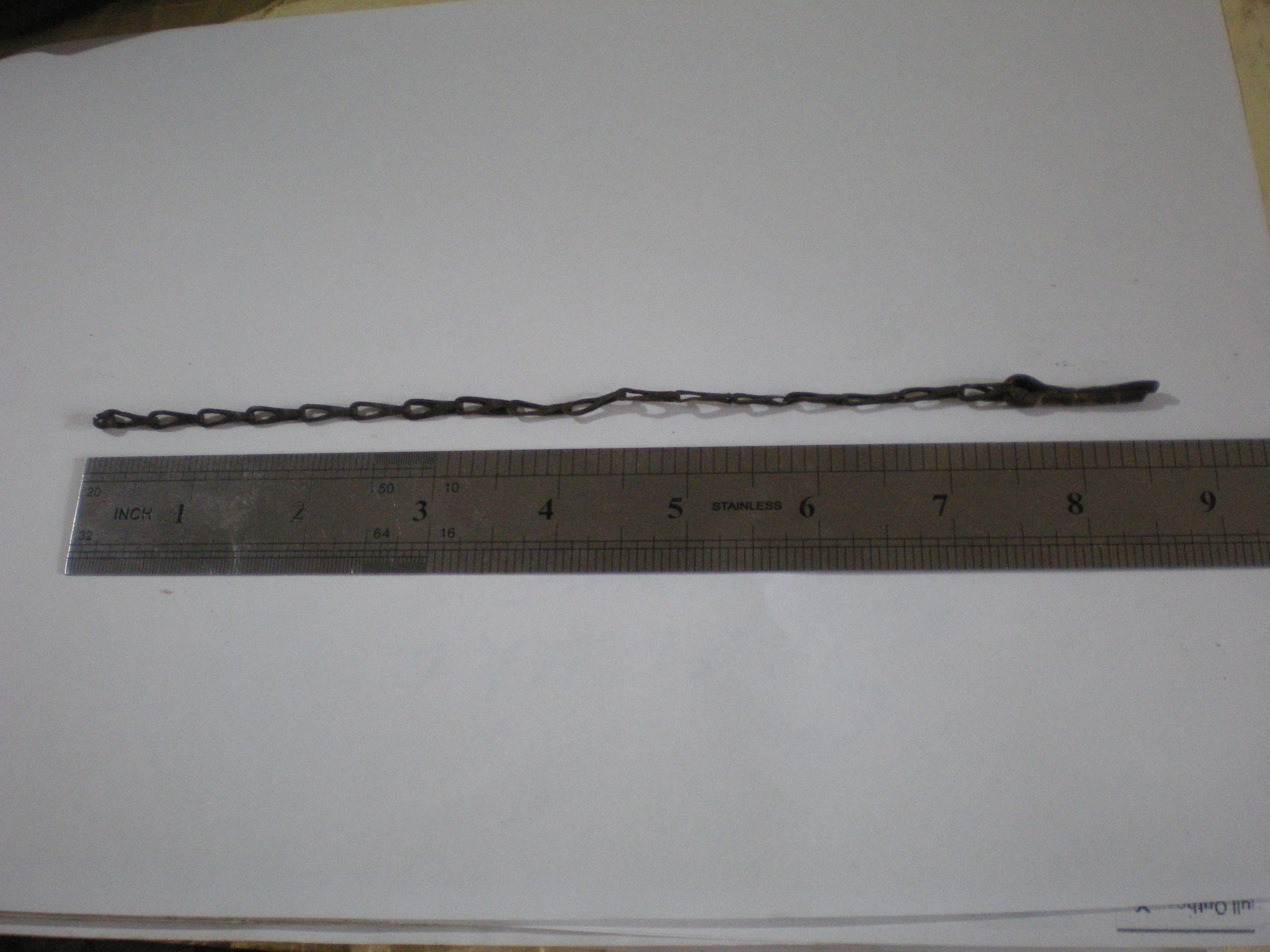

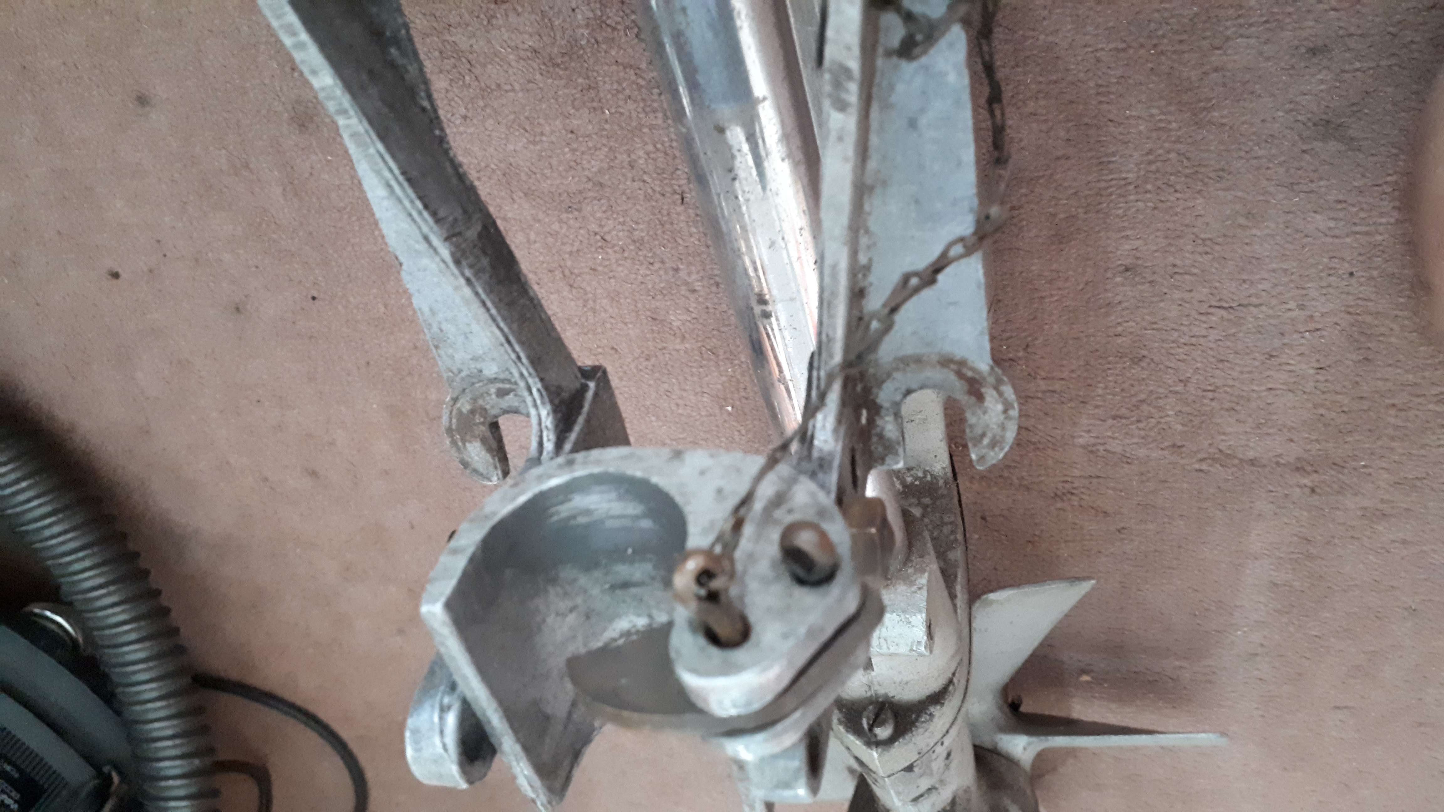

Chain and pin. Of course the little pin that fastens chain to bracket broke. Left click twice.
