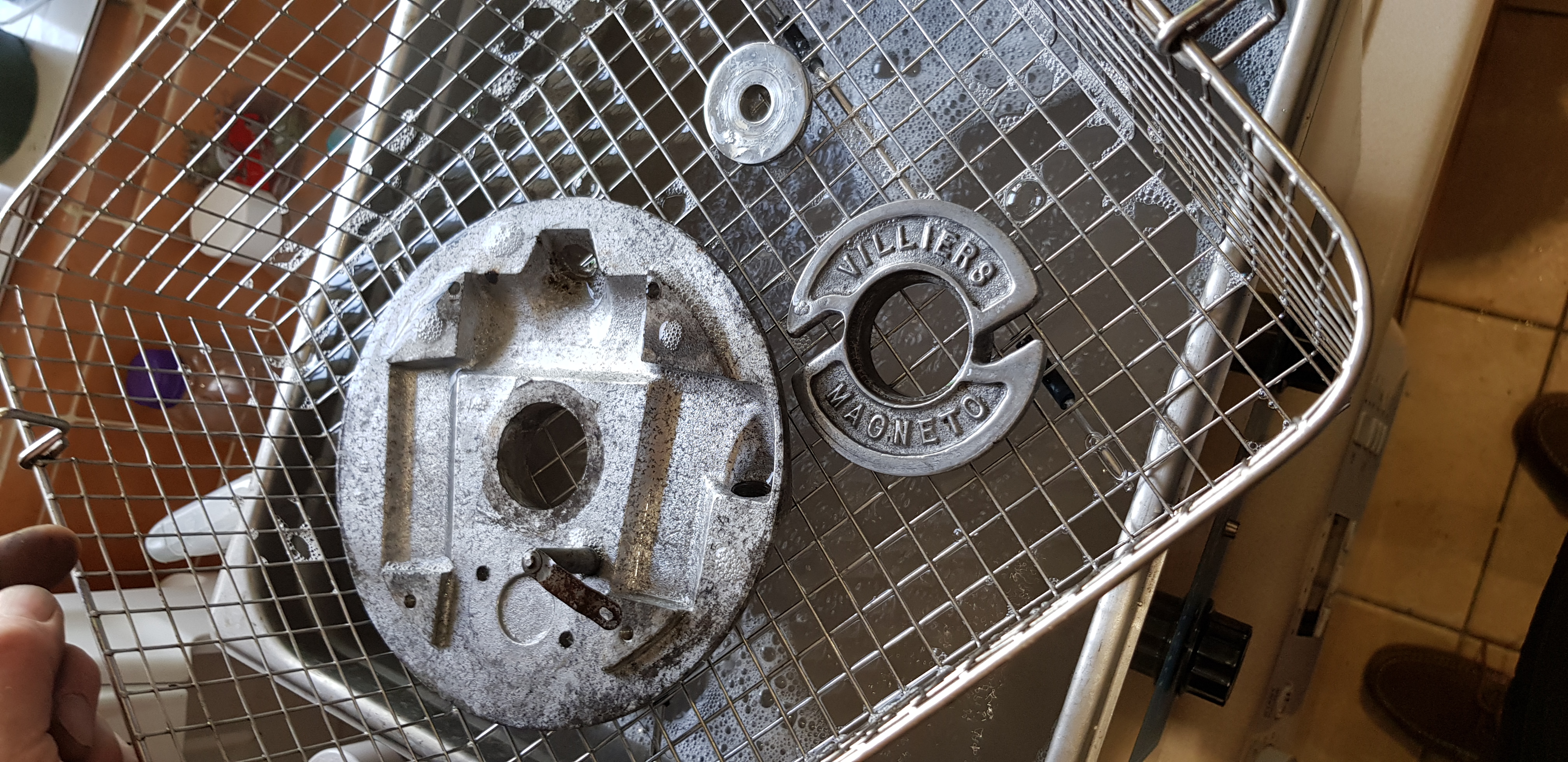

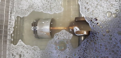

Re: Ultrasonic cleaners
Does soften up a lot of the crusted on oil.
