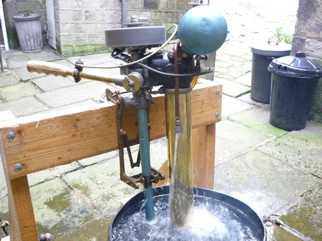

Gents, I used a file picture from SOS and Johns site, it shows what should be right? or is it wrong?
As my coolant exits in the exhaust pipe.

Re: Series 102 water cooling
The visible flow is really only a 'telltale' to let you see that water is flowing - as long as you see water and not steam assume all is well - I assume from your other emails you don't have a propellor fitted yet - when you do, and if your motor doesn't have a 'neutral' selector, running it in a barrel will virtually eliminate any flow due to the water roaring past the intake holes!

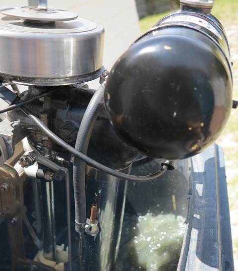

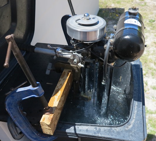

This image shows the motor running and when not in gear, I see no water comming from the chromed side outlet, the black rubber pipe was hot, so I assumed it was from hot water, was it from steam?
I have since blown the pipe out with an air line, I did think there was a small blockage but not much, its clear now.
The top fitting on the block has two holes, the fitting on the exhaust has three holes, all are clear.

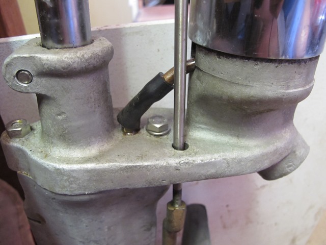

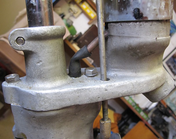

Can I assume that this is or should I say WAS the feed from the pump to the water cooling in the cylinder head?
Since fitting the rubber tube has collapsed, I think an air line will blow past the kink but the Seagulls water cooling pump will not?

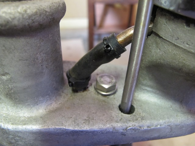

I have now repositioned the same rubber tube, it is new and in good condition, the copper pipe was also moved and towards the rubber tube.
Should hose clamps be fitted here, black cable ties may work ok and look neater?

Why not remove that connector tube & test to see if the pump is pumping, in your test tank with that pipe just above the water level.
If that pipe kinks or comes loose in use, rowing home with a seized engine in your local pond wouldn't be life threatening, but there are a lot of circumstances where it might be!
I've never had to use hose clamps there & never noticed anyone else doing so.
