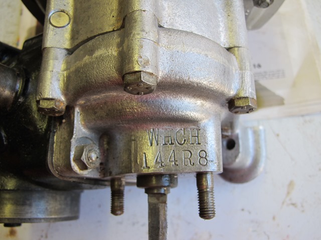

WHC is102 plus with clutch. Ie lower gear bigger prop. Wipac magneto.
Do you have photo of engine number please.

Engine number is clearly WHCH 144R8
The power head is very clean, looks like its had an easy life, I wonder why it is part seized?
I think I did ask John from SOS to track the number?

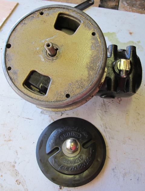

Your correct about the Wipac set, the top cover is the black plastic version, I have no idea if that was the original?
The top was painted Gold which I assume to be correct?

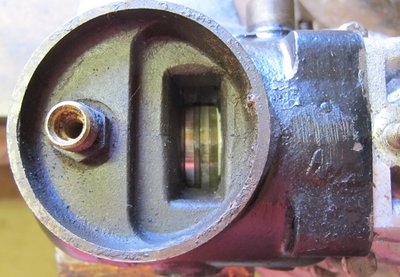

This 102 motor is still part seized, its quite free when the piston is down, then tightens up as the piston moves up and into the bore.
I have poured oil and 2 stroke into the crank case and also the upper piston area, the rings look clean.
Could the block be warped?
Re: Seized 102 power head
Bent crankshaft, cracked bore.

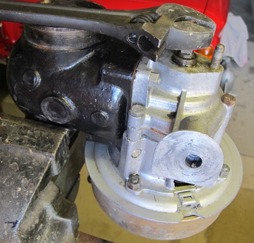

Looking at the block I see two bolt heads, how do I access the other two please?
Remove flywheel and magneto base and you will find the other 2 nut.african imp wrote:
Pull the piston out and clean the bore, I would have done this first, so that I did not damage the bore more.
