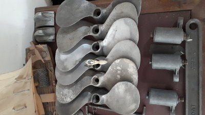

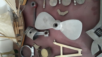

Posts: 3295
Re: Series 102 engine with a forty five blade prop
Yep. If straight out exhaust.
If the pointing down exhaust (subejector)
Wow. I just accessed this forum by phone and took photo and it came staight on. So much easier. Except they are sideways. Note take photo sideways.

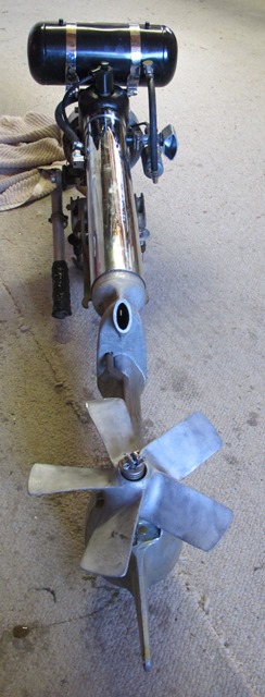

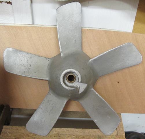

Guys, thanks on your replies and advice, I have just checked the five bladed prop and it is marked '100 only' not forty, my mistake.
The question remains will this five bladed prop be too small for the 102 motor?
Serial number TC 82813 circa 1962/63?
I have built this motor up from a steel trunk load of odds and sods that were gifted to me when an outboard motor shop changed hands, the 102 motor as seen in the picture did not exist, the parts did but it is a very much mix and match type assembly.
It runs well now and has a new owner, I have a second 102 option, a part seized power head and a selection of power legs, I will require another prop should it get re assembled?

So you have a 4:1 gearbox - I think this qualifies as a 'Barge pusher' (Hugz?? [good info on the props by the way]) which would be yet another prop! With that ratio, just slap the prop you have on and see how it goes.
A bit difficult to see from the photo, but it looks as though there is a large distance between the water pump housing and the prop spindle , which would also suggest the barge pusher prop, which was a big (13"dia.) four bladed cloverleaf affair.

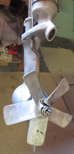

My five blade prop looks like this.

I do have a larger prop but it fouls the gear box casing.
It measures 11.25 inches.
