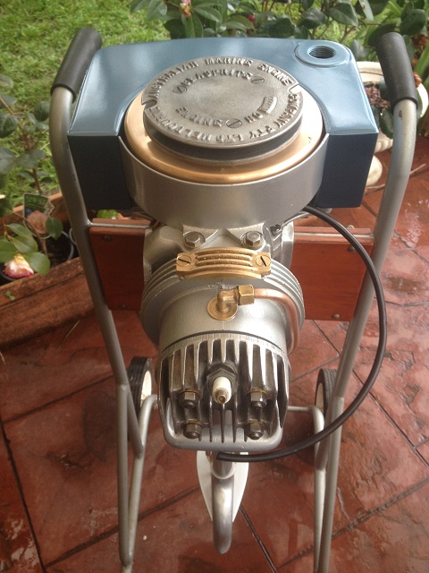

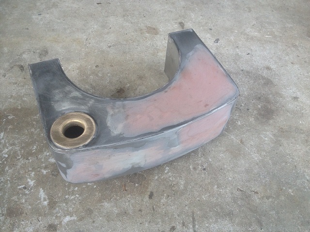

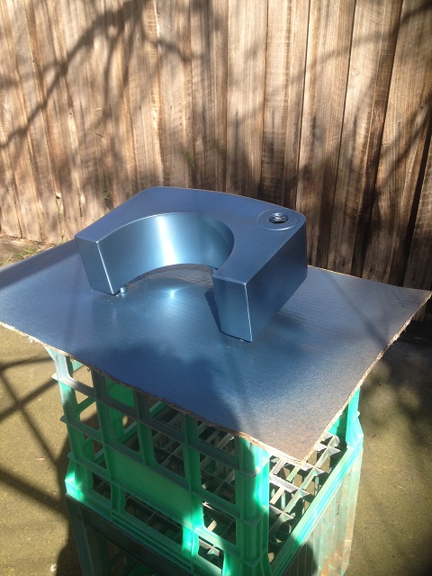

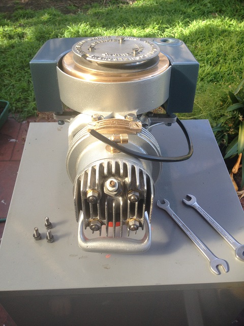

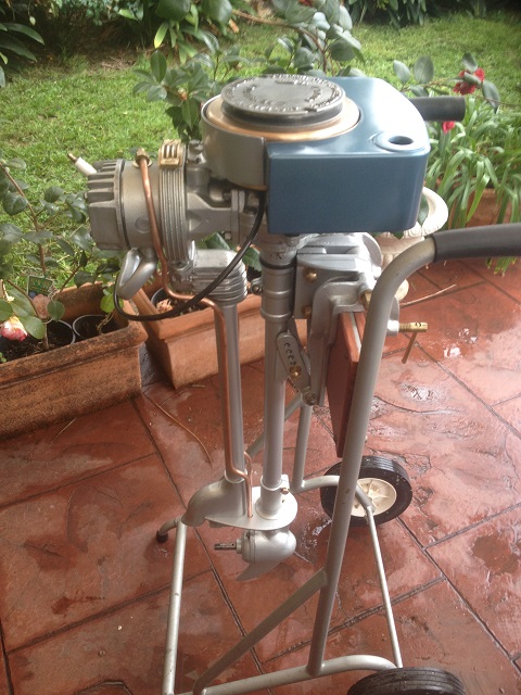

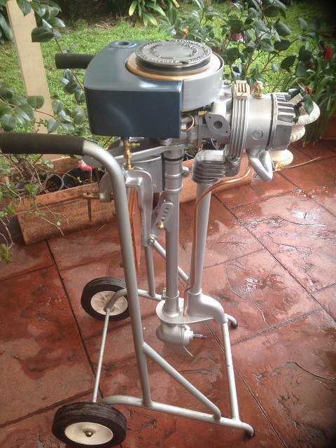

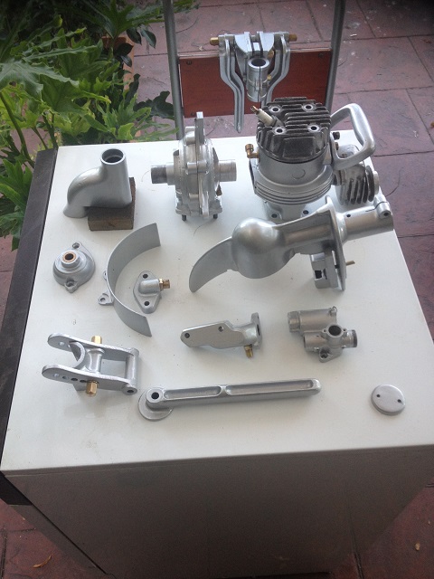

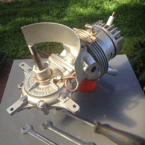

Just sharing some pics of a recent resto. This one is an AMECO (Australian Marine Engine Company) Seasprite, manufactured in Melbourne between 1947 and 1950.

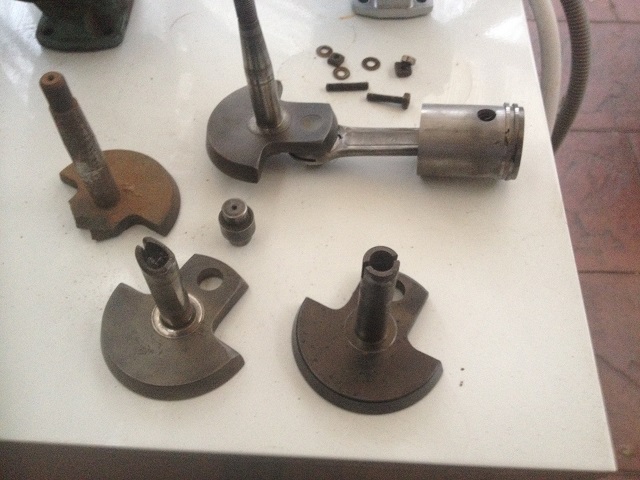

The restoration was fairly straight forward. The crank presented the biggest challenge along the way as the original was broken. I found another which was also broken, but provided the parts needed to make one crank from the two.
Hope you enjoy the pics.

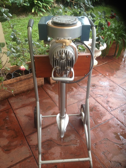

Part 3
Yet to fit carburetter, under-tank throttle, tiller and prop. Also need to replace the points before I can time it correctly.

Beautiful job. What an interesting outboard. I love seeing all of the Europe and Australia specific outboards. They are certainly not something we ever get to see in North America.

Yes very nice outboard!
How did you go about putting the crank back together?
Re: Australian AMECO Seasprite Outboard
Was a pain in the backside to be honest with you. Some prior aligning using standard tools eg vernier etc, followed by numerous assemble (in crank) rotate, disassemble, tweak, reassemble, rotate etc etc etc. Finally got it to rotate nicely, but I wouldn't want to do it again.Nudge wrote:Yes very nice outboard!

I think your brave tackling that job.
Hows the big end pin held in location? Interference or Weld?
Difficult to tell from your pictures.
I was thinking that it looks like a pressed in big end pin. Interesting job to get the crank true after pressing in.
As Oyster so correctly stated “the big end pin is held in the crank web by an interference fit”.
In a Seagull 3 piece crankshaft as fitted to post 89 Qubs (Curlew, Osprey, Kingfisher & 5R’s) which look like they have a shorter stroke than your Seasprite, the interference fit is generated by a hard big end pin that is 0.1mm bigger than the hole it gets pressed into.
On a forged EN40B Seagull crankshaft this requires a considerable amount of pressure, and as the pin is so hard, causes the hole to get bigger & slightly misshapen as it stretches easier in the areas with a thinner wall thickness, leaving a hole shaped a bit like a Wankel rotor.
To rebuild a 3 piece Seagull crankshaft it is then necessary to have the holes ground round again & a new oversize pin made that gives the correct interference fit.
Removing & replacing the same pin several times can stretch the hole & reduce the crank webs grip every time you do it, this is more of a problem with bronze main bearings rather than ball races & might be good enough for a 2 minute showing off run in your water butt, but might be very different for a sunny afternoon on the Yarra or the Gippsland lakes.
When I was an apprentice a mate of mine used to race a 50cc road racer that revved to 16,000 RPM. He used to have to replace the big end every 2 race meetings. He used to bring it in to us in the tool room and we would freeze the pin and warm the crank and press in the new pin. Oversized pins were available and the crank could be reamed out, but the crank only lasted one race season. Then it would have to be checked for alignment and runout between centres.
