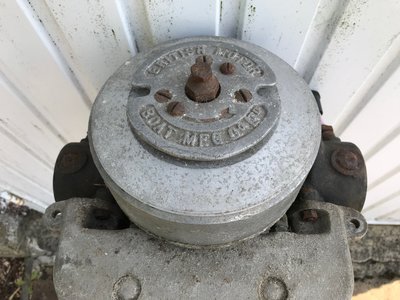

I believe it to be a MK 1, based on the carburettor top (referenced from the user manual)
The carburettor leaked badly. Subsequent investigation revealed a stripped thread in the bottom of the carb body. 5/8 UNEF apparently (0.625 x 24tpi)
I have a lathe, so I intend to insert a newly threaded sleeve into the carb body. I sourced a 5/8 UNEF tap from Ebay.

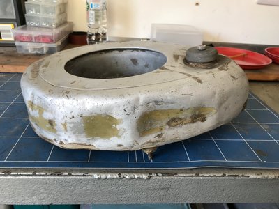

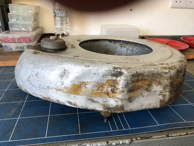

The fuel tank is badly dented and probably leaks.
I had the engine running briefly before consigning it to the projects awaiting shelf.
Any comments would be welcomed. Any guess as to age? Any suggestions for restoring the tank?

Nice motor ! I have a few motors here with bashed tanks , I've often wondered if you could get them back in reasonable shape by sealing the filler cap and applying pressure with compressed air via the tap fitting . Has anyone tried it ?
cheers
FenTiger
Posts: 4
Joined: Wed Aug 29, 2018 4:37 pm
Location: Lancashire
Re: New to the board and I have a BMB Swordfish
Post by FenTiger »
Thanks for the info.
I’m dubious as to whether the compressed air idea would work satisfactorily. Surely if the pressure is high enough to deform the material, the deformation would be general rather than selective with the dents.
It is done with a water blaster.... Look it up on youtube!
